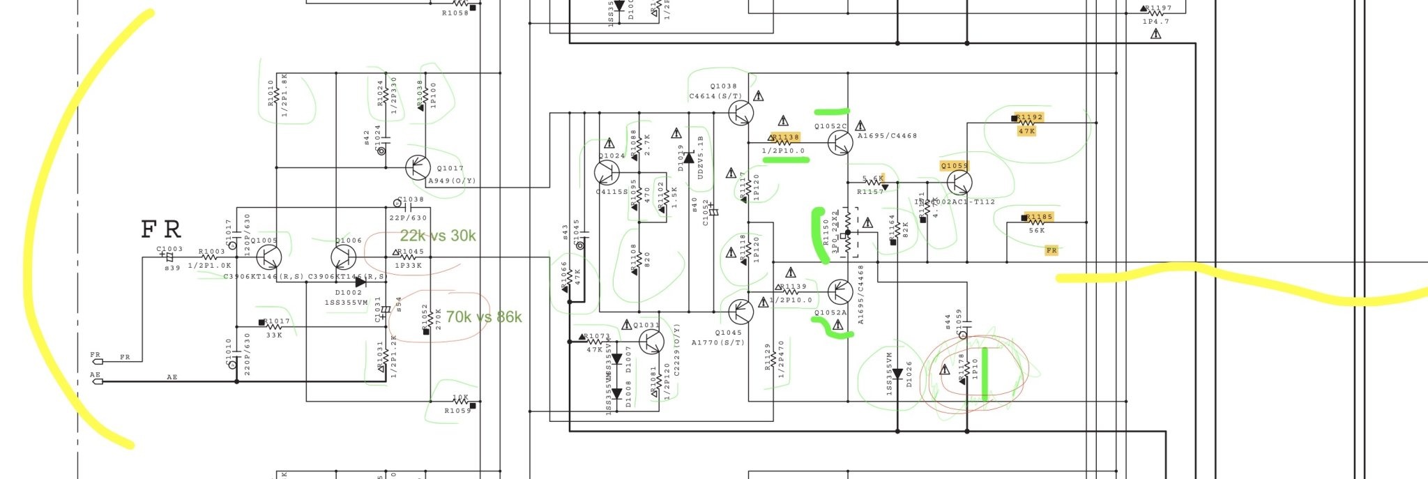

I first tried to measure the resistance, but my multimeter show 20 M ohm which is huge compared to the 33 k ohm in the schema. Could the measurement be wrong and including many other elements around R1045 ? When I compare with R1044 (other front channel), multimeter shows something closer around 30 k ohm as expected.

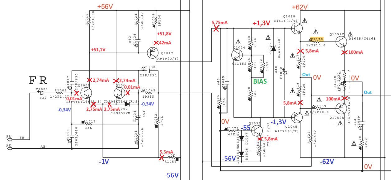

I measure 6.8V now across R1045 measured across C1038 since they are mounted in parallel.
Should I cut out R1045 to be sure of the measurement ?

The only thing I would add in clarification is that the base voltages at Q1005 and Q1006 will be negative by a few tenths of a volt due the bias currents flowing in R1017 and R1045. Ideally, they would have equal voltage drops, leading to 0V at amp output; there's likely to be some output offset error.

I managed to get the mainboard off the case and measured more or less everything I could !
The 2 only bad measurement I have are in the center/left part around R1045/R1052 ! I had some 33k/1W resistors, so I tried to replace R1045 ! Bad luck, the resistor shows a correct 33kOhm measurement when measured alone off the mainboard.
Stil replaced It anyway with another brand new (and verified) 33k resistor, but same problem when measuring resistor "in place", slow growing and stabilizing around 22k when the working channel equivalent resistor stabilizes around 33k. Could be related to the missing transistors at the end ?
R1052 is surface mounted ! It makes it more challenging to remove and measure (should be ok) and put back in place !
Any other suggestions ? Capacitors (I don't have adequate equipment to measure them) ?

I’d like to discover why output is stuck near -5V. Would you report voltages re ground at:
Output at R1150 or equivalent
Base of Q1006
Base of Q1005
Voltage across R1038
Voltage across R1081
Voltage between base of Q1033 and cathode of D1008
Voltage at cathode of D1008 re ground.

To keep you informed ! I ended changing C1031 and now the amplifier starts with no more voltage measured on speakers output !
Yay... but... the sound is pretty bad, like saturated sound but all time.... Tried with different sources, different speakers, same...
Well... maybe something else is broken somewhere else 🙁
