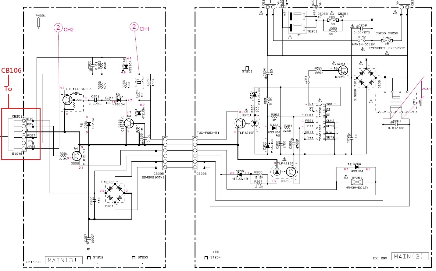

I've been given this Yammmy to repair, there are no relay clicks or display lights when I press the power button. There is however S10v,5MV, /RES (Reset) 4.7v. PDET (power detect) is 0.110mv and PRY (power relay) is around 100mv. That's the only power there is except for 7 or 8vac on the small transformer. Any help is appreciated.
The S10 is the 10V standby voltage for the amp, if it is low the amp will not operate.
Please disconnect the CB106 cable in the amp board first and check again the S10 voltage in the M3 small board to see if we can get 10V output.

I finally got it off, the small board measures nothing on the S10v. That board is easy to get out, I've had it out a few times to check everything and replace a 2.2uf 50v electro capacitor that I thought just maybe a bit low?

Yes, I disconnected the cable to the power amp board. I've found that D261, S1NB20 the small bridge diode has two blown diodes. So I hope that's all that is wrong with it?

I had measured the Diode bridge wrong, I don't think there is anything wrong with it because it reads the same as the other small diode bridge on the board it's connected to? D259, S1NB60 next to the Mosfet Q254. Then I looked at IC251 and IC253 I don't get any diode reading from either one in circuit?
S10 pin resistance from the main power board is 410.5 ohms that cycles down to 0 ohms then back again to 410.5 ohms and repeats.
Why this reading?
I don't know? I'm using a Fluke 87V Multimeter. What should the reading be?Why this reading?
I put it back together and measured 17.77 vac across the small transformer secondary, the little bridge diode is not putting out any voltage. IC251 and IC253 are not showing any diode voltage with a diode test? I'll wait for the little diode bridges to get here and see how it goes then? Thanks for your help, Patrick. It's appreciated.
