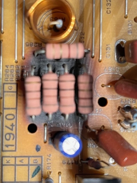

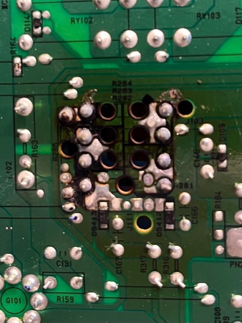

All recent Yamaha devices (Stereo, AV, amplifier, receiver) come with a build in protection function, which shutsdown or prevents the unit from starting in case a serious problem (like incorrect voltages in the power supply, high DC current on the output, high temperature, ...) is detected. The Yamaha service manual describes it in detail. In general, it is possible to enter a diagnostic mode or bypass the protection by pressing certain keys (e.g. "Bass+"+"Preset<"+"Power") while powering up the unit. The R-N303D occasionally reported a "PS1 PRT: 135L" error (actual value "135" may differ a little bit each time), which means the PS1 test voltage was too low (135 = 1.75V, expected range is 152-187 = 1,97V-2.42V). The PS1 test voltage is a combination of multiple power supply voltages via a resistor network, the resulting value is passed to an 8 Bit A/D converter (0-255 = 0-3.3V) on a microcontroller. If the value is out of range the unit shutsdown. Of course, there can be many reasons for an incorrect value. Amway in my case the solution was simple. I first verified the PS1 voltage is indeed too low. I verified that the main DC voltage after the main rectifier, which is part of the PS1 voltage, was correct, but then I noticed that all other voltages failed. All these other different voltages are generated from a pretty complex circuit; however this entire circuit gets its input voltage from a resistor series R281-R285 (8,2 Ohm, 2 Watt each). According to the Service manual there seemed to be a modification in the past here ("New Parts" footnote). On my device it looks like if these resistors had already been repaired in the past (perhaps with the modified new parts?) but one of the solder points of one resistor was bad causing temporary failure. After fixing the solder point the device started up reliable. I also noticed that these 5 resistors can get pretty warm (~80C), so these resistors are loaded quite heavily and perhaps may fail.
