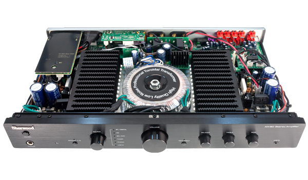

Been looking for a proper stereo amp (within budget) what do you think about this...
Sherwood AX-50 Integrated Amplifier
50 Watts x 2 @ 8Ω, 20Hz~20kHz 0.07% THD.
It's a small-ish amp although it has a toroidal transformer, some big caps and huge heat sink and weighs 6.5kg! (almost as much as the big Yamaha AVR - & costs $100 more than the AVR).

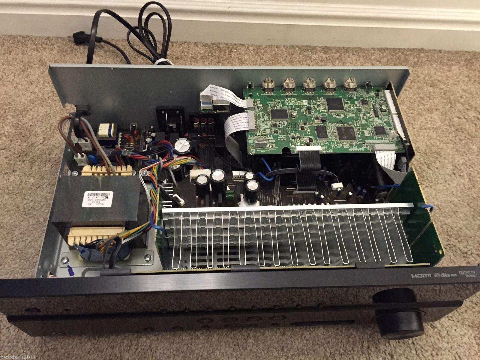

How can you compare the power rating of this to the Yamaha AVR which has 70Wx2 (2ch driven) 20Hz-20kHz, 8 Ohm, 0.09% THD. Is this still better even though it has lower power? What other factors should you look for when comparing raw power output other than thd, freq range and ohms. Does things like the size of the heat sink and the transformer type a better hint to look for in power/sound quality?
And just for comparison 🙂 I've also attached a photo of the Yamaha AVR internal - it has the smaller heatsink, standard transformer and the 2 caps...

Another important factor while looking at amps is this: what speakers will you be driving with that amp?
Simply put that Sherwood would leave the Yamaha for dead 🙂
Power supply is crucial to the performance of any amp the main factor being it's ability to supply and have current in reserve for big dynamic peaks .
Sherwood is one of those brands that tend to go ' under the radar ' , here in the UK at least , but people that have them are generally happy and they get very positive
feedback/reviews .
As the previous poster asked though , what are your speakers ?
Worth mentioning ... Sherwood was originally an American brand now owned and made by Inkel in South Korea.
feedback/reviews .
