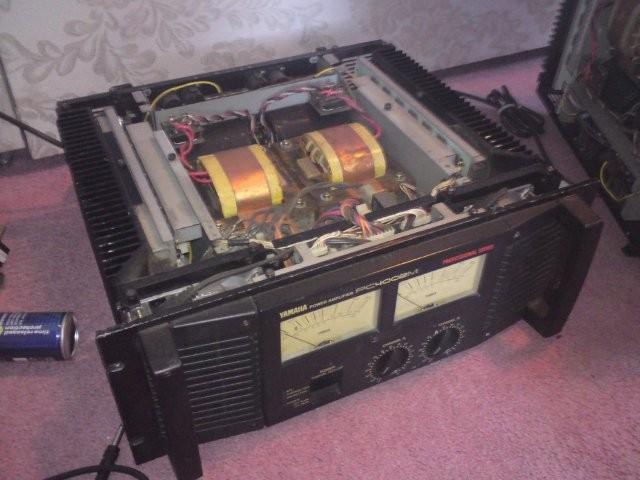

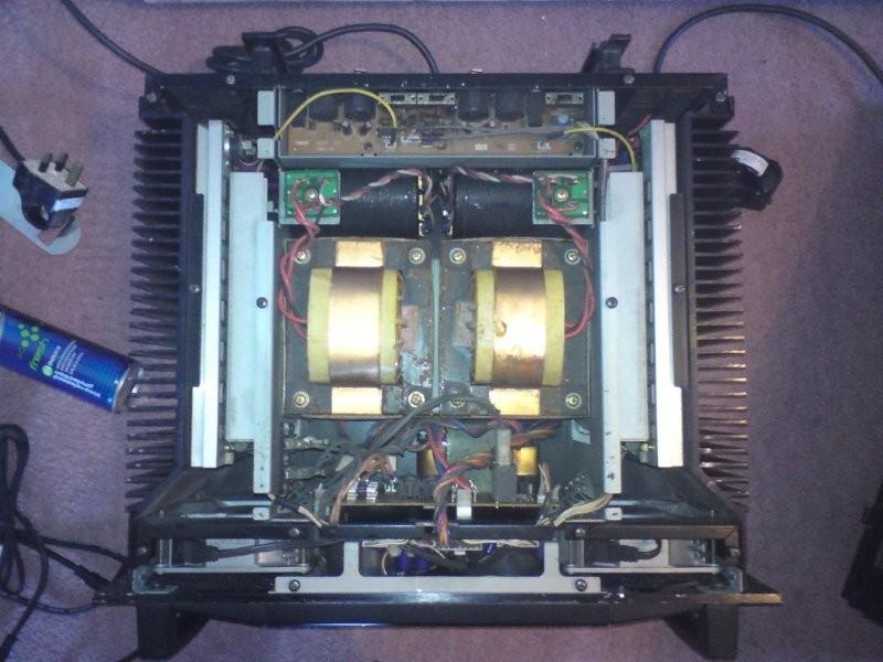

Hi all,
I have a pair of Yamaha PC4002M amplifiers, theyre pretty chunky things and I think the same era as the MX1000 commercial amplifiers (which come up in a few threads here) so I thought some pictures of the guts might be of interest to some people.
I also have a problem, the VU meter on the right channel of one amp seems to be stuck at around 0.1 watts when the amplifier is on or off, repeated flicking of the meter will align it almost to zero again.
The odd thing is when the power exceeds this 0.1 watts the meter jumps into life and works perfectly. Any suggestions on fixing these things?

Thanks for the replies.
It could be a bad joint, although when the unit is off the meter remains stuck and will eventually settle back don to zero again with enough flicks on the glass. So im thinking its a mechanical issue, i have no idea how servicable these things are though.
I dont know how complicated the meter driving circuit is but if it is an electronics fault i hope its not too involving.

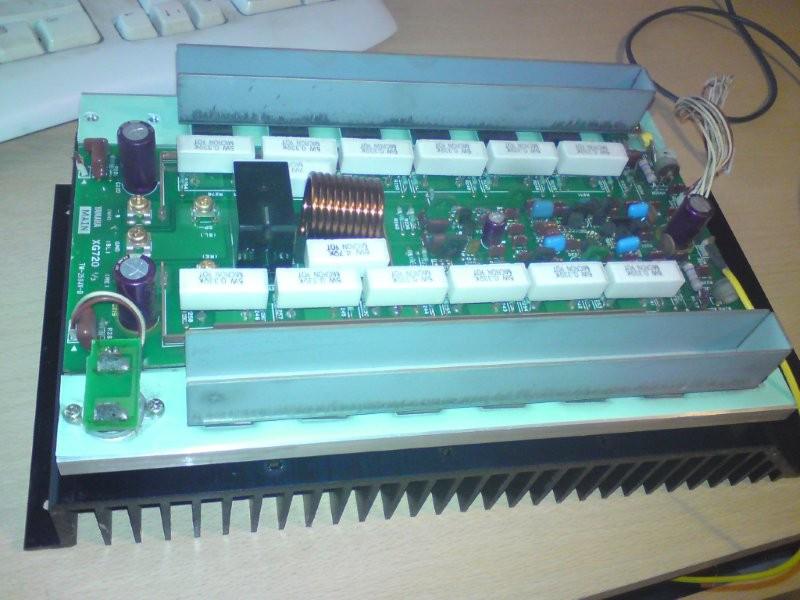

Some more pics, ive just pulled the amp modules out of the chassis for cleaning and am impressed by the quality of the PCB's.
They seem to have copper bus bars running around them! I guess its some kind of shielding / special grounding scheme, either way its a sign of quality!
If anyone has the service manual for these id love to have it.
Capacitance seems low with only 18000uFx2 per amp (so 4 caps in total as its completely Dual mono).
Specs are:
430W ito 8R
700W into 4R
1.4KW bridged into 8R
THD 20hz-20khz < 0.05%
IMD 20hz - 20khz less than 0.01%
slew rate +/- 60v/us stereo, +/- 100 mono
response = 10hz - 50khz +/- 1dB

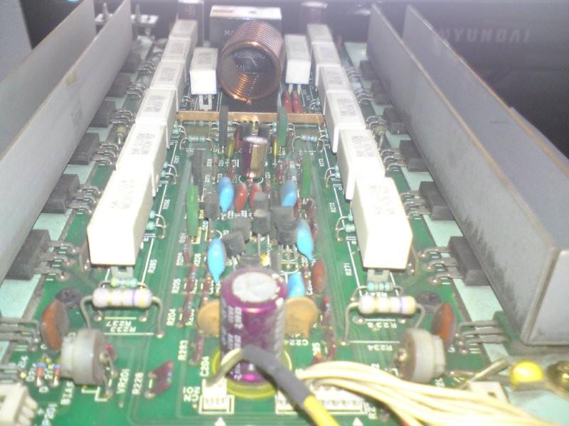

I see it all with that last shot, a very typical topology.
those tall to-126 trannies in middle (VAS) , a very well compensated input (lots of poly caps) the two small
to-220 drivers (on heatsink) and those dual rails (20A short
term currents) Those meters sticking could be mechanical.
nice amp...
OS
