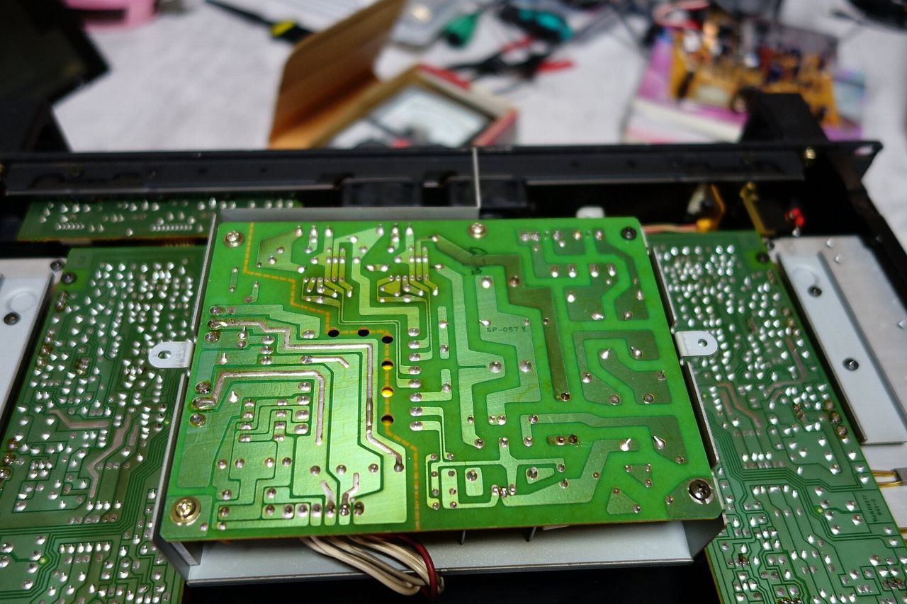

Noise catastrophe. Re-soldering (desoldering and re-soldering with minimal solder) would help a lot.
A parts swap could still make a little.
But since this is a complex complementary parts push-pull story, it will always appear dirty and noisy)-;
Reactions: robo_klaus

I would recommend PA-940:
But here too: Keep the transformers away from people. (If I had three stereo power amplifiers, I would build a separate power supply unit and feed it to the three amplifier housings via plug connections.)
These amplifiers are so simple and on the one hand easy to repair and also have an excellent sound, also suitable for home hi-fi - compared to highly complex complementary transistor push-pull amplifiers. Better than Le Monstre or Classe A, Hiraga, as example.
I would install a little more capacity, larger electrolytic capacitors, at the beginning.
For your tasks, however, do not replace the power transistors with TO-220 types (I recommend it). But I would also look at TO-3P or TO-247. These "Sanken" in TO-200 are among the worst sounding.
The PA-940 are also a great basis for changing the sound enormously simply by replacing components.
