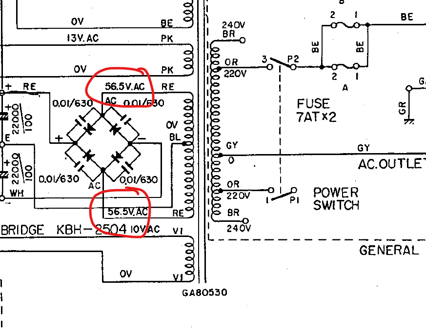

I would begin by measuring the AC voltage here which is shown as 13 volts (measured between these points)

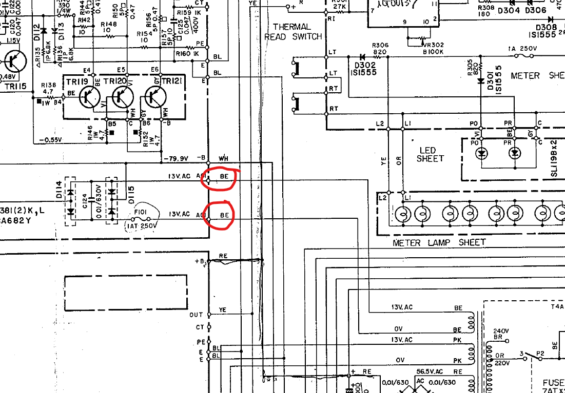

And these voltages of around 56 volts AC are measured from ground.

If you are not confident on working on anything like this then the advice has to be DON'T 🙂 and get help from someone who knows how to do this. There are highish voltage inside and it would be easy to cause damage to the amp and to you.

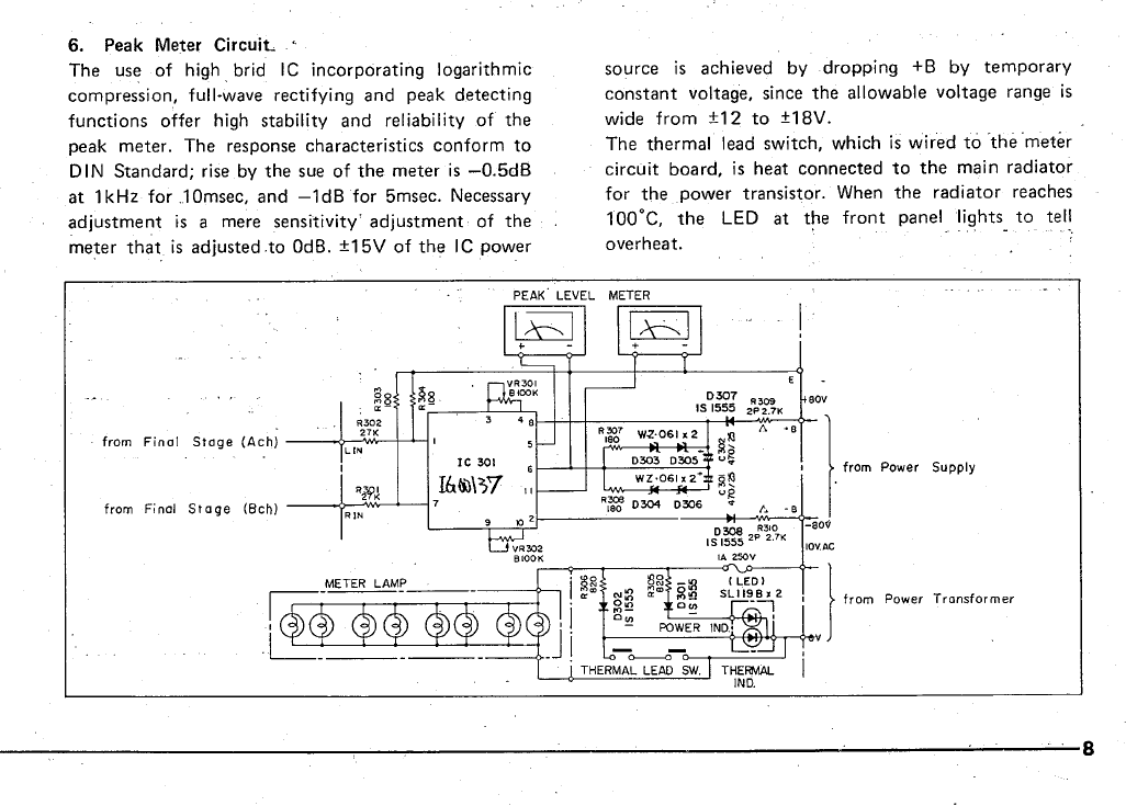

I do not imagine it's the case here, but moving coil meters are prone to sticking at the end of scales, especially as they get old. The bearings can wear over time, and if a meter is 'pegged' it will stay there. It is plausible that an amp might have spent its life in a club, with the meters pegging for hours every night, damaging the movement over time and making it prone to sticking when pegged. But I think it's unlikely that both meters would have the issue. Meters often jump when something is turned on due to offsets stabilising, but it would be bad design for them to 'peg' and I would not expect it from a serious OEM such as Yamaha. These are respected amps. My feeling is that there is a DC offset feeding the meters for some reason (I haven't seen the driver circuit, but I'm guessing it's a peak meter, which is a lot more complex than a simple rectifier arrangement used on VU meters). Meters can hit the end stops with only a couple of hundred mV, so a slight offset can completely render them useless. They can also be damaged when pegging. Do be careful.
