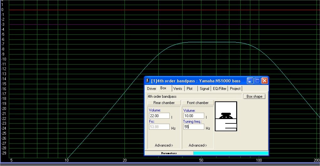

Certainly, though without my original calculations i can only make a seriously educated guess as to certain things 😉Very interesting!
I've been thinking about making some surround speakers to go with the NS-2000. I planned to make them small though, with puny woofers. Any more data on those NS-1000 derivates?
The enclosure itself is a 4th order bandpass for the bass. The original 12" Yamaha driver is inside, as the whole enclosure is 36mm thick MDF (2 x 18mm sheet) the bass driver is sitting at about a 45 degree angle. The sealed portion of the box is approximately 18L, braced & filled with teased out rockwool, this gives a sealed box bass resonance of about 55Hz (would need a 22L box if using no stuffing). The front ported chamber is 10L in volume & has some acoustic foam for a little damping, it's tuned to 55Hz. The overall response is about -3db at 29Hz & 110Hz.
The bass driver is directly driven from one channel of a stereo poweramp with an active filter driving it, rolloff is -3db lowpass @ 110hz. The 7" Audax bassmidrange is connected to the bass output of the original Yamaha crossover (it's located in the stand). Took me an age to find a quality driver that'd work properly on the xover at the right sensitivity & with the correct impedance etc.
Obviously the other mid & tweeter are fed from the Yam xover.
There is a panel on the rear of the enclosure to facilitate fitting & removal of the bass driver, i had to remove the metal grill on the bass drivers so i could get the driver to fit. It's all pretty tight in there to be honest as the total enclosure volume is less than the original NS1000M 😀
The port (100mm) has an 18mm flare at each end to lower port noise (never heard any myself & i'm known to crank things as the evening progresses 😉)
Overall enclosure dimensions are 64cm H, 32.5cm W, 43.5cm D
Just ran that lot through WinISD, i was surprisingly accurate with my memory 😀 Not only that, i was pretty accurate with my maths as i didn't have WinISD when i designed it lol.
