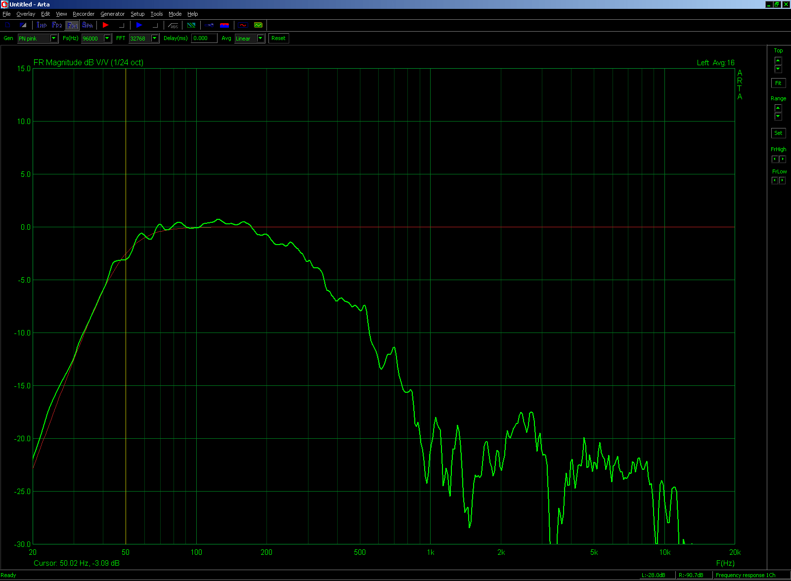

I think that 'classic' -3dB @ 50Hz benchmark may actually relate to one of the old "DIN" reference standards (?)For some reason nearly ever Japanese "large" speaker (and a lot of non-Japanese too) I measured had the same 50 Hz@-3 dB extension. Even the larger ones like Sony SS-G7, Diatone DS-5000 or Fisher STE-1200, which are definitely out of "big bookshelf" category. Maybe some weird national sound preference, or maybe all the designers/manufacturers had an unspoken agreement, or they thought it will integrate better in a small room. Have a hard time imagining DS-5000 in a 12 tatami apartmant, though.

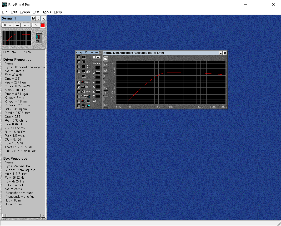

In general, I agree: 12" in a sizeable box should (and can) provide lower bass cut-off, it's definitely doable to get 35-40 Hz without compromising sensitivity. However, for given TS
