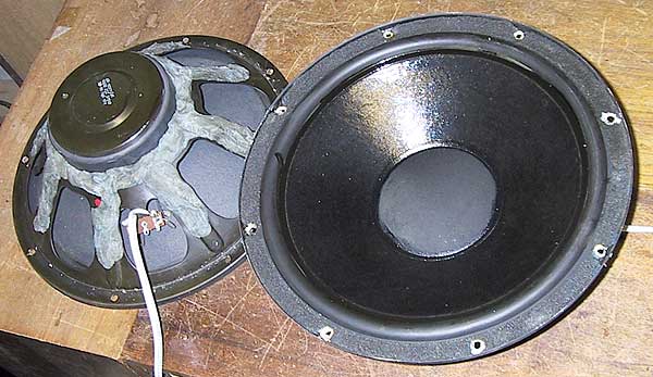

GregGC said:
[Tell me more about that, please. I'm not sure how to do that.

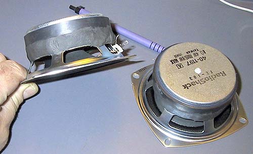

Ductseal should be available at any HVAC supplu house -- there are substitutes, but i haven't found anything quite as suitable.
Here is a pic of an RS 40-1197 -- some should be added to the basket legs too (but the 1197 doesn't have much in the way of basket legs.
dave

planet10 said:
A couple things sreten missed:
0/ ductseal the speaker baskets -- if you could only do one mod this is it
11/ better wire
12/ brace the big panels -- you have to do this in a manner that doesn't eat up too much volume.
dave
Hi p10,
0 - never occurred to me, my speakers will soon becoming
apart, again.... does DS harden or remain flexible ?
11 - true, but then your into crossover layout etc also.
12 - very difficult to do through the bass unit cutout for these
speakers, and there is no other access, though I agree two or
three horizontal battens subtlety placed would help.
******s up using wall damping easily though........
🙂 sreten.

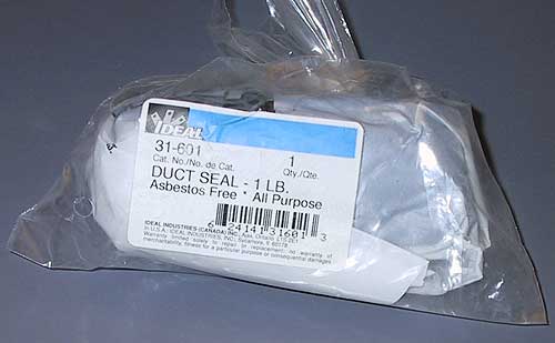

catapult said:
I think Duct Seal is a Canadian product. Any suggestions for the US? It looks like about the same kind of self sticking, non hardening stuff as Mortite which comes in convenient "rope caulk" rolls and is available in most hardware stores in the US.
I'll have to dig out a pack, but IIRC it had both US & Canadain addressed on it.
faustian bargin found an on-line source for it:
http://www.diyaudio.com/forums/showthread.php?s=&threadid=23468&highlight=
Mortite & rope caulk are similar to duct seal -- i've used rope caulk but don't like it as well -- it is more convienient for making gaskets thou.
