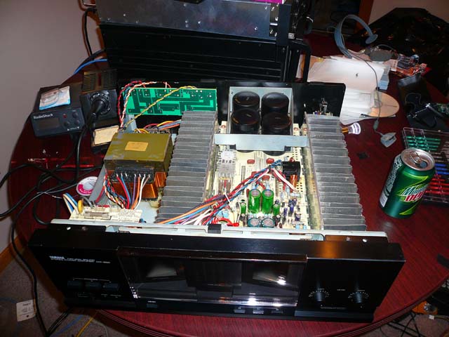

Here is the mx 800
When I got this amp a week ago it was filthy inside I spent about 5 hours cleaning the inside polishing all the contacts. From what ive read this amp is just as good and clean and powerful as the m80. I just hope I can do the led conversion without messing it up.

Once you pull apart the meter assembly you will be could install
a single diode and extra resistor and LED to convert to LED instead
of lamp. . .if LEDs had been cheaper than lamps when it was first
made, then they would have used LEDs.
The amp should be capable of low impedance loads. . .four caps. . .
the M-45 has only two. . .but same mounting bracket; the M-45 has
the same heat sink brackets that alow narrow main boards in the
M-45 and the wider board for the M-85s.

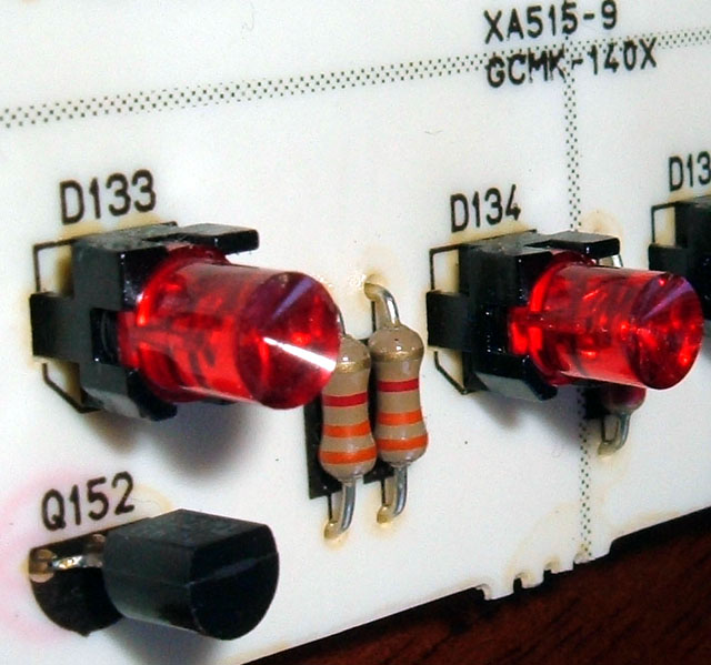

Yamaha M-45/65/85 Meters
