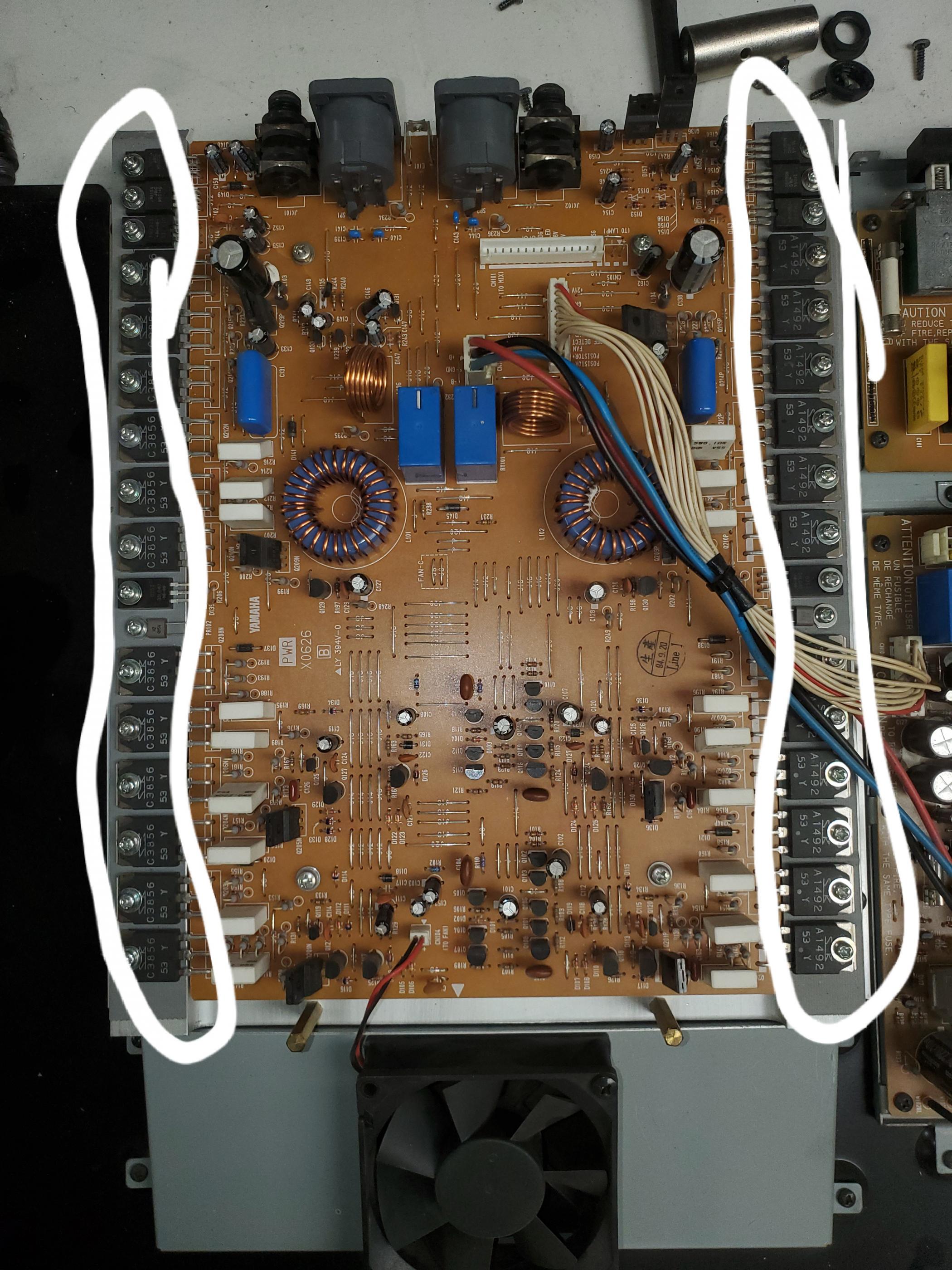

Ok...lol. Well, I think I found the problem. May have been slightly more obvious to the novices, but I appreciate the help all the same, as it got me really looking around for something a little harder to see. I wish I had a replacement jack to pop in and see if it all comes back to life, but I will get ahold of one, and go from there.
Just one more quick question for anyone still reading: In that second pic, the one of the whole circuit board, do i need to remove ALL of the phillips head screws around the edge in order to flip it over and resolder the jack.? Just wanted to make sure there isnt a less invasive way to do it before i get started. Again, thanks for all the help fellas.

I don't understand from the picture what You figured what was the cause.
The jack above has two wires and is correct. Pair 1- & 1+. The other under has 4 because it outputs both channels pairs 1 & 2. Look at the back of the unit. Jacks seem Ok. Just make sure the contacts don't touch each other. Even if they are loose and You re-solder them You still have the problem with the VU's. So the problem lies before the amps.
Probably Yes.
