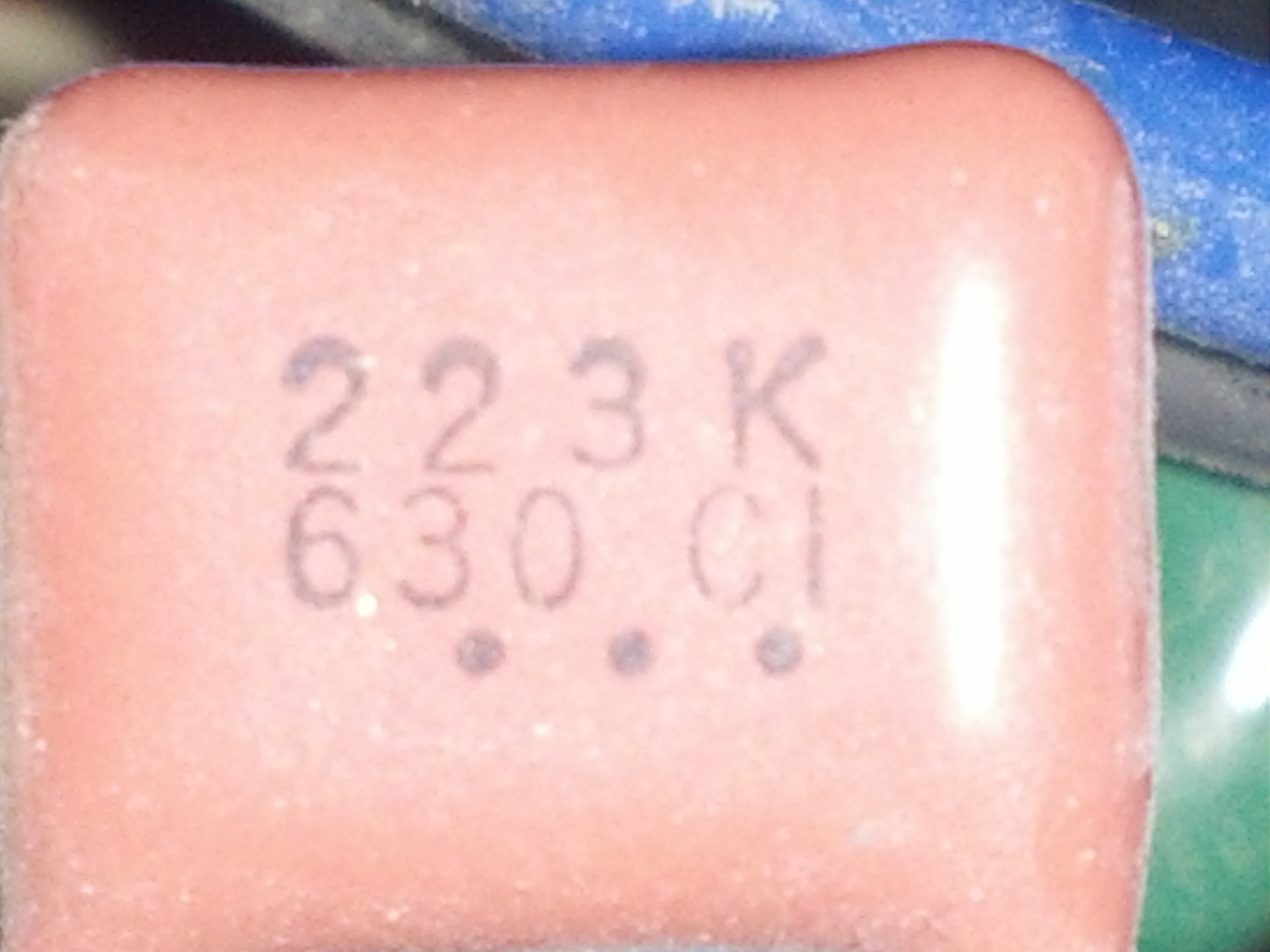

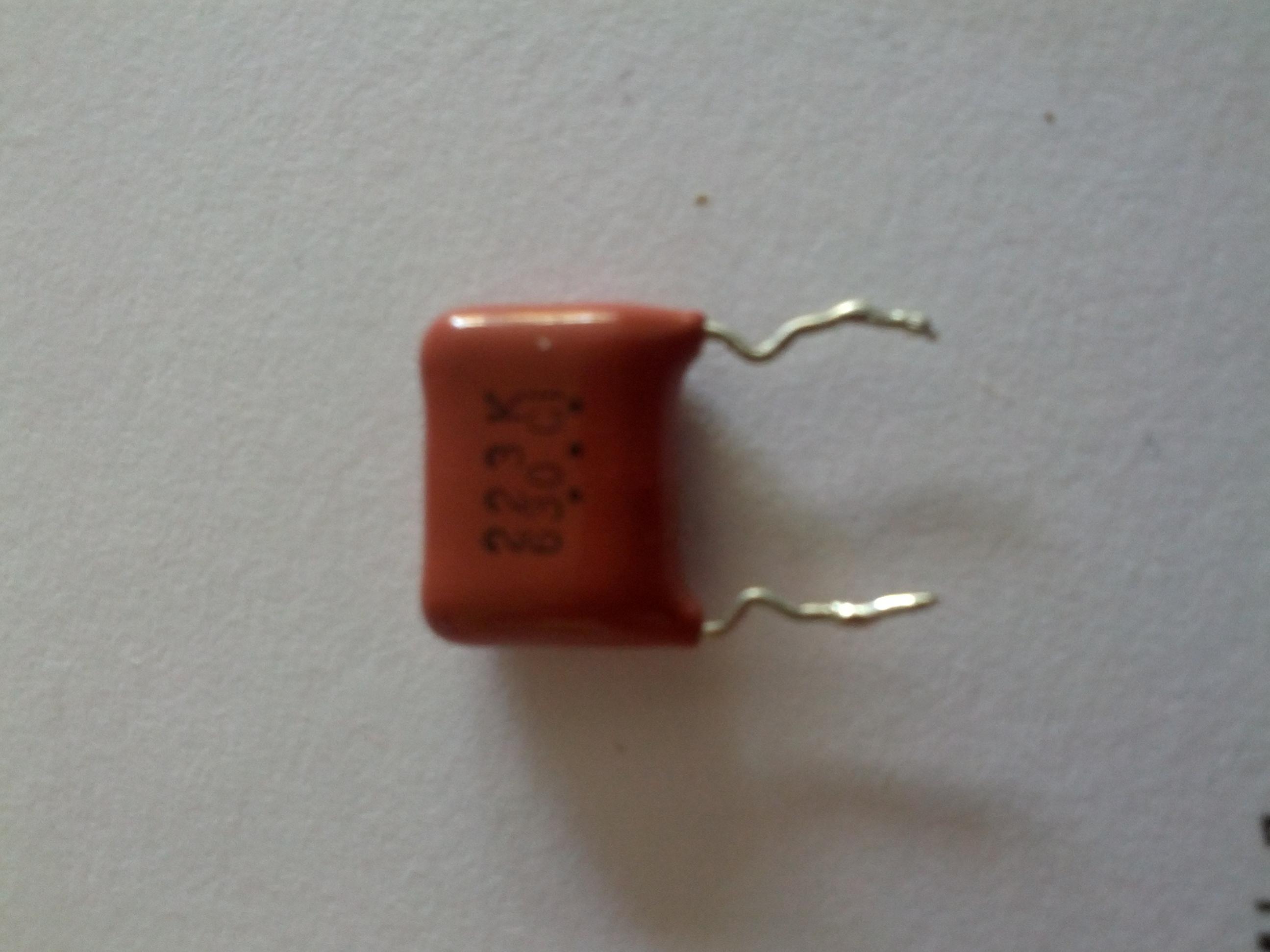

Im not really sure if the original was X2 rated or not.
I have attached a couple of pics for reference.

Your's doesn't seem to be, so wether or not you'd like to go for that extra bit of safety is up to you.

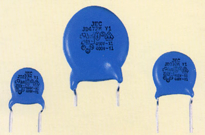

X- and Y-rated caps should be clearly marked as such and will probably carry approval body's stamps (such as UL, VDE, etc.).
Below are images of safety caps, and it's clearly visible that the blue ones are Y1-rated and the gray one is X2-rated.

Whatever the choice taken by the manufacturer and the rules require as a minimum, I would use the X2 rated part regardless when mains is about, if it fits the board without difficulty or lead stress. That way, you cover all bases.
