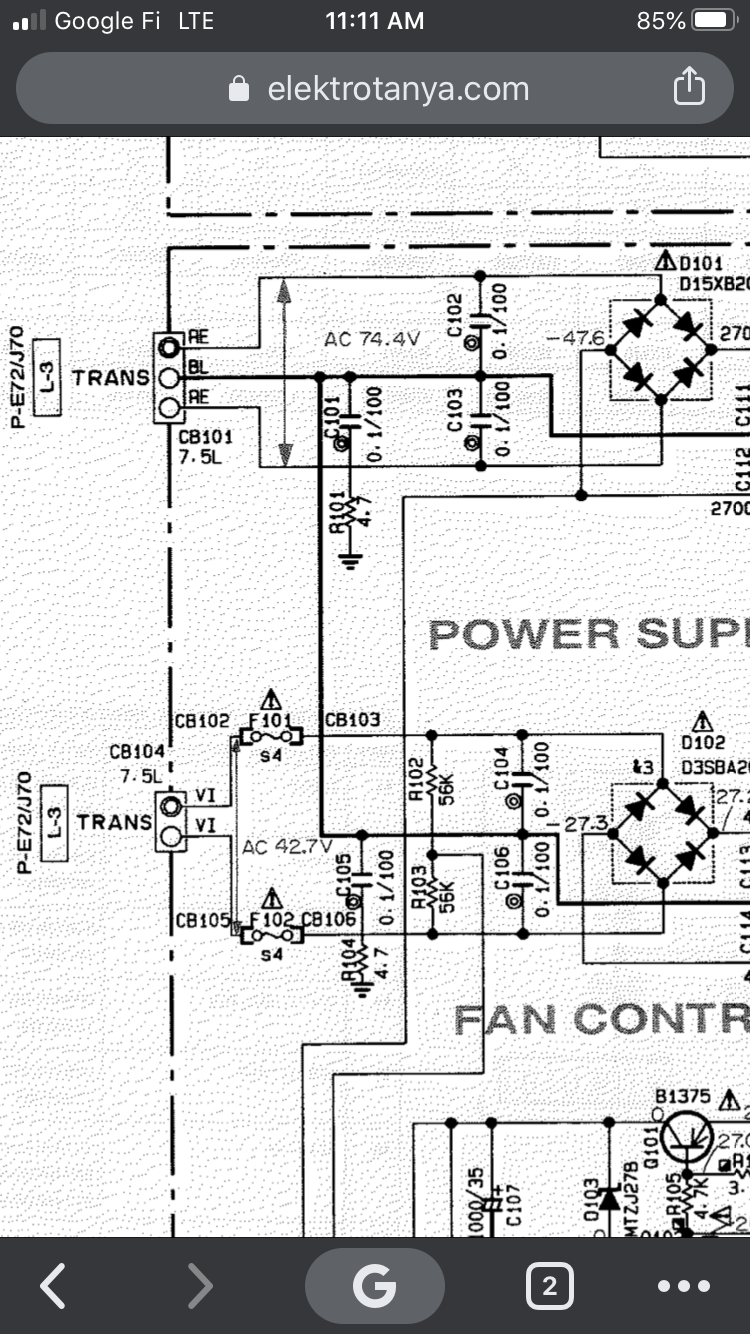

Yamaha DSP-A1 Transformer Specs?
Looks like the transformer outputs are 74.4 VAC and 42.7VAC. Main rails are 47.7 and -47.6V
