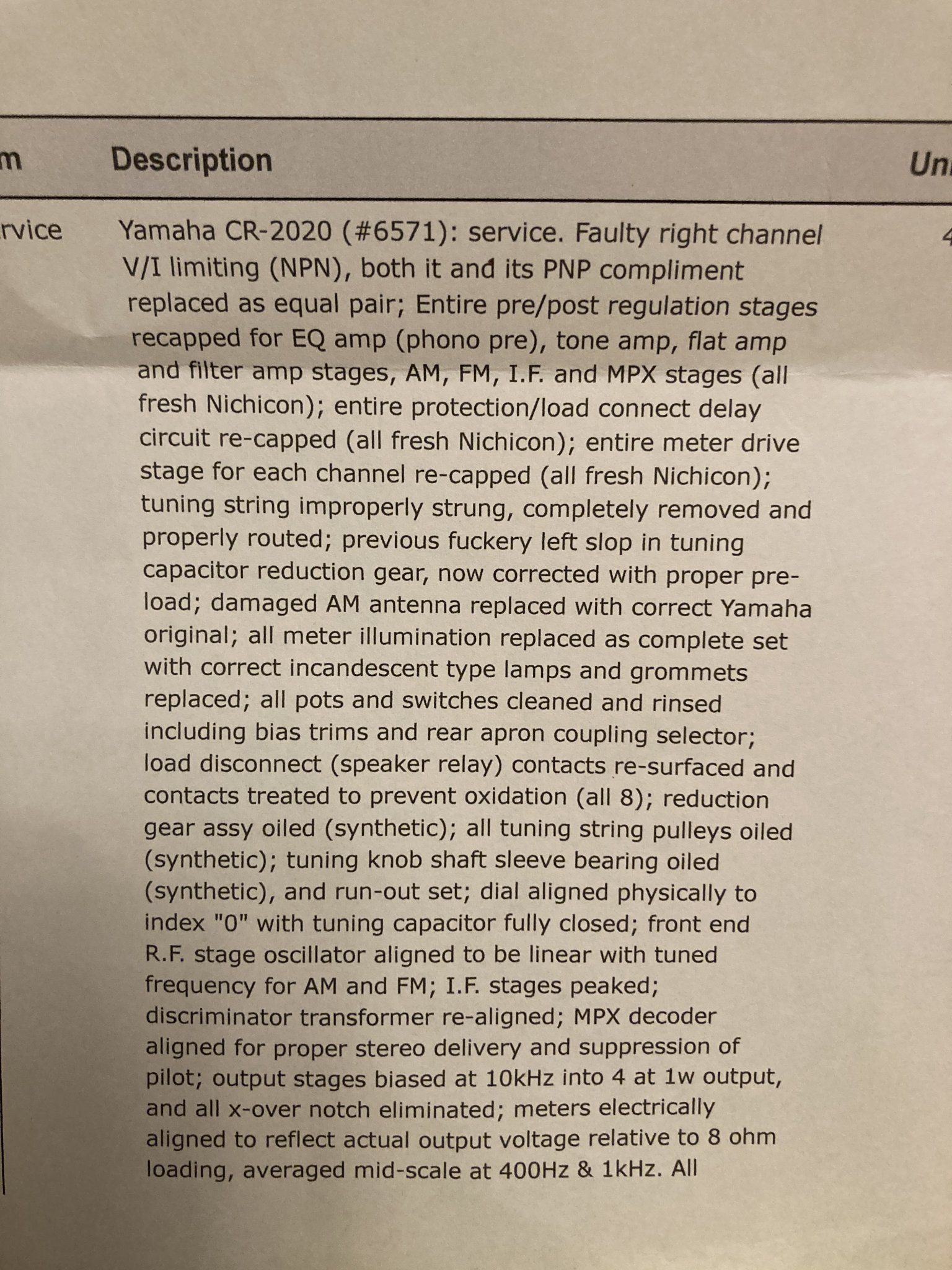

That is what I was thinking. The new unit had work on it about 18 months ago but not to the power supply board.
