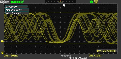

RF is not perferct but I compared the RF signal of the faulty yamaha cdx-1100 with working yamaha cdx-1110 and it looks the same.

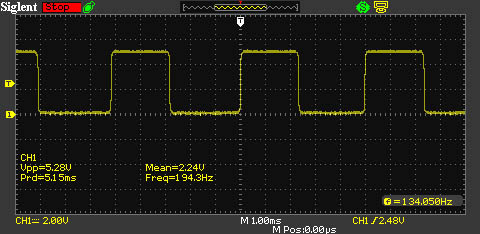

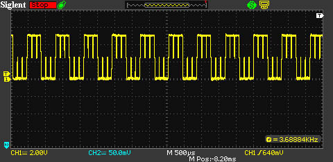

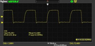

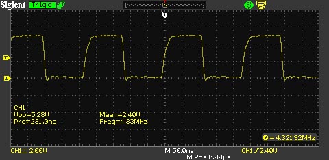

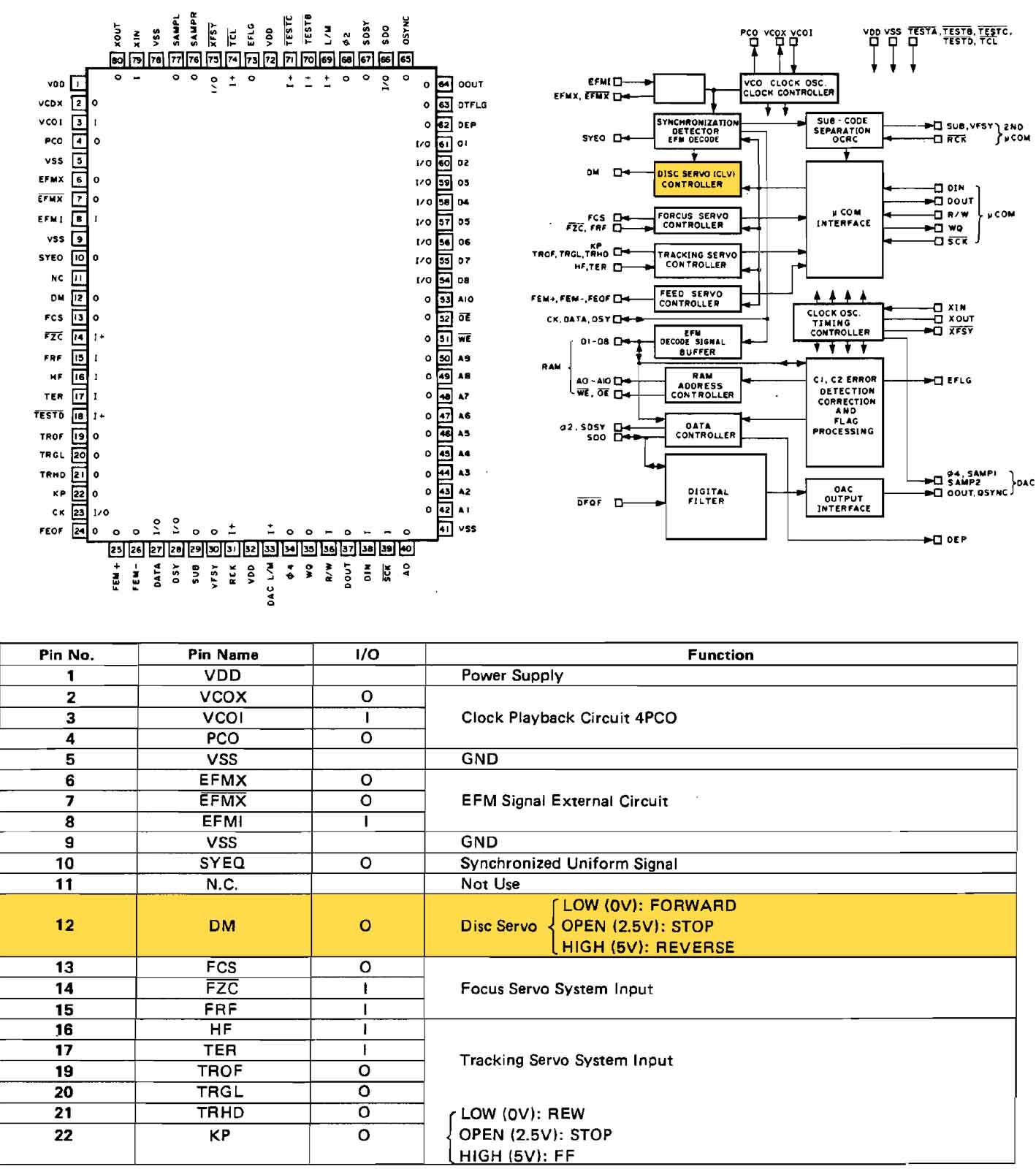

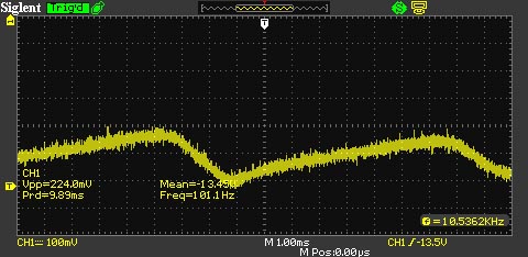

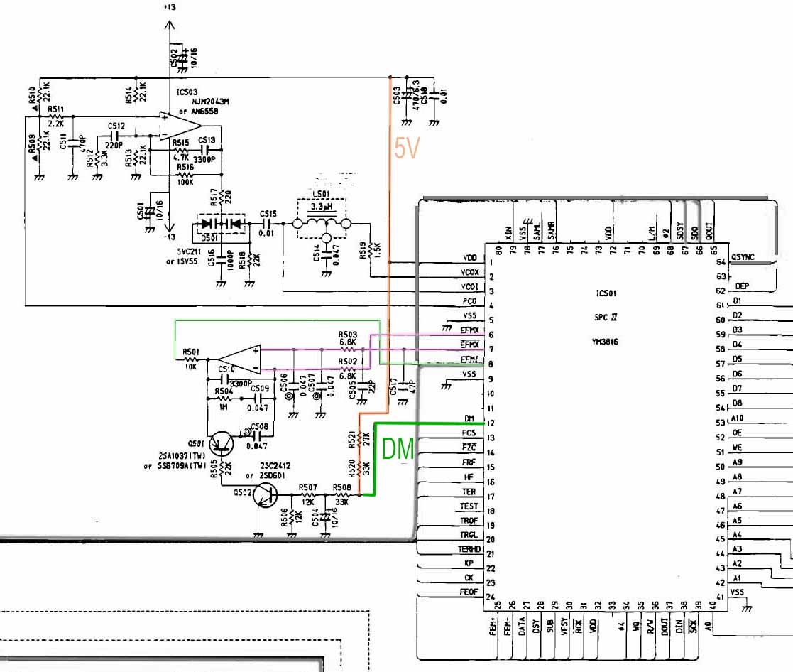

I start to wonder if the problem is not related to cd-player not being able to lock to system clock. I discovered that when I touch the varactor diode SVC211 (D501) - I believe it's part of the VCO circuit - with oscilloscope probe, exactly the same time spindle motor brakes and stops.
DM signal changes immediately and it look like this:
I marked with yellow where I touch the diode with probe if that is of any help.
I was also under impression from the start that the issue was related to clock signal.

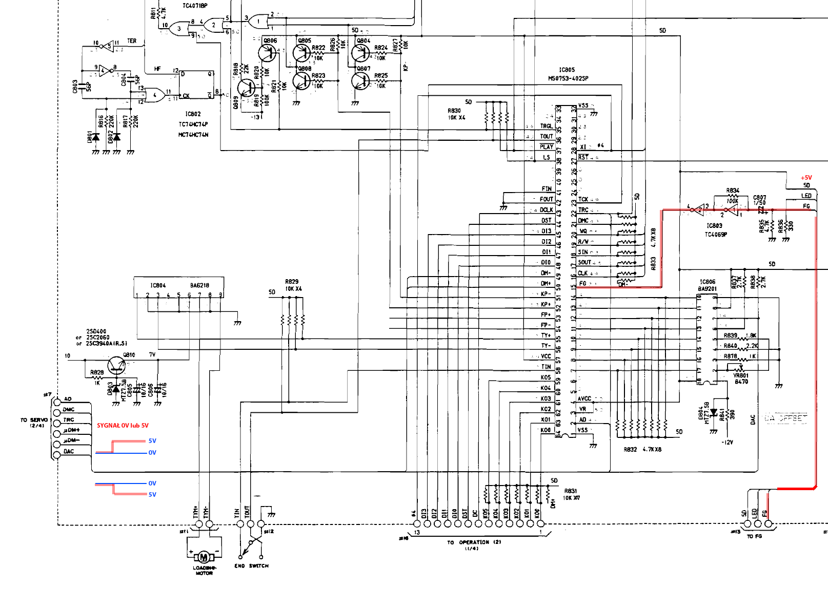

Touching the yellow point with the probe is not a proper test, especially if the multiplier was set to X1. That part of circuitry will be very sensitive to any loading.
I’d look at signals at R522 and R523 while the CD player is working, and then observe what happens when in stop / play/ disk loading / laser obtaining valid focus, track change / ff and frev.

My intension to probe yellow point wasn't clock signal observation. It was rather curiosity and I wanted to understand the circuit better. There is dedicated point on digital pcb to observe clock signal that I've used.
However there is no lock confirmation signal as far as I know. I will try with R522 and R523.

I agree that it still can be a motor problem. It is controlled by two signals and the problem starts always when switching from one to another.
After swichitng to DM signal motor should spin up and then slow down to lock on clock.

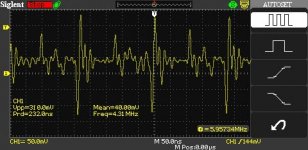

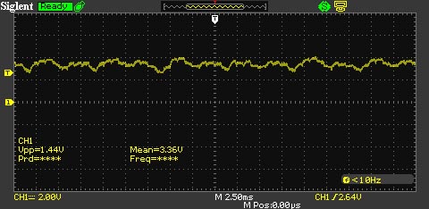

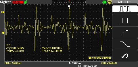

There is also one strange thing with 5v line. I can observe noise (small peaks) of 4.32MHz (clock) frequency.

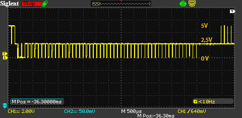

I did measurements on R522 and R523
After pressing 'play'
When changing track (going up or down)
(I moved channels aside to be easier to see)
Yellow idle = 5V, Play = 0V
Blue idle = 5V, drops to 0V when changing tracks, search etc
When spindle motor brakes yellow signal stays 5V and blue signal doesn't drop.
During search
Pause
Zoom in to signal on R523
How to interpret these readings?
Ok, so you are not pressing any commands, signals at R522 and R523 look stable -> and then the spindle motor stops spinning (and starts to spin in opposite direction?)
If above is correct, then:
1. Wash the motor, or try to get a new motor. They are quite cheap and easy to obtain.
2. If motor still behaves erratically, confirm that signals don’t change on IC501, pins 1 through 12 when the motor stops to spin correctly during play.
If all signals stay stable on pins 1 – 12, when the motor starts to behave erratically, then the whole section we are talking about at the moment is okay.

I was not accurate. Yellow signal goes high 5V after pressing and drops down to 0V when cd-player lock on track successfully.

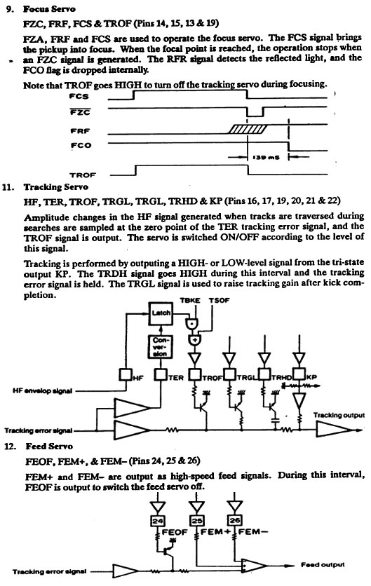

I have just checked the service manual very quickly, and figured out two things:
1. The motor part details are listed on mechanism parts page, part number is: vc406400. This is how I managed to find the original part
2. The mechanism requires adjustments - see the beginning of the user manual.
I can e-mail you the manual if you don't have it.

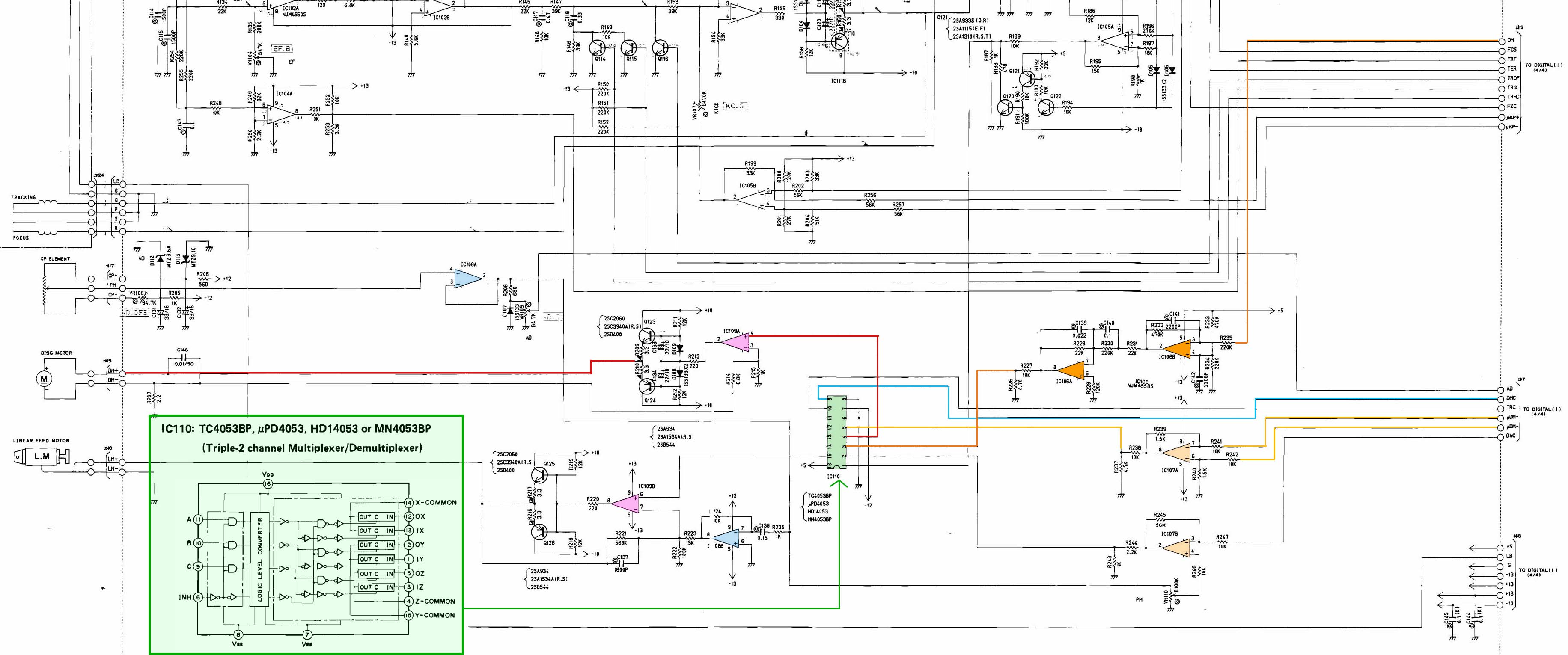

I had a problem with Focus Gain and Tracking Gain adjustment as this needs double channel ACVM. I tried with double channel oscilloscope and multimeter but how can I measure the ratings?
Focus Gain
E(TE) - E[Q] = 15dB
Reference E[Q] = 30mV, E[TE]=131mV
Tracking Gain
E[FO] - E[R] = 10dB
Reference E[FO] = 160mV, E[R]=50mV
