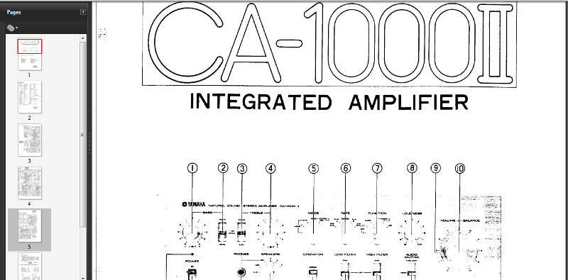

Still need it?
I have parts of it but I miss the power supply board schema.
Is it that one?
Regards zeoN_Rider
Thanks,
I have already found the CA-800 service manual. It is for the most like the CA-1000, just that the output is beefier (it uses 2SC1079 in output) and the CA1000 also has that very nice MC board - - - you might be able to plug in a I/V output of a current output (PCM58 . . ??).
The power supply board is the same.
