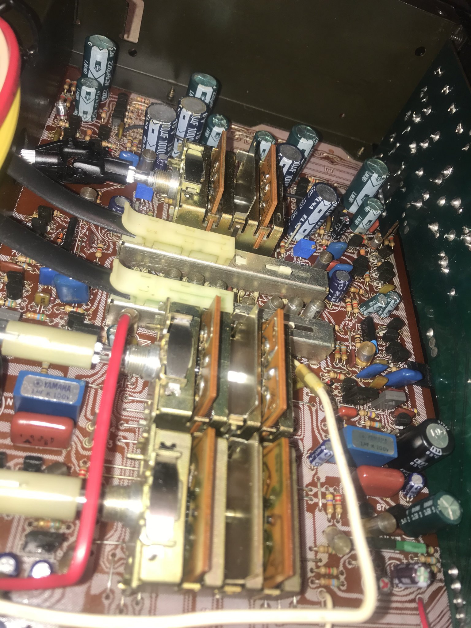

One thing, a fair bit of audio bleed through from Aux to Tuner. But not from Aux to Phono.
Any suggestions?

Double check the +/-30V supplies.
Switches are problematic in vintage, you could try gently rocking each switch
in turn and note any affect (good or bad) on the bleed. For the push button
switches apply light pressure without switching. Then for all switches, fully
switch a few times again note any effect. Switch may need deep cleaning, ie,
disassembly then clean.
