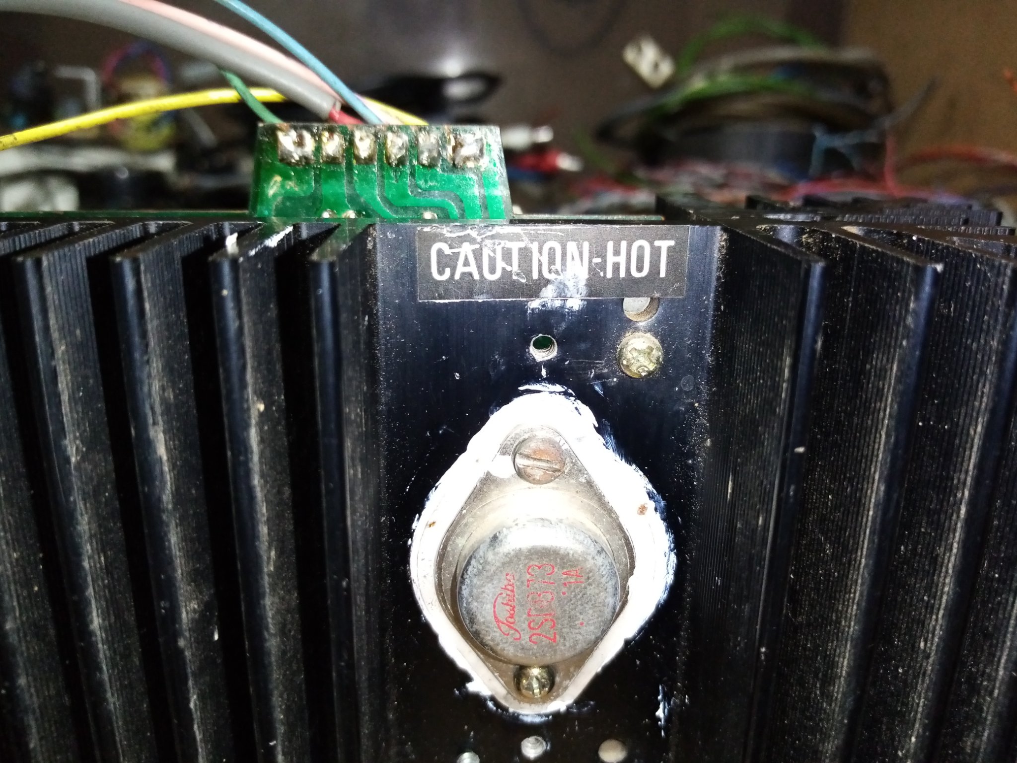

Today I used the amp with the 2x 1N4148 version: stone cold, voltage pin1 to pin6 is 108V, pin1 to pin5 is 50.1V, idle current at 5 mV and rising. I plugged a bass guitar right into it. It sounded distorted, with any setting on the waveform trimmer.
Then I put in again the 3x 1N4148 "varistor" (boiling hot, voltage pin1 to pin6 is 89.4V, pin1 to pin5 is 42.6V, idle current 200mA. This time my bass sounds about right, kind of mellow, really interesting.
So I have to figure out the right configuration for the varistor. Or I could modify resistor 820K and 470K trimmer to get the center voltage right, and/or the 470R resistor and 470R trimmer (both in parallel) to get the correct idle voltage.
I could also put 2 mega extraction fans at the heatsink but the ones I have on hand are quite noisy...

3x 1N4248 version: Vbe of TR309 (TIP31A) measures 0.52V, for TR303 its 0.572V and TR304 its 0.605V
2x 1N4148: for TR309 it is 0.582V, TR303 its 0.624V and TR304 its 0.527V

Well, offset voltage between base of TR303 and TR304 with 2x 1N4148 version is 40V, 3x 1N4148 version it is 24V.
These 1N4148 diodes are attached directly to the heatsink by a metal clamp. The stock STV-3H diode was screwed to the sink.
I use a small piece of heat resistant hose to isolate the exposed solder joints between each diode.
I also installed a switch to easily select between the 2 diode and 3 diode version. I'm not sure if this has any influence on the diodes behavior...

2 diode varistor: Speaker offset voltage is around 0.028mV, base to base offset on TR303 and TR304 is about 44.1V, slowly decreasing.
3 diode varistor: Speaker offset voltage is around 0.005mV, base to base offset on TR303 and TR304 is about 24V, also slowly decreasing.
The heatsink gets hot really fast with 3 diode varistor, and I have to put is component side up in order to touch the base leads with the probes and not make a short ...
