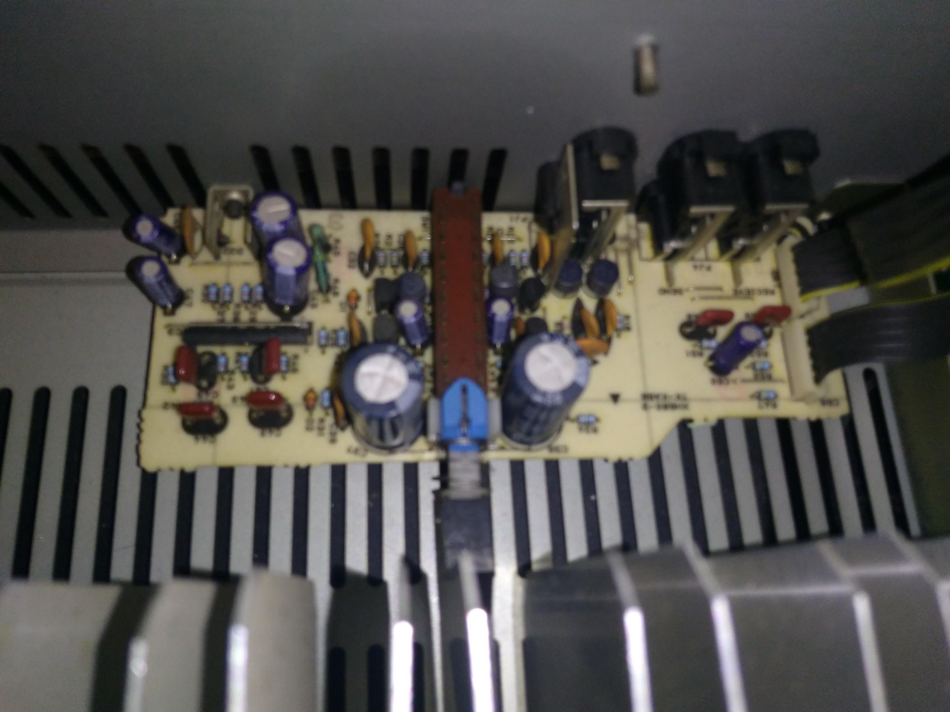

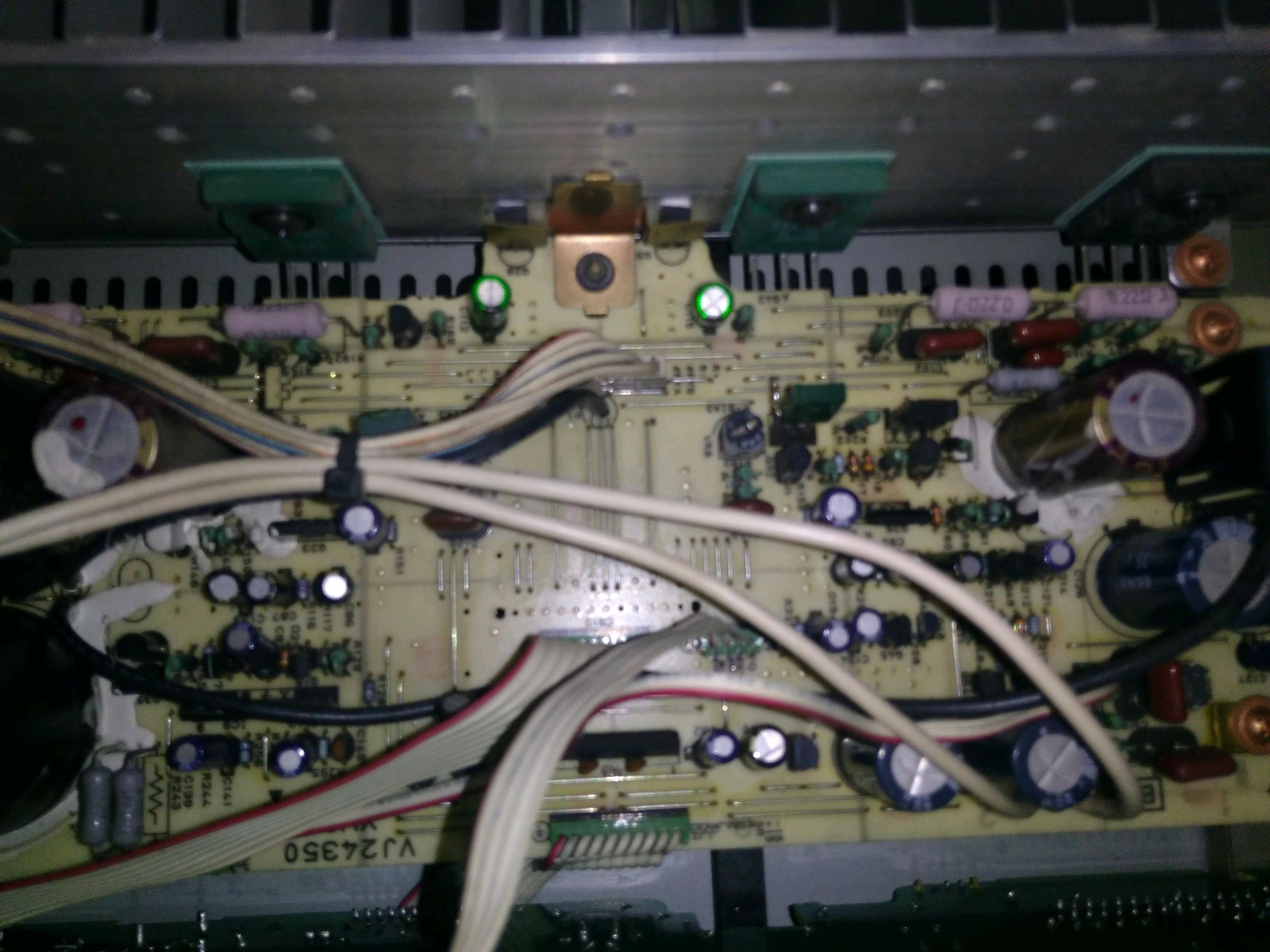

so lookiing for help or info on how to fix this beautiful yamaha ax540 so all rca work head phones work no sound out speakers but if i hold a speaker wire on the bottom of the relay i get sound out of the speakers so i changed out the relay still same thing changed out the resistor same thing the relay is not getting power is what im thinking i end up ordering ceramic caps hoping thats it any ideas would be great

the relay dont even click at all no sound from it why i thought the relay was bad there so i was thinking its some thing to do with power thats why i end up changing out the the resistor the relay board is diffent from the main board so i was thinking it was something on the relay board because nothing looks burned out were the wires go to the main board but i get sound out of the headphones and on the bottom of the relay if i hold a wire i did just see the old relay was 24vdc 5a40vc 5a24vdc the new one i order the right one onlinee but send me 48vdc 5a40vac 5a24vdc idk if that matters

Yes it matters ... there is no way a 48 volt relay is going to pull in on 24 volts.
So, first thing start by putting the old relay back in.
If neither relay is pulling in, your problems lie elsewhere.
I can't tell exactly what's wrong by staring at the schematic. We need to get voltage readings from various points in the circuits to determine what the problem is.
Now.. again... do you have a multimeter?
If you don't, I'm not going to be able to help you (nor can anyone else online) and your best bet is to take it to a qualified technician.

Douglas Blake i did what you said to put the old relay back in and it worked im shock because when i got it it had no sound so im guess the solders were bad or really was the two small resistor i changed out im just so happy for your time and leittle help u ave me ill be posting more suff down the road like i said i need to learn much as i can to fix my own stuff no vinge repair shops by me uless i driver 2hr away or more god i hate PA
Very good ... What I would suggest is that you take and retouch all the solder on that relay board. Heat, vibration, age, etc. all add up to the occasional joint that goes bad.
