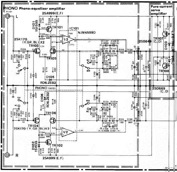

Yamaha amplifier Upgrade

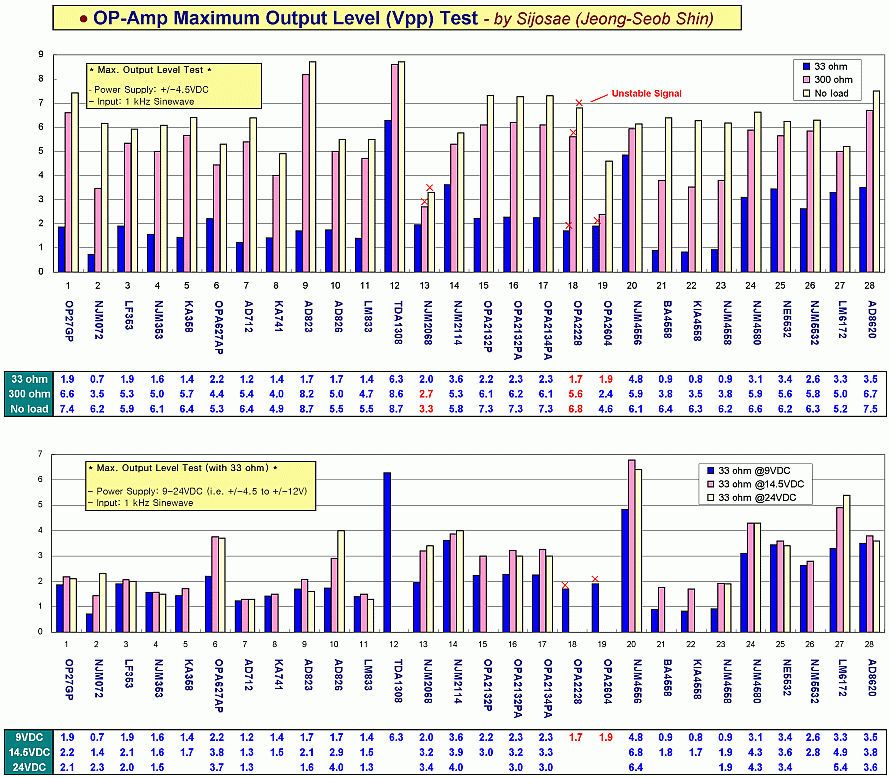

as to the opamps ...ditch the 4559 and the ne5532 there pretty pedestrian these days ...
fit a good quality socket with berylium pins...
then try opa2604 as new standard
then there opa2227 thats interesting...and many others besides..
most should drop in and give you a flavor before you need change surrounding components.
But the biggest change will be if you fit good caps/better caps to any signal decoupling positions.

I can “swap” O.P. amps (i.e. 4559 for OPA2604 or NE5532), with the same associated components in the circuit, without worry about factors like gain and input and output impedances?
Thanks all.
Hi Macpibe,
Normally yes. You must be careful of some op amps that need their compensation adjusted to suit the circuit and supply bypassing. Try not to use sockets.
Always check for oscillation with an oscilloscope if you can.
-Chris
Hi Carlos,
Is it critical in low frequency systems, like used in audio?
Your intended signal is a low(er) frequency, but some devices will merrily oscillate at higher frequencies. You must be aware of this. If you ignore this you will learn it the hard way.
My experience has taught me to consider the audio bandwidth to extend up to the area of 1 MHz. I have seen circuits oscillate above this frequency. What do you consider the high frequency of audio to be? Unintended signals are every bit as important as the intended ones.
