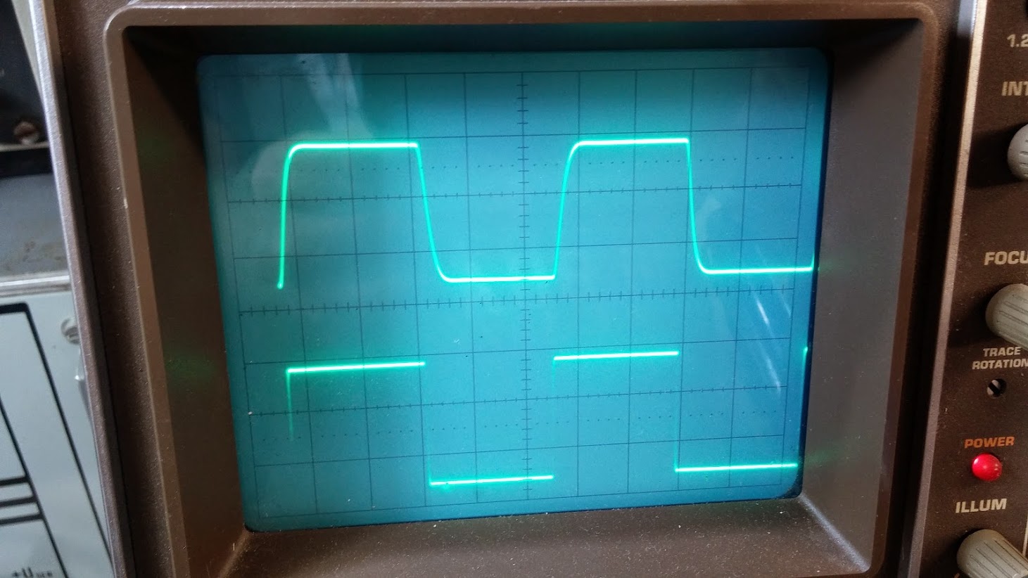

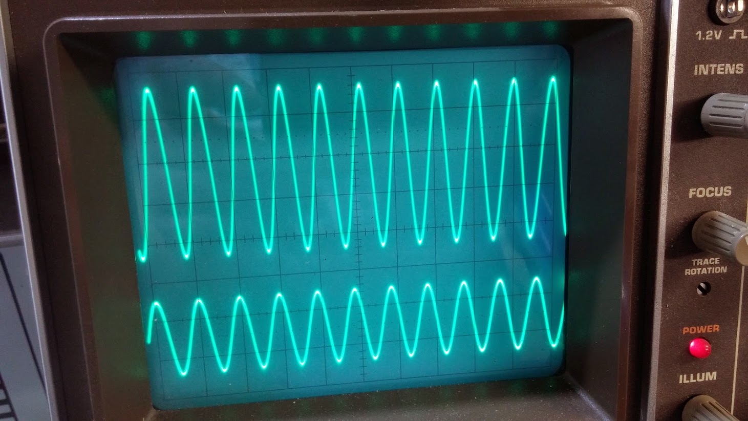

yes. I using this for my second hobby 😀

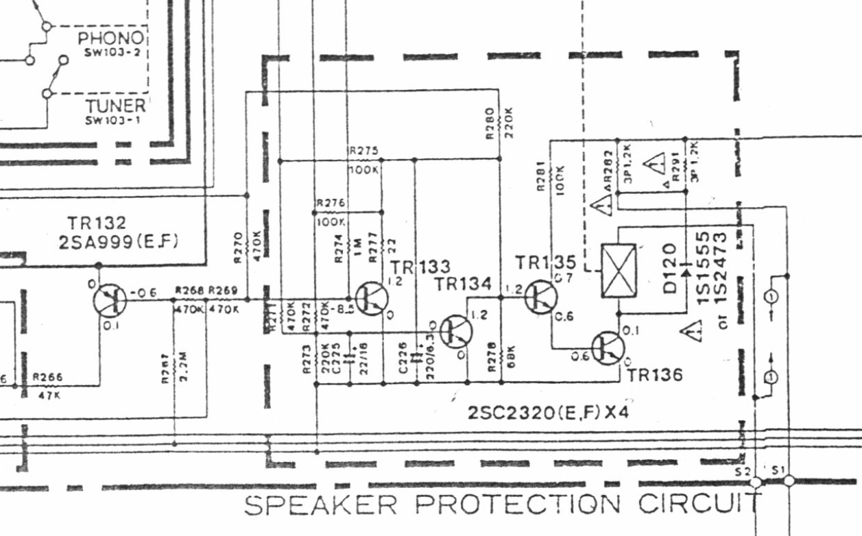

For record keeping - got another A500 with identical symptoms: protection triggering with no reason.
It was done some maintenance - full recap, relay contact cleaning, volume pot replacement. Had to replace zenners all 3 (orange ones) as they being rated 16v but actually across zenner voltage was much bigger 17.5v - 18.6v. New zenners fixed issue but they heats up a bit so need to install at least 1W rated. Oh and had to re-solder some dry joints on PCB as usual for that age amplifier.
Measurements:
DC offset is normal 20mV and 40mV.
Idling current as per manual 15mV.
No AC in speaker terminals from PSU.
No speakers connected so no short in speaker terminals.
With current UK mains voltage voltage out of PSU is +-50.5V where suppose to be 49.5V.
Symptoms:
After warmup period approx 5-15 mins clicks relay and disconnects speakers.
Then after couple of seconds clicks back.
Intervals between cycles - random but in range from 15sec to 2 mins.
One more interesting observation - if to tap with finger area near output transistors or especially where protection small transistors sits, always triggers protection on tap.
Based on djk advice I have replaced all small and big protection el.caps in protection but as it happens, all measured with ESR Meter as aged by a little but still working.
Protection sensing transistors (TR125, TR126, TR129) (those were sensitive to touch on legs from solder side of PCB) measured as working (measured voltage across legs and with diode mode on tester) while on PCB.
Now main part of this report: I have de-soldered each of them from the board and put into multimeter - again all were in specs ~400hFE and ~600mV. And when all 3 were soldered back, protection stopped to trigger not only by itself, and stopped triggering by finger tapping around the same areas.
So root cause might be:
- close to fault one of protection transistors, which were magically (might be temporary) fixed by giving heat stress during removal and putting back.
- less likely but still might be - it was conducting dust or flux around those protection transistors terminals.
Time will show if it was fixed for good, or for how long, but for now amplifier works fine.
And to final note - even for the same symptoms cure might be totally different...
Well... After 12 hours of working amplifier went into protection triggering on-off cycle again. I must admit it was expected in case if fault was caused by transistor which started to work after heat-stress...
This time I have invested a bit more time for proper diagnostic.
Findings: measurement shows that TR125 on Base had fluctuating voltage in range 200-375mV. When the same TR126 for the other channel had constant voltage approx 40mV.
So after replacement of TR125 with some random transistor (just checked max voltages as per spec), on Base it got constant 5mV voltage and amplifier is no longer triggering protection.
Interesting case when protection circuit is triggered because of itself fault, not the main amplifier circuit fault...

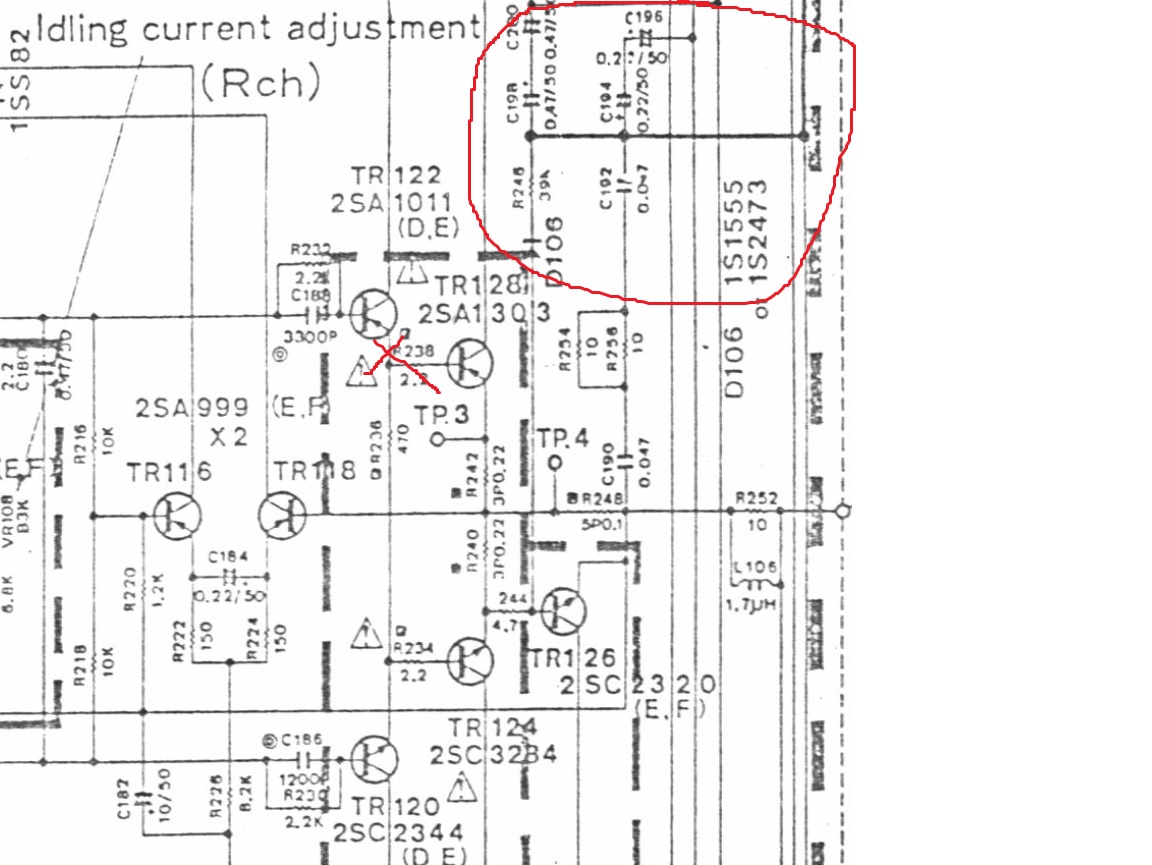

A500 - what is behind R and C in in driver's bases?
as we have Yamaha A500 repair thread it might be right place to discuss what is the reason for R229 (2.2k), C185 (1200p) and R231 (2.2k), C187 (3300p) in bases of driver transistors?
If all this is for oscillation suppression, why not single 100 ohm resistors? And perhaps 220p across BC?
And why caps values different for NPN and PNP drivers?
Strange that A500 must be simpler circuit than A700, but in A700 there is no such RC in driver's bases.
Another resemblance I saw in NAIM NAP140, but there was slightly different configuration, but again similarity to this is the different values for R in NPN and PNP driver's bases.
And again, what for all this stuff?
Thanks.
Kes
  • 2021-10-11 21_49_40-yamaha_a-500_service.pdf and 15 more pages - Personal - Microsoft​ Edg.jpg

a500 goes into protection mode
Hi, seems I had repaired same amp model with the same issue. When left turned on, even without signal, protection relay clicks after 5-30mins without reason. So I had to replace one of small protection sensing transistors (in red). Assume you replaced small electrolytic capacitors around protection transistors (in yellow) before.
  • 2024-03-08 08_07_54-yamaha_a-500_service.pdf and 4 more pages - Personal - Microsoft​ Edge.png
Hi Kesrmrk
From memory the caps were replaced -- i will check - however the transistor you refer to (on both channels ) may need a look- again from memory there seemed to be a couple of "freefloating" transistors were sort of "clamped "to the heatsink- i added some thermal compound- to no avail...
maybe the one you refer to....??
