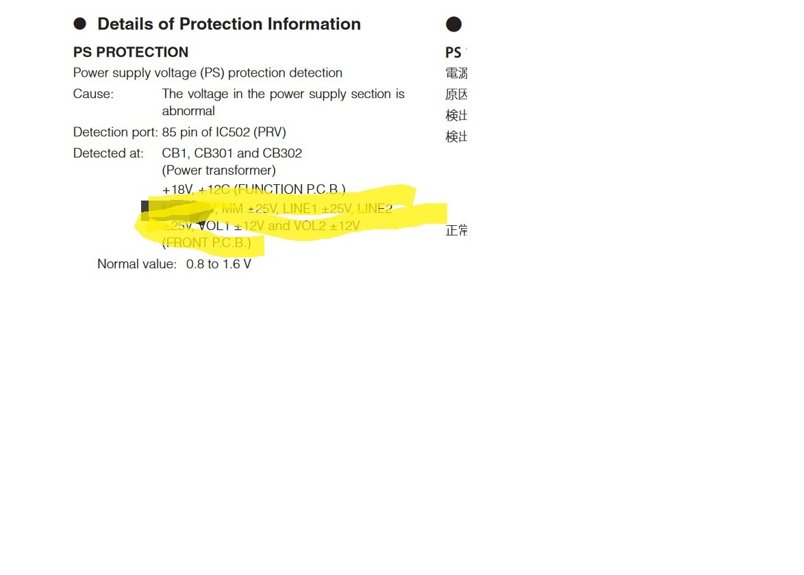

According to the instructions given from page 26 on in that manual, I entered the self-diagnostic mode. The Standby LED flashes three times, followed by a short break, then it continuously flashes twice, followed by a short break etc.
This isn't a flashing pattern exactly described in the List of protection information. But if I neglect the first three flashes, the following ones (flash flash break, flash flash break etc.) might correspond with the pattern in the second line and hint to PS (power supply) protection.

If my assumption on the failure code applies (see page 26), there's a PSU issue. The microprocessor IC502 on Function Board 1 (page 67) watches the complete PSU, with the exception of the four floating power amplifier rails, by a port called PRV, at it's pin 85. The normal voltage should be 0.8 to 1.6 V. I measured 0.6 V. The PRV bus can also be found at the Main (3) and the Function (2) boards (pages 68, 69), among which the small signal PSU parts are distributed.

I think you've already done what I was going to suggest--- namely work through the checks detailed on pages 27 and 28. And I like your experiment on the PRV voltage.

Not clear if you checked the test points on the front pcb

Oh, how silly must I have been to overlook this hint! Instead, I dismantled the unit from it's rear to get direct access to the different PSU sections on the FUNCTION 1 and 2 boards and found all voltages spot on.
Anyway, I'm still scratching my head why the amplifier keeped to be in protection mode after I increased the PRV voltage to more than 1 V. PRV is a bus than meanders all through the unit and monitors all small signal PSU sections (even the AC lines out of the main transformer), using a sophisticated network of voltage dividers. The microprocessor IC502 measures the PRV voltage and says the PSU is ok if it is between 0.8 and 1.6 Vdc.
Best regards!
Edit: I don't spot any test points at the FRONT PCB, neither in the schematics (p. 70) nor on the PCB layout drawings (p. 60)???
