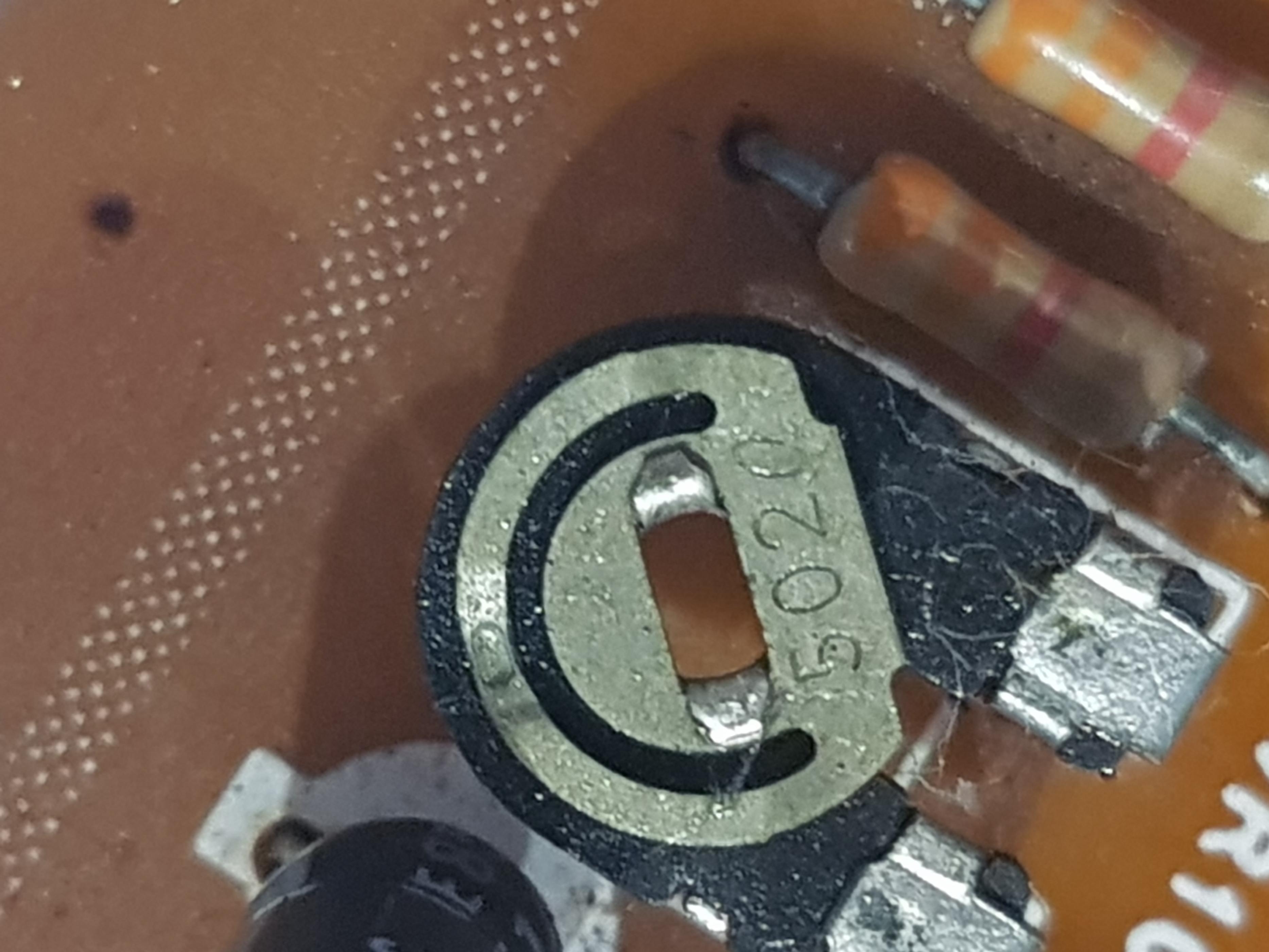

I am thinking of changing the crappy bias trim pots which may contributing to the bias fluctuating.. as I do not have a manual, the only thing I can see is the writing on the pots which reads: 502 and I believe the symbol ohm?
