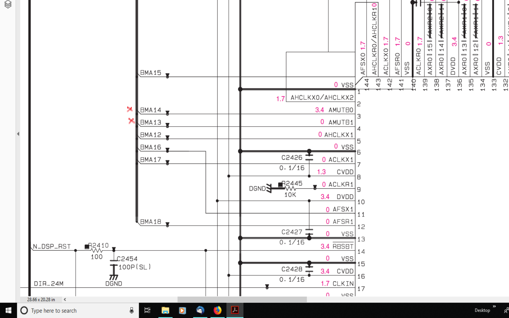

Yes, The other muting transistors swing to -11.7v when unmuted. I found two muting channels on the Audio DSP chip that goes to one of two flash memories. Both channels have a resistor at the flash memory In/Out pins if that means anything?

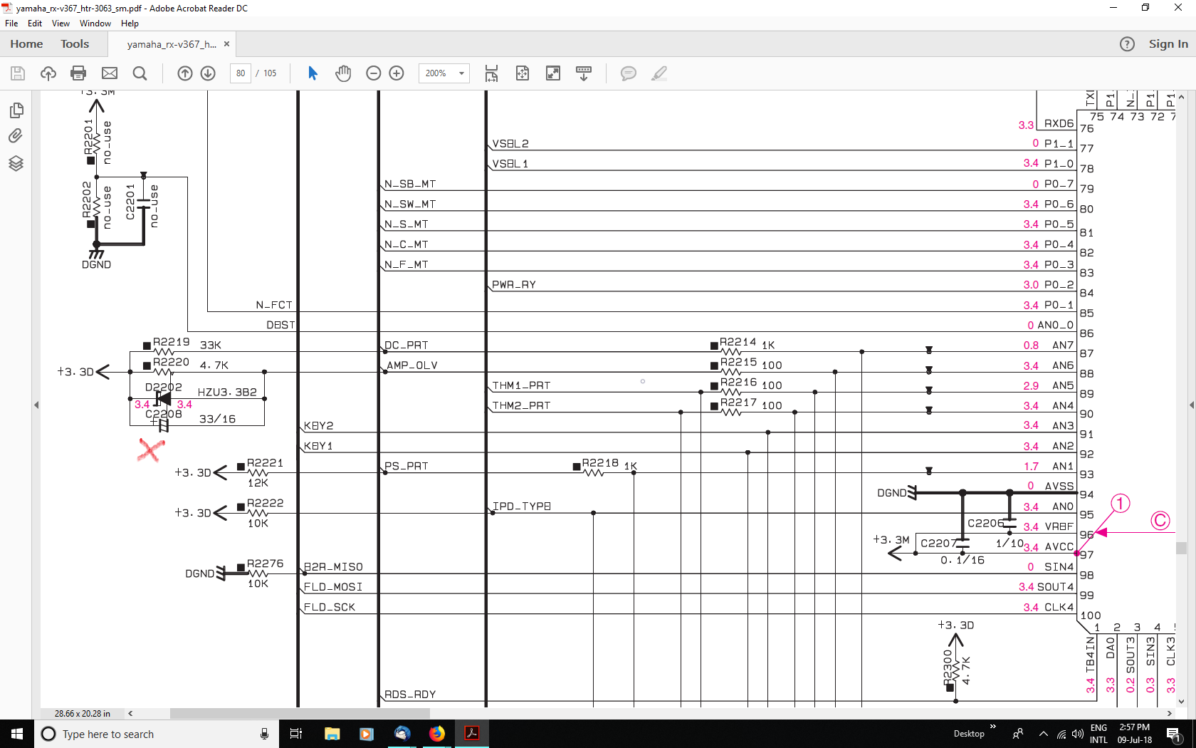

I can't really see anything related around there tbh. I spent quite a long time looking at the full circuit yesterday and I'm baffled how the -11 volts is derived. Also you say you can see the base voltage change which indicates the mute on/off logic signal is OK.

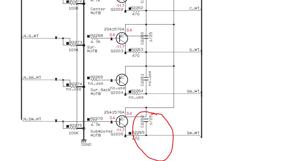

There is a 1uF cap next to Q2205 on the diagram. Is that OK and not leaky ?

I've been looking at the schematic for months now trying to work it out. It's a real mystery even a Yamaha tech couldn't help me with the -11.7v source? I will replace that electro cap and get back with the result.
What I would do if you don't find anything is to work back from a mute transistor that does work. See where the base goes, and what goes to the base. Try and find the source of the -11v bias voltage. Normally it would just be a resistor to the -12 rail.
Also, the muting transistor are a unique type and designed to withstand the -11 volts reverse bias across B-E.

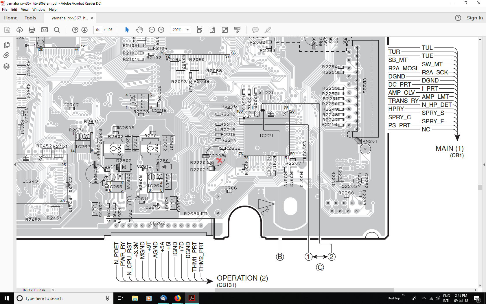

The only electro cap near the CPU I see is a 33uf, 16v. Is this the one I should be wary of? I'm changing it anyway just in case. Oh, I just realized you said Q2205 transistor, so that's an SMD cap.
This one. If it was leaky it would keep the mute line high.
Also check for continuity from this transistor all the way back to the mute transistors. It might also be worth trying as a test to add a 47k or 100k from the collector of this transistor to the -12 volt rail and see if that fixes the issue.

On the face of it yes but as always check it out of circuit. If it reads OK when isolated then recheck and see if the short is still present with the cap removed. If it is then you need to investigate further to see what is causing it.

It reads 0.9 ohms out of circuit. So that's more than likely the problem then?😀 There is 698k ohms across the gap one way and 0.00ohms the other way? I hope that's OK?
If it reads anything out of circuit then its faulty. All small non polarised caps should read infinity (open circuit) on a resistance test.

Yes, I'm sure its the right cap. When I said I measured across the gap I meant the gap where the capacitor was in case there is any confusion? It reads 468 Mohms with the black probe on the Q2205 base and red probe on the far side of the gap. And 698Mohms the other way round.Just seeing that you mention 0.00 ohms across the gap 'one way'. That sounds odd but lets stick with the cap for now (you are sure you have actually got the cap and not some zero ohm link that looks like a cap 😉)
