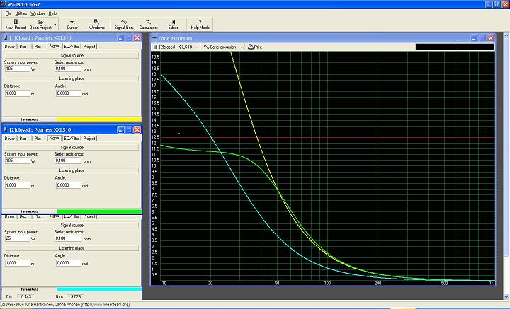

I am trying to find a suitable box size and LT-transform for a sealed XXLS 10" based woofer to be used fairly high up in frequency, to about 120-160 Hz, for music use mostly. I use winisdpro for modelling and I'm now trying to figure out how to design this so that I don't risk exceeding the driver's xmax. Can someone help me by explaining how I should think regarding excursion and amplifier power, what is the best solution here...? I have searched this forum and read Linkwitz, but I'm afraid I don't get it all yet ...
If I have a closed box of 40 liters I can enter a signal of 105 watts and the excursion stays below xmax all the way. If I also add an LT-transform (Fp=25Hz, Qp=0.55) then the excursion exceeds xmax already at about 38 Hz. Reducing the signal to about 25 watts makes the excursion stay below xmax until 20 Hz.

Excursion & SPL plots ...
This image show an excursion plot. Green is 105 watts and no LT, yellow is 105 watts + LT, cyan blue is 25 watts + LT.

dunno exactly how that Linkwitz transformation operates, but it is certain that with any boost you also need more power from aplifier. so adjust the "Linkwitz" and cabinet size so that the needed power from aplifier doesn't rise over 105w + enought SPL is achieved.
managing excursion might not actually be quite so crucial, the driver has +-25mm xmech. Reaching its mechanical limits in closed enclosure (with that spesific amplifier) is very unlikely to happen.

I could not resist simulating this system in Basta!. It can be seen that below ~80 Hz, the maximum output level is limited by Xmax. Changing the Linkwitz transform will not change that at all. Using a larger box will shift the knee between Xmax and power limitation towards higher frequencies.
Curves are: Gray: max output level (MOL). Red: Cone excursion at MOL. Purple: Voltage required to reach MOL. Black: Frequency response. Green: Impedance. Blue: Amplifier voltage.
