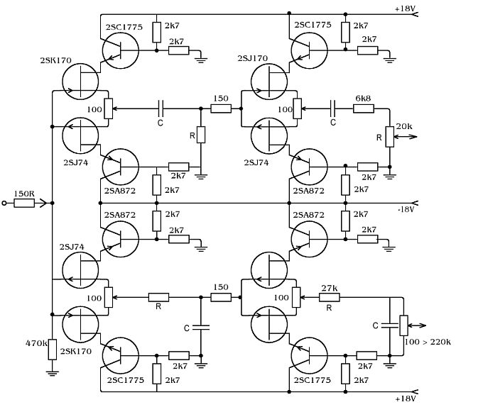

Found this the other day, from l'Audiophie magazine and uses the input stage fom the Le Monstre power amp.
<font color=#808040>Fig 17: Filtre actif 2 voies utilisant deux filtres passifs RC en cassade. Caracteristiques des composants: resistance a 1% tantale, condensateurs cuivre, potentiometres a film plastique, trim 100<FONT FACE="Symbol">W</FONT> <<COSMOS >>, La frequence de compure est aisement determinee a partir de F<sub>c</sub> = 1 / 2 <FONT FACE="Symbol">p</FONT> RC Ainsi pour une coupre de 590Hz C= 10nF R = 27k<FONT FACE="Symbol">W</FONT>.</font>

Found it posted at <a href="http://forums.delphiforums.com/n/main.asp?webtag=haute_fidelite&nav=start">le Forum de HAUTE-FIDELITE.net</a>, can't find the thread now.
The original poster said;
<i>"I do not know if it is Kaneda, it is the active filter of the audiophile N°7, new series. With the PSU of Kaneda 50W and the input stage of the Monster 8W for each of 4 cells"</i>
Tanslated the caption for the schematic using <a href="http://trans.voila.fr/?getting_web">Viola
</a><i>Fig 17: active Filter 2 ways using two passive filters RC there cassade. Caracteristiques constituents(component): copper resistance is 1 % tantale, condensers, potentiometres has plastic film, trim 100<FONT FACE="Symbol">W</FONT> < < COSMOS > >, The frequence of compure is aisement determinee has to leave Fc = 1 /(2 <FONT FACE="Symbol">p</FONT> RC) So for a coupre of 590Hz C = 10nF R = 27k<FONT FACE="Symbol">W</FONT></i>.
Thought someone might find it of interest?
