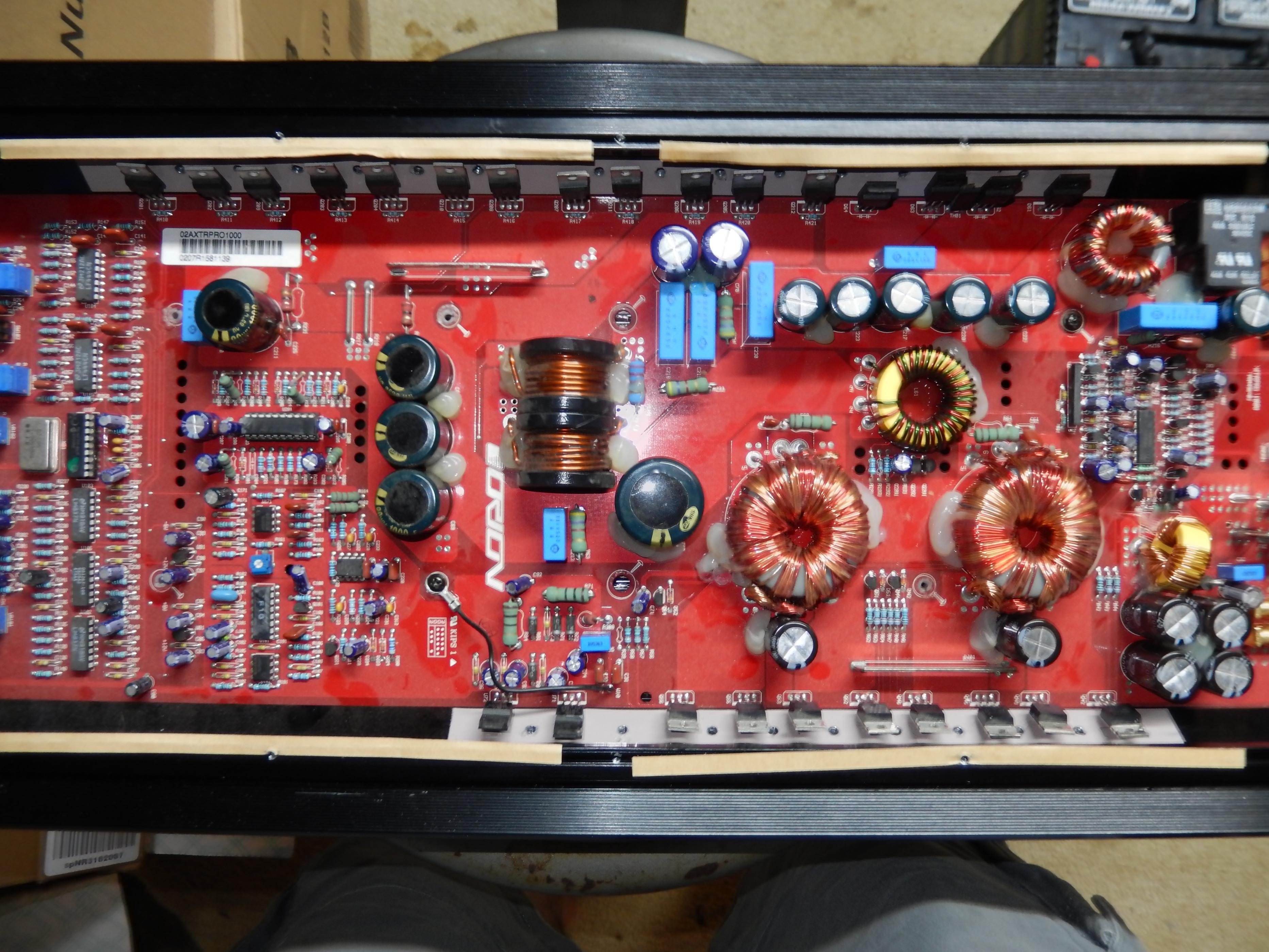

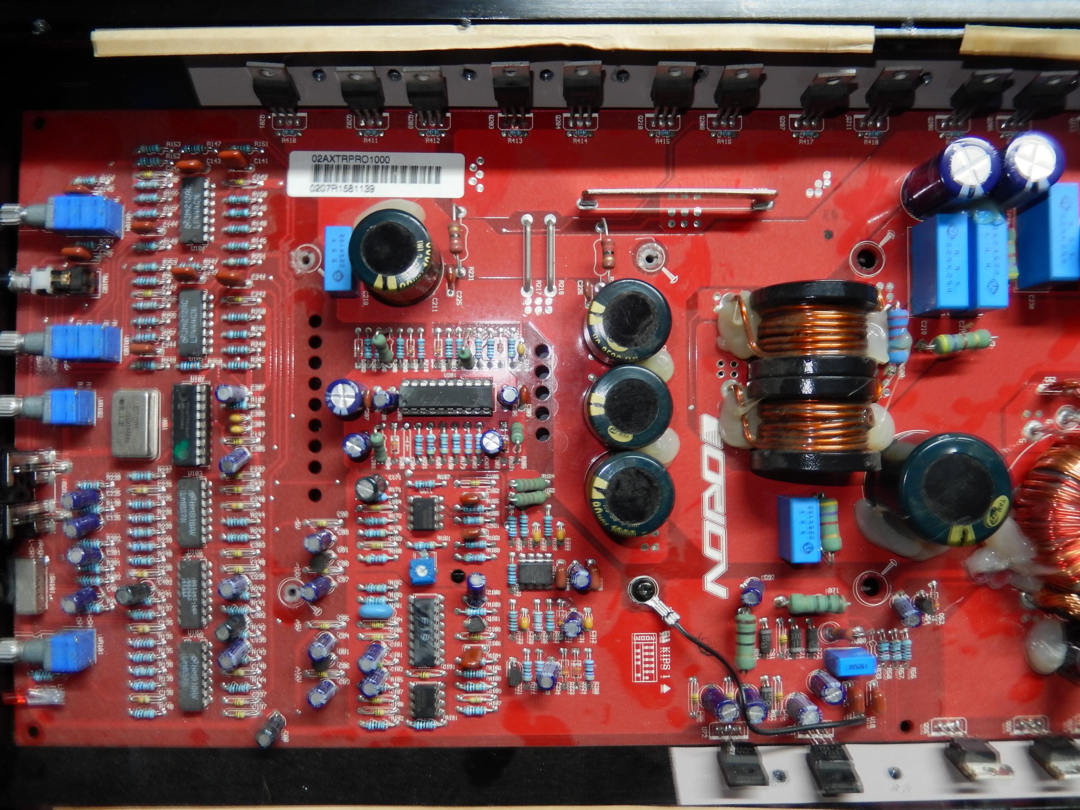

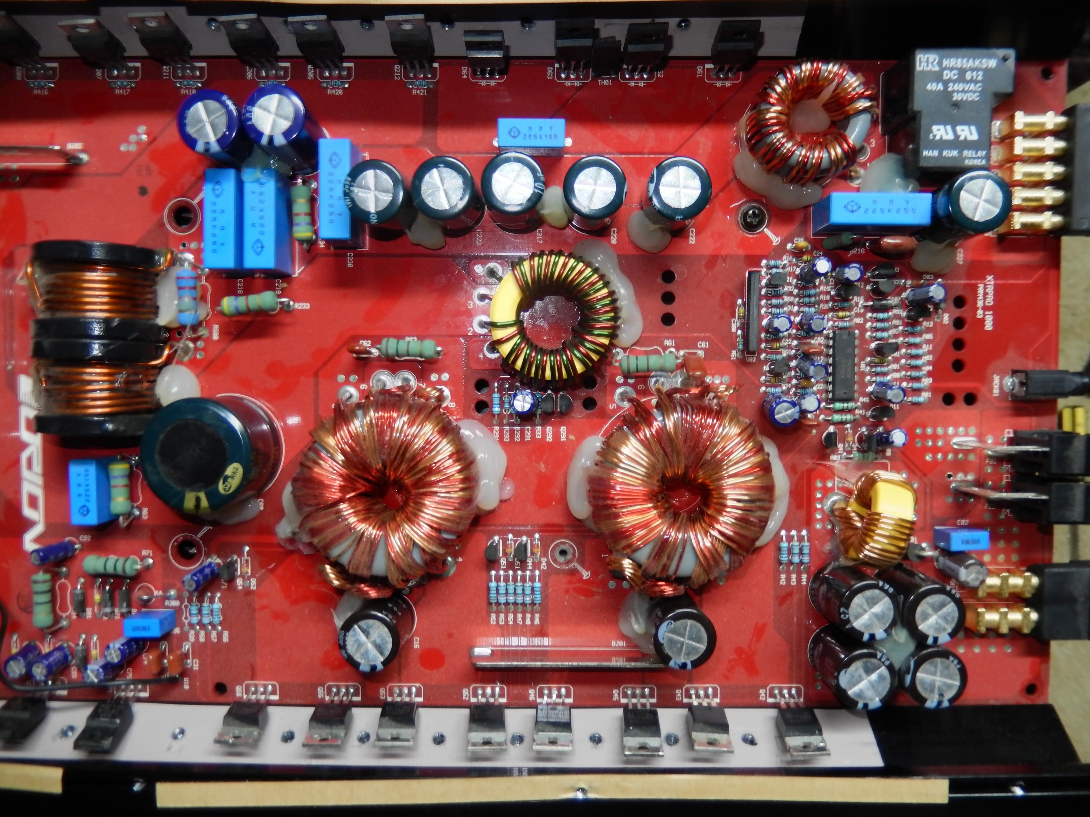

Resoldered a rfg40n10 @ Q203 and OK'd continuity. There's a soft-rhythmic clicking then the relay clicks loudly. No output and the power led remains steady red. Any clues to what it is?

I apologize for dodging your question. Q203 looks like hell in the picture. I tested each leg of Q203 vs other parallel components/FETs with the continuity function on the DMM. The copper was pulled off the top of the board by the previous owner and wanted to ensure the soldering was good. I may have misused the term 'continuity'.

I already tore it apart, put a 10ohm resistor in series with +B. Read 1.1A draw and no power to led. Then proceeded to pull Q203 (REP40N10). No change in current draw. Next I pulled Q42 (IRF3205). The current dropped enough to where I felt I could power the amp without the 10ohm resistor. The led is now powered on, and the relay clicked. I still hear a faint-rhythmic clicking somewhere.
Ok, I'm starting to nip this thing in the butt.
Found out Q201 (RFP40N10) was shorted. Pulled it , applied power, and now the faint-rhythmic clicking has stopped, led still lit. Q42 (IRF3205) also shorted.

Is the delicate 20 pin IC ok? I have no idea what it is because manufacturer sanded the numbers off.
The 20 pin IC is an HIP4080. If the amp functions without the shorted IC, the 4080 is likely OK.
