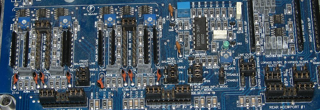

Also in the second image the LM311N (u22) circled, Its waveform on pin 2 and 3 do not match the 311 to the left(u21). they look to be garbage/noise. I looked at your tutorial's waveform of a x603 and u21 matches u22 does not. Thank you again for your help Mr. Babin.

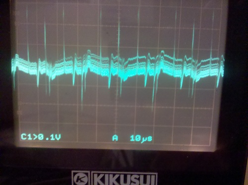

Ok so I did not even make it as far as the muting circuit. In the first image below here is what all of the inputs look like without signal...it measures -1.04dc with no signal.

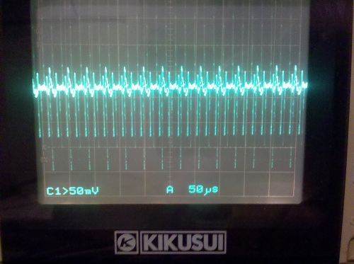

The second image, was verified before connection, perfectly good sine wave at the input.
So what do you make of this?
It was taken at 10 kHz. I was working with 1 kHz but must've hit the 10..
so the signal is very weak at the muting transistor for the left channel (the channel I was inputting to) and distorted. The right muting transistor had the signal,while having no direct input, and was also very distorted.

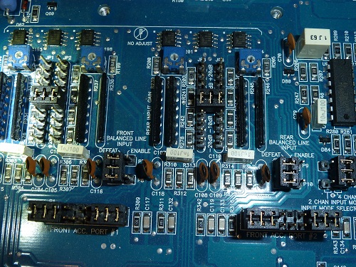

No change after removing muting transistor. Do you happen to have one of these amps? I am curious to find out if a trace I see that is cut on the underside is normal.
I think you'll have to go through the circuit to find the point where the signal drops off. The channels should essentially be identical. At least no you know the problem is in the preamp section and not the power amp.
I don't have one of these. I have photos but only of the top of the board.
I am not currently in in front of the amp but how likely is it that the 2068 op amps failed. If defective is there a better substitute than the JRCs?
I have a 604X that I can look at the bottom of the board on if that would help. I know the X604 and the 604X are similar I just don't know how similar.

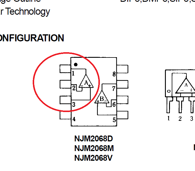

So I have traced the signal to U2 (middle 2068 op amp front channel), and it seems to be my source of headache. When looking at the waveform of "A" output (pin 1) I see DC with just the tops of my input waveform.( ___n___n___ ) That is a rough sketch of the waveform...😉 The non inverting input pin 3 has a poorly shaped version of my input and pin 2 has a similar waveform to 3.
I removed the opamp and found the amplifier behaving normally...or as close to normal as I have seen from it. No crosstalk on the other front channel now and seems to be amplifying the input signal...
So I am curious...and this takes a lot of pride swallowing to ask...how is it with this opamp removed does this beast function? When you move the input sensitivity jumper does it change the amplification through u1 or u2 with the different resistors? It would be far simpler with a schematic i guess..
I have attached a pic of the 2068 from the datasheet so others looking can have a visual.
