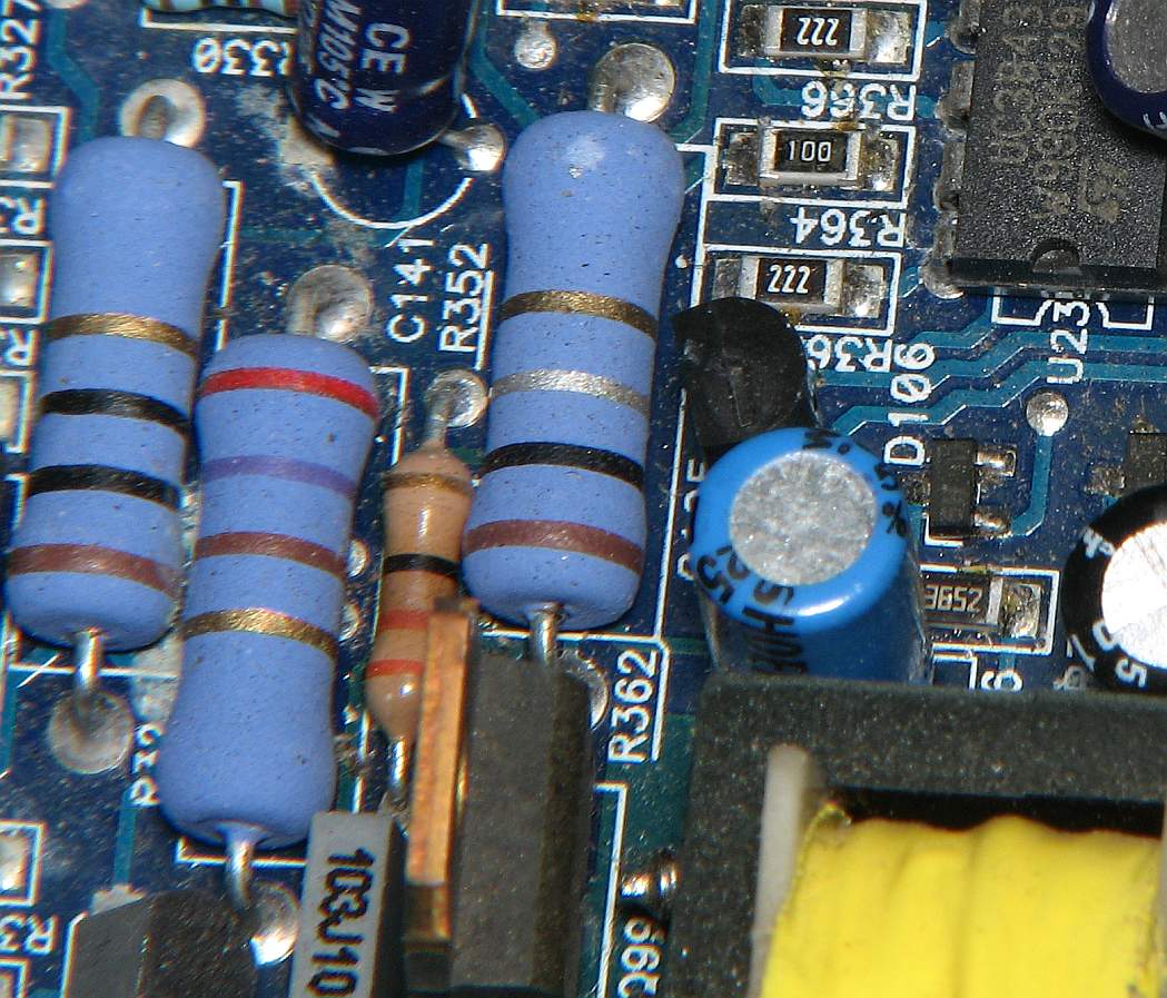

A Alf405 Member Joined 2023 2023-10-12 7:40 pm #1 2023-10-12 7:40 pm #1 I need help whit resistor r352 what Valium is burning and can't read whit my ohmmeter because is completely blowout or burning P Perry Babin Member Joined 2003 bcae1.com 2023-10-12 8:46 pm #2 2023-10-12 8:46 pm #2 33 ohms. The one in the photos I have shows signs of heat stress so it may benefit from going up to the next size larger resistor. Confirm that C140 isn't shorted or out of tolerance. Attachments IMG_0934x.jpg 152.8 KB · Views: 59 A Alf405 Member Joined 2023 2023-10-14 10:37 pm #3 2023-10-14 10:37 pm #3 ok let me check and let you know thanks Perry You must log in or register to reply here. Share: Facebook X (Twitter) LinkedIn Reddit Pinterest Tumblr WhatsApp Email Link
