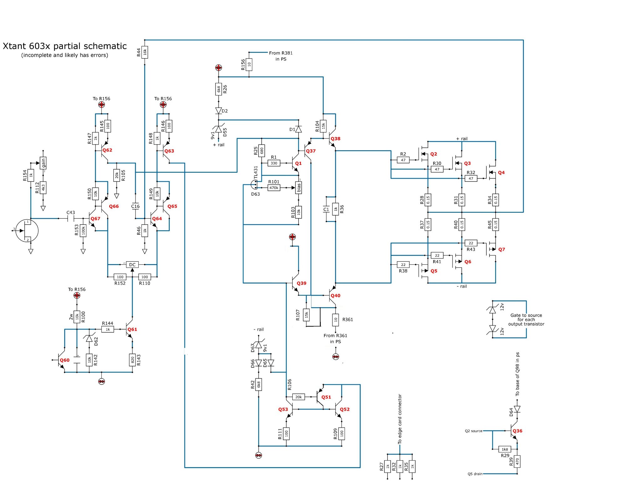

attached is the updated schematic with fixes.
Core changes:
1) Q51 emitter and collector were swapped in the original schematic
2) R107 connected to Q39 and Q40 moved to appropriate location
All pre-driver transistors attached to power supply positive and negative voltage rail via 10Ohm resistors in the power supply section. R361 and R381. I didn't add R381 but fixed R361 connection (originally R155 connected to Q37 and Q40).

For the collector of Q53, is the difference really -40v to -4.6v?
Are you sure that R146 survived?
Does the bias make a difference?
That is what I have measured but I have only measured it once since I was using the schematic with error and thought I was covered since I have been measuring at R107. Looking at both measurements I did I see that Q51 emitter voltage is -40V in both measurements. Also the D67 zener voltage measured -38.3V and -40V (2 different times).
R146, R111 and R109 will burn if I keep the power on long enough. In my case with short bursts all survived but likely were cooked (still measure ok).

I have loaded Q51 transistor and played with 20k pot (took measurements and compared to other channels). Measured at 2 spots. The values across all channels are different. Connected to battery and only saw 1.26V DC offset. What is interesting is that I can change the offset to 0, but it won't go to negative numbers unlike other channels. Perhaps I have a bad solder joint but I couldn't find it. I checked Q64, Q65, Q66, Q67, Q51, Q52, Q53 transistors and they all measure ok (diode check and ohm readings).
Q811 (Q51) now has:
Collector: -53V
Base: -1
Q53 (Q810): collector has -5.2V
This is now in line with other measurement I have done on a good channel previously.

I resoldered Q51 (Q811) and it made no difference. Here is what I have noticed, when I started to play with gain I could get the output go back to -29V. Though it was strange as I could find a sweet spot when it wouldn't do it (if I turn the pot cw or ccw) it will go to -29V. When it is not tight to the rail voltage the dc offset can be changed from 0 (500 Ohm rpot fully ccw) or negative voltage -1.3 or higher. Letting amp run for a bit I have noticed the output went back to -29V.
With output tight to -29V I have measured the Q53 pins:
Collector: -40V
Base: -40V
Emitter: -40V
The transistor is not shorted.

I found today R145 (100 Ohm) that was blown as well. This happened likely when I was adjusting the bias and/or probing around.
I have swapped Q811 (Q39 equivalent) and the amp had 0.136mV of DC offset on the output. I was able to adjust it in positive and negative direction. Set it to 0V offset but 40 seconds later or so the output went up to -29V. So it was stable for very short period of time.
Correction: replaced Q811 (not swapped). Also replaced Q814 and Q813. Now the offset only stays negative in -7.2 to -4V. The green overcurrent LED is lighting up... This wasn't happening before.

The overcurrent circuit is triggered by Q36 on the diagram. Confirm that its (equivalent) is not defective.
Confirmed Q36 is looking good. Replaced Q63 once again. I had some traces damaged when I was replacing it earlier and since I have been wiggling it back and force many times those pins experienced some fatigue. Haven't tried powering on the amp yet but doubt there will be a difference. The BF432 transistors I am using are made by Philips. I do see a difference when I ohm out some transistors though (could be due to different parts being used):
