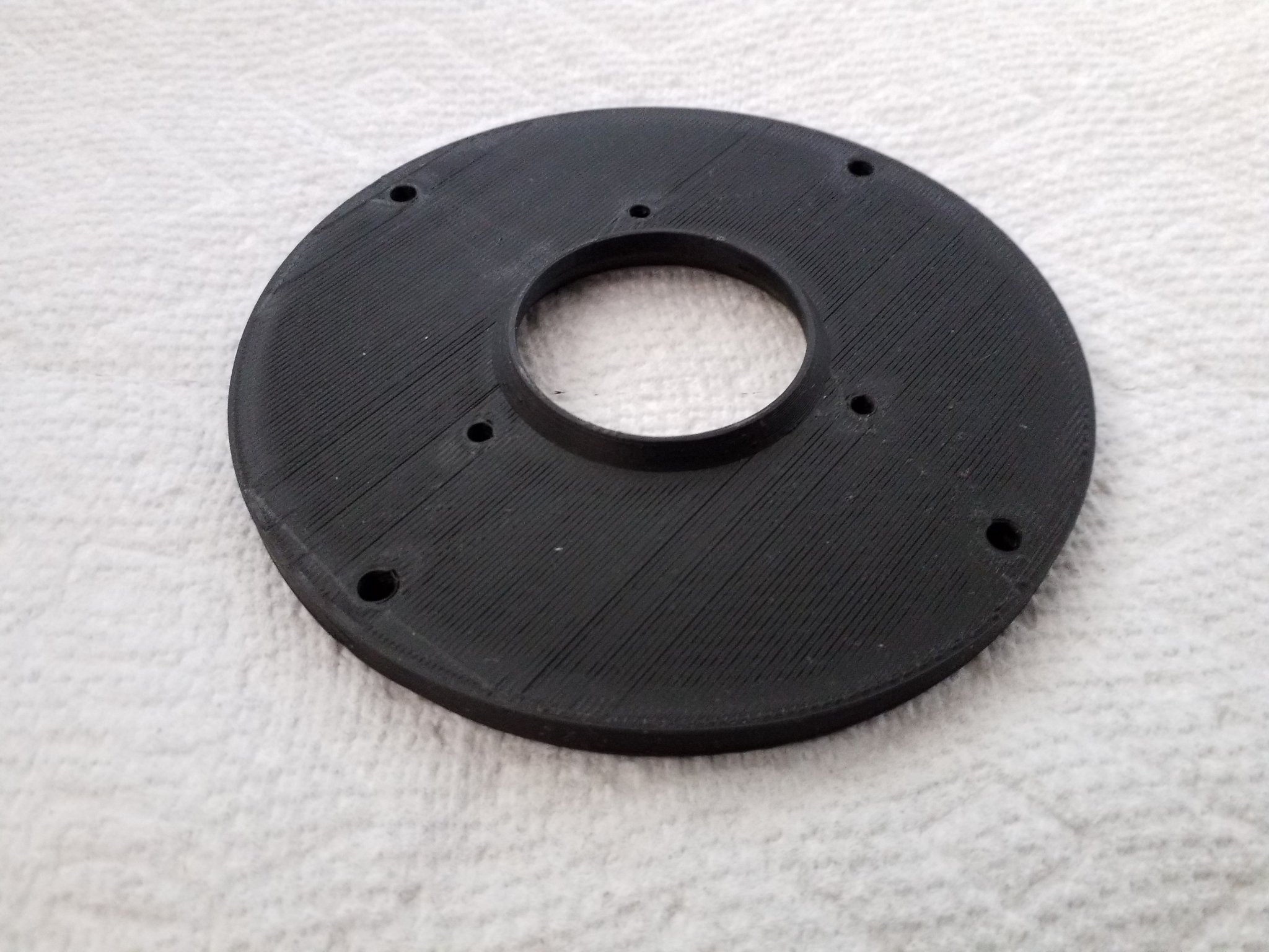

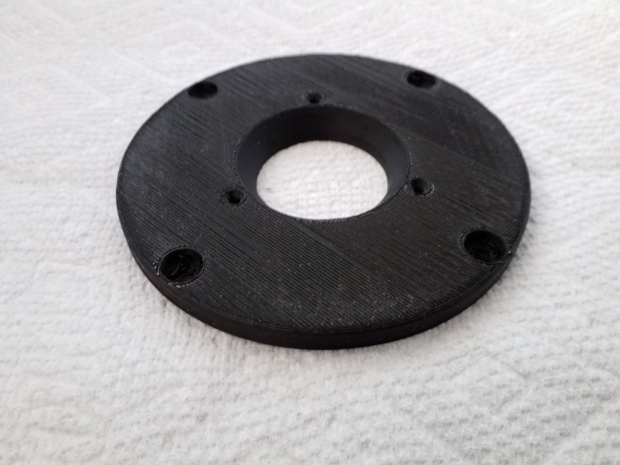

I printed a set of adapters to fit my Visaton WG148 waveguides thinking I had the correct STL file, but it looks like its for another WG.
Its been a while since I downloaded the file and I dont remember.
Dimensions are 4.5" OD and the opening tapers to 50mm. I'm not sure if its intended for the Monacor WG300?
Can someone tell me which file is the correct one for adapting the Peerless XT25 to the Visaton WG148 and possibly ID the adapters i printed?

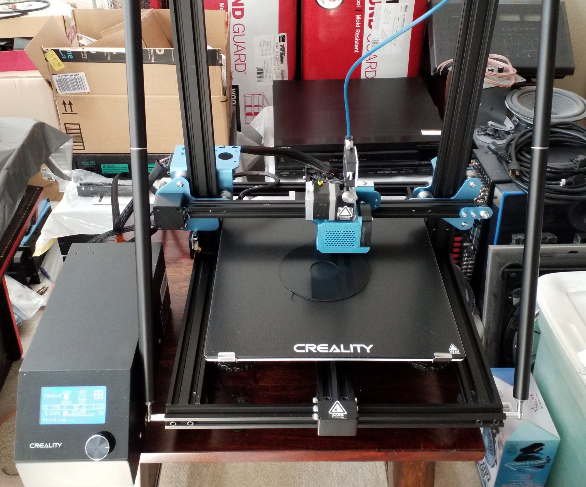

I found the right file on Thingiverse but it wont print without all sorts of layer adhesion problems.
I tried several times, optimizing settings and it just messes up mid print. The g code runs the steppers very hard and fast to the point the belts chatter. The vibration alone is enough to dislodge the print.
I envy the people who have sub $1000 printers that actually work without massive amounts of fiddling and effort. Thats not the luck I have.
I guess thus is why its smart to pay someone to do it for you. By the time you spend all the money and time getting frustrated trying to get decent print quality from these Chinese backyard engineered contraptions, you could have paid a professional to do it right. I come from the world of walk in CNC machines which cost more than a house. Theres a reason why these things cost as much as they do. You get what you pay for.
Reactions: Bryguy
No, it was done on my slicer, but I'm not sure it had my preset preferences in it ie. travel time, retraction etc. The only reason i assumed it was their settings was that the other files and test pieces I printed turned out ok, which didn't work the motors that hard during traveling.
I set my preferences in the slicer to be compiled into the g-code, including reducing print and travel speed, so I'm not sure why my preferences weren't observed.
I'm not that savvy with 3d printing, neither do I have the time or energy to babysit the stupid thing all the hours while it prints. All I know is the typical setup stuff and basic troubleshooting. I dont have extensive experience with detailed slicer settings to fix a problem which appears to be aggravated by less than optimal compilation in the slicer. It took me a long time just to straighten out the z axis on this POS printer along with all the extruder and hot end issues. Could also have an under-extrusion issue due to poor infill and insufficient retraction causing some light stringing. Its just too complicated for me to figure out and I don't want to spend hours and days trying to fix all the settings. It was bad enough the dual z axis never stayed synced until I force-tied them together.
I wish I had the money for a nice Statasys machine. Thess cheap Chinese printers are just toys.

That Creality printer is notorious for being extremely difficult to work with. It is an unfortunate thing, that the easy ones that are accessible to hobbyists who don't want to spend a massive chunk of their life figuring out how to use them all cost more than most hobbyists want to pay. As soon as I move, I'm going to buy a Bambu P1S. They sell an even cheaper version, the P1P, but I want to be able to print ABS, due to its durability (especially its impact resistance over say PETG) and the fact that you can use acetone fumes to smooth it (thus erasing the layer lines)
Anyways, the Bambu should be simpler to use, if you feel like throwing more money at the issue to solve the problem
Reactions: profiguy
I bought this CR10 V3 due to the fact it had a better hot end and can print ABS. Problem is when you run the Teflon tube right into the hotend , it gets burned up from the higher temps, so I had to get a bimetal heat break and better nozzle, so I could also print CF loaded ABS. I currently print with PLA pro filament, but this stuff is temperamental and prone to moisture contamination, so you have to dry the filament after a while, plus its UV sensitive. Then there was the Z axis binding and becoming unsyncronized, so I had to fix that as well. This was the cheapest DD extruder I could find that could run ABS, but it wasn't cheap in the long run after I had to fix the bugs. I just wish there were people who you could consult with to figure out all the finicky stuff, especially when you get into it all being inexperienced with the technology. The learning curve is very steep, plus after you do all the bug fixes and buy the little extras needed, you end up paying over 1k for all of it. Was it worth it? Absolutely not.
One thing I learned with Enders: don't mod them. They work great out of the box, but if you hotrod them you get all sorts of issues. That said one of my Ender 3s has an aftermarket mobo and Micro Swiss hotend and it has printed ASA very well. Took some calibration runs to get their though. The other is stock other than a couple minor reliability mods.
@augerpro i need to try that slicer. The cteality slicer sucks. Cura is definitely better in many ways. The problem with that XT25 adapter is how its layers are set up. There isn't any support for the second layer it builds needing to bridge a wide gap, making the filament float across 1/4 of an inch. I may try raising the bed temp a little and see what happens.
