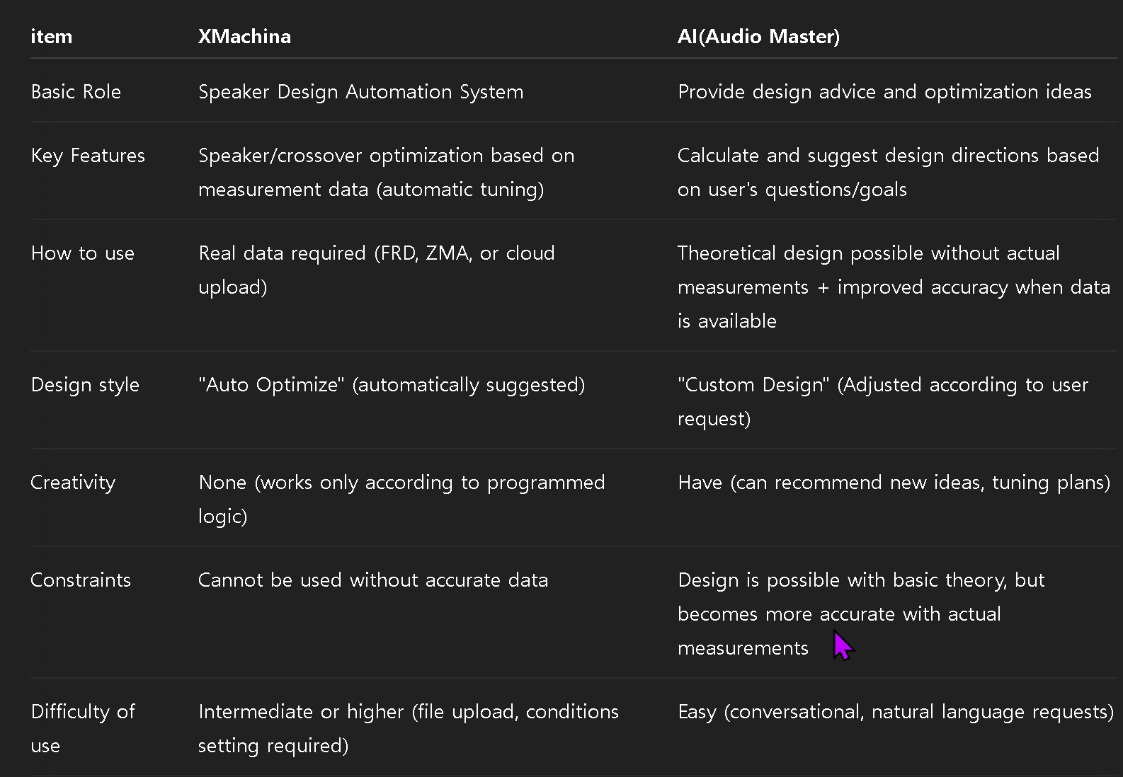

AI may be better than nothing, especially if the user has not the slightest clue about how loudspeakers work.When designing a speaker network, what do you think about using XSim or VituixCAD compared to using AI assistance?
XSim and VituixCAD are excellent for precise simulation, while AI can suggest design directions, ideas, and optimizations.
I am not familiar with XSim, but VituixCAD is great to process and predict the electroacoustic outcome based on real-world measured data from the loudspeaker drivers. My personal gripe with VituixCAD is that the underlying physics and mathematics are sometimes not documented in full detail, so it can be hard to really understand what the output means (or what it does not mean). Back when I heavily relied on VituixCAD I sometimes had to write my own code to reverse engineer the output of Vituix.
The kind of results inferred here from AI might be better than nothing, but bluntly, it's still junk. Which I appreicate isn't what the OP wants to hear, but the tables above are 90% twaddle, which isn't exactly a good start.
AI models are extremely powerful tools -providing they're used in the right way. For a field as complex as loudspeaker design, that tends to mean what they're actually best adapted to is crunching numbers to very specific questions in order to free up a designer's time so they can concentrate on other areas. But that requires a fair amount [or a lot] of experience on the part of the user. Ironically enough, what they're least suited to is providing useful answers to very basic / general questions / requests from people new to the hobby, because by & large, the questions are so over-generalised the systems simply have no facilities for proper answers and what you end up with is an electronic form of fudged hand-waving.
For example, to the best of my knowledge, at the current state of play, none of the AI systems, even if they suggest something that on the face of it looks sound can actually design a decent speaker from scratch. They don't have measured FR, phase & impedance responses, and can't take generic ones from elsewhere and process them for a relatively accurate simulated value. I've yet to see one come up with an LF alignment that isn't either misleading, or based on some very basic formulas culled off the 'net with no account given for conditions. They can't design a proper filter either, because they have no [under these conditions] responses to work with, and rarely have the programming to work out how to manipulate the responses in a desired way -as a result, when asked basic questions, they typically churn out some variation on a stock electrical circuit assuming static impedances & with no account given to the actual frequency & phase relationships. If you ask it, it may come up with a bit more electronic hand-waving about 'needing to take careful measurements' [QED] or 'experiment' etc.
Which is a slightly abbreviated way of saying: yes, it's better than nothing, but if you really don't know anything about loudspeaker design, want to build something and don't want to spend a lot of time learning about the design processes themselves, the best solution is to build a high quality, proven existing design or kit that suits your requirements from a reputable company or designer. It will save a lot of grief, and give much better results.
