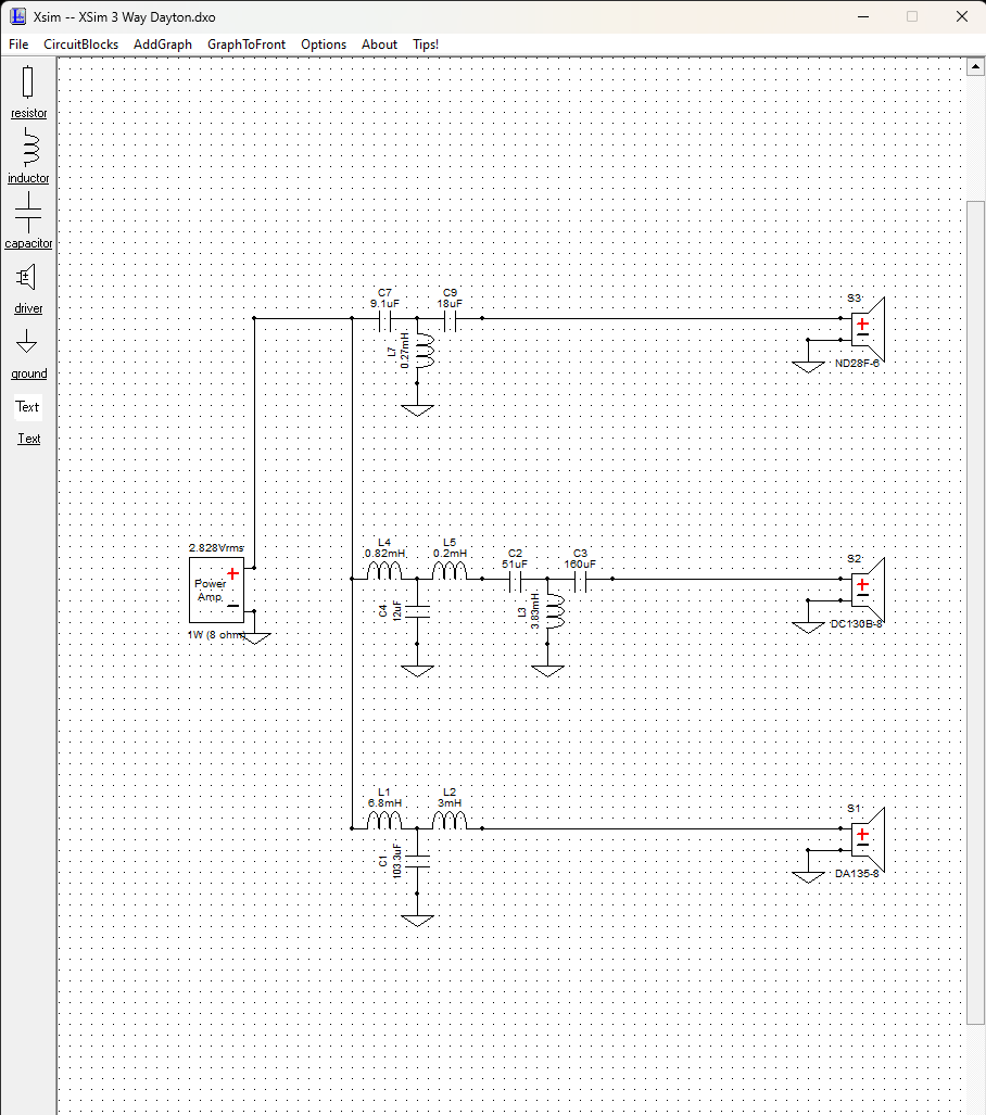

Ok well i feel quite dumb about this but literally been banging my head against the wall with this issue for days now . Just got into xsim and trying to practice with Dayton FRD ZMA files whatever i do the frequency response graph on the software doesnt change beyond initial FRD ZMA loading of two drivers data. I have tried to copy whats in tutorials tried various drivers but no value change of any inductor/ capacitor does not change the frequency response in software. Im not an electrical engineer but i have followed simple tutorials from youtube and still same issue. same in vituixCAD.
You have both the inductor and the capacitor shorted! Notice the straight wire right between the terminals of either.
Maybe you just placed the parts on the exisiting connection. This does not automatically connect them, you must route the connections freshly.
thats it ! cheersMaybe you just placed the parts on the exisiting connection. This does not automatically connect them, you must route the connections freshly.

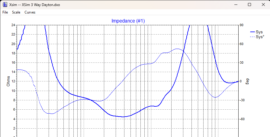

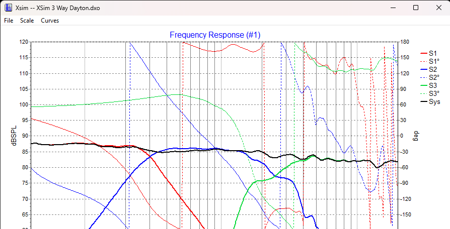

Using XSim for the crossover. Got my head around the basics, but the fine tuning is eluding me. It's not the ugliest frequency response graph I've come across, but nor is it the smoothest. My choice of drivers obviously plays a role here, but I want to put it out there, have you guy's evaluate and recommend improvements.
I've attached the XSim file for evaluation.

You might start by turning off phase for the system response and turning it on for the separate plots.

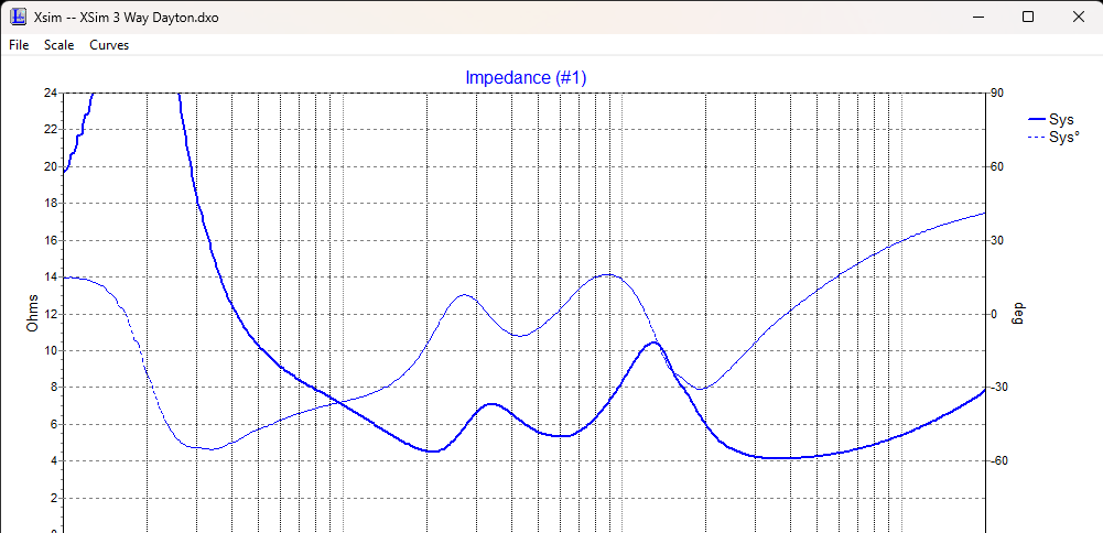

I didn't include them originally because it's where my understanding declines rather rapidly, but more than happy to include them if it helps others to evaluated my progress.
So should I just give up on the idea of diy and buy a pair of speakers? I like to make stuff, have some vintage HiFi components and wanted to do something different.

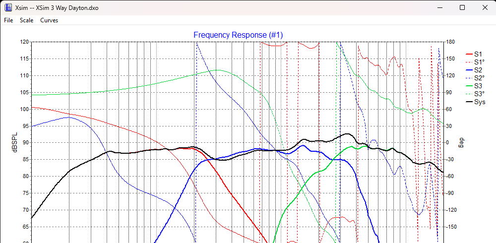

Nice work SB, I would try to tune the overall balance so that there is about a -3dB to -5dB right-downwards tilt of the overall response from 100Hz to 20kHz for a more pleasing sound that won't sound fatiguing after an hour. This response curve is sometimes called the "Harman House Curve" - developed by Harman (JBL et al) through much in-house study. I also find that it makes for a pleasant sounding speaker. Speakers voiced for a "flat" response can sound harsh after some listening time. It is personal preference how much tilt you like and some people don't have any and aim for flat "monitor" like response.
Cheers xrk, you sent me down a rabbit hole re responses, had always assumed flat was the goto, but it's a complicated subject, very dependent on equipment and room, but theoretically I like the idea, as I lean towards the low and low mid frequencies, so this approach seems to fit well with what I want to get out of the speakers. Having said that, I'll probably build two prototypes, flat vs hhc, the deciding factor being my ears 🙂

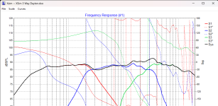

The latest FR graph relects your thoughts, about a -5dB tilt, and I've cleaned it up somewhat, but I won't get too excited until you guy's give it your stamp of approval, or if it's not quite there yet, be clear in the advice moving forward, as I'm really at the limit of my knowledge here, my brains about to explode :I
If you manage to pull this off in the real world you have accomplished no small bit of crossover work. The only things you should be chasing now is off axis horizontally and vertically (vertical is not as much of a worry as long as you are simulating it correctly).but I won't get too excited until you guy's give it your stamp of approval, or if it's not quite there yet, be clear in the advice moving forward, as I'm really at the limit of my knowledge here

In general terms, it turns out that, not unexpectedly, a flat, uncolored on-axis response is desirable, and the work of Toole has supported this. Some relevant details are provided in an Open Access journal paper, The Measurement and Calibration of Sound Reproducing Systems....re responses, had always assumed flat was the goto, but it's a complicated subject, very dependent on equipment and room, but theoretically I like the idea, as I lean towards the low and low mid frequencies, so this approach seems to fit well with what I want to get out of the speakers.
The importance of a flat on-axis response has been reiterated by Toole: "From the beginning, loudspeakers intended for sound reproduction have been designed with the goal of a flat on-axis frequency response so that the first sound to arrive is an accurate representation of the spectrum of the recorded sound. Double-blind subjective evaluations of loudspeakers conducted by the author and his colleagues for 35 years have shown consistent preference for those having flat and smooth on-axis frequency response, accompanied by well-behaved off-axis response—i.e., a smoothly changing or constant directivity index."
Toole also noted that "the direct sound has a high priority in perception, establishing a reference to which later arrivals are compared in determining such important perceptions as precedence effect (localization), spatial effects, and timbre."
The –5dB tilted on-axis response that you have achieved would typically be the target for the in-room response of the loudspeaker. This takes in the effects of early reflections and the directivity (directionality) of the midrange and tweeter loudspeaker drivers. I would expect the present design iteration to produce a sound that is quite lacking in high frequencies, with a more distant presentation of voices.The latest FR graph relects your thoughts, about a -5dB tilt, and I've cleaned it up somewhat, but I won't get too excited until you guy's give it your stamp of approval, or if it's not quite there yet, be clear in the advice moving forward, as I'm really at the limit of my knowledge here, my brains about to explode
You have succeeded in creating a crossover that matches your desired target-response curve. Hence, I think that it won't be too difficult for you to revisit the design and aim for a much flatter on-axis response. I look forward to seeing your results if you decide to do so.
If I may make a small suggestion, I'd like to see the frequency labels shown on the plot. It makes it a bit easier to get one's bearings when looking at the presented results.
