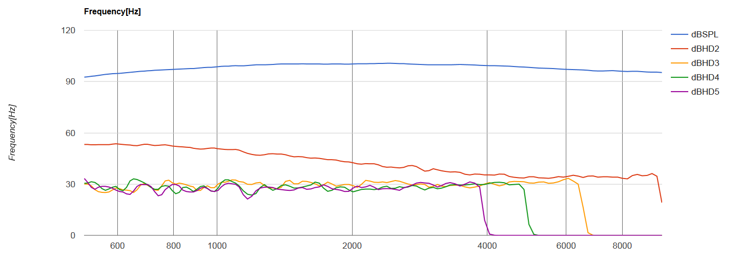

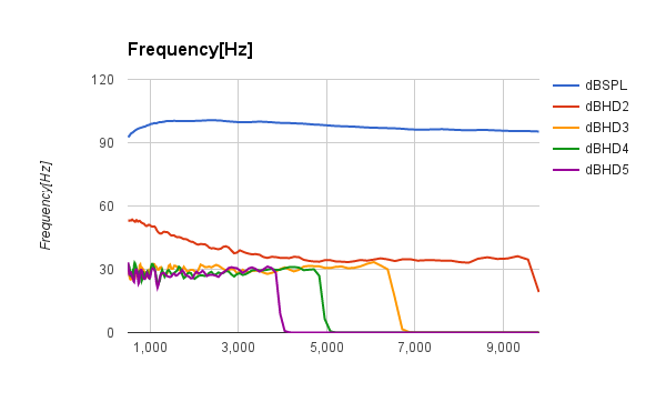

The curves in Scanspeak datasheets are very accurate IMO and are well-suited to be used in a simulation. However your results in post 1 and 3 unfortunately are wrong. I assume there's no valid phase data in your zma and frd files.

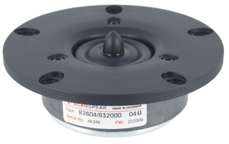

The R2604/832000 tweeter is the Scanspeak version of the well known Vifa XT25 ring radiator. Distortions rise dramatically below 2 kHz, hence a crossover at 2.5 or 3 kHz is more appropriate. But a tweeter that allows a 2 kHz crossover would be even a better solution.

Did I make an error? I've been looking at the Scan D2604/8330 and referring to it in my posts. If so, Rich, you'll need to ignore my posted info about it. My bad.
Mind you, it'll work pretty nicely in combo with a 6.5" woofer.

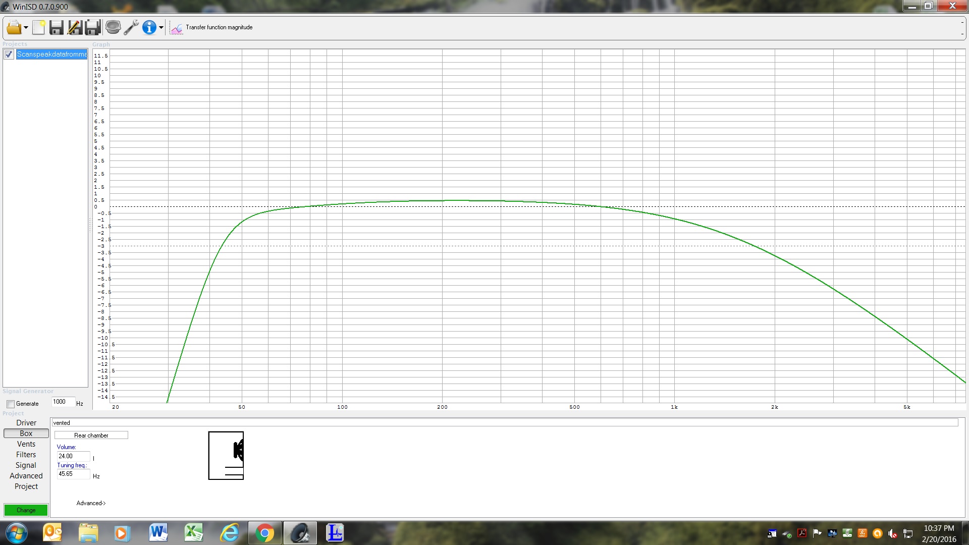

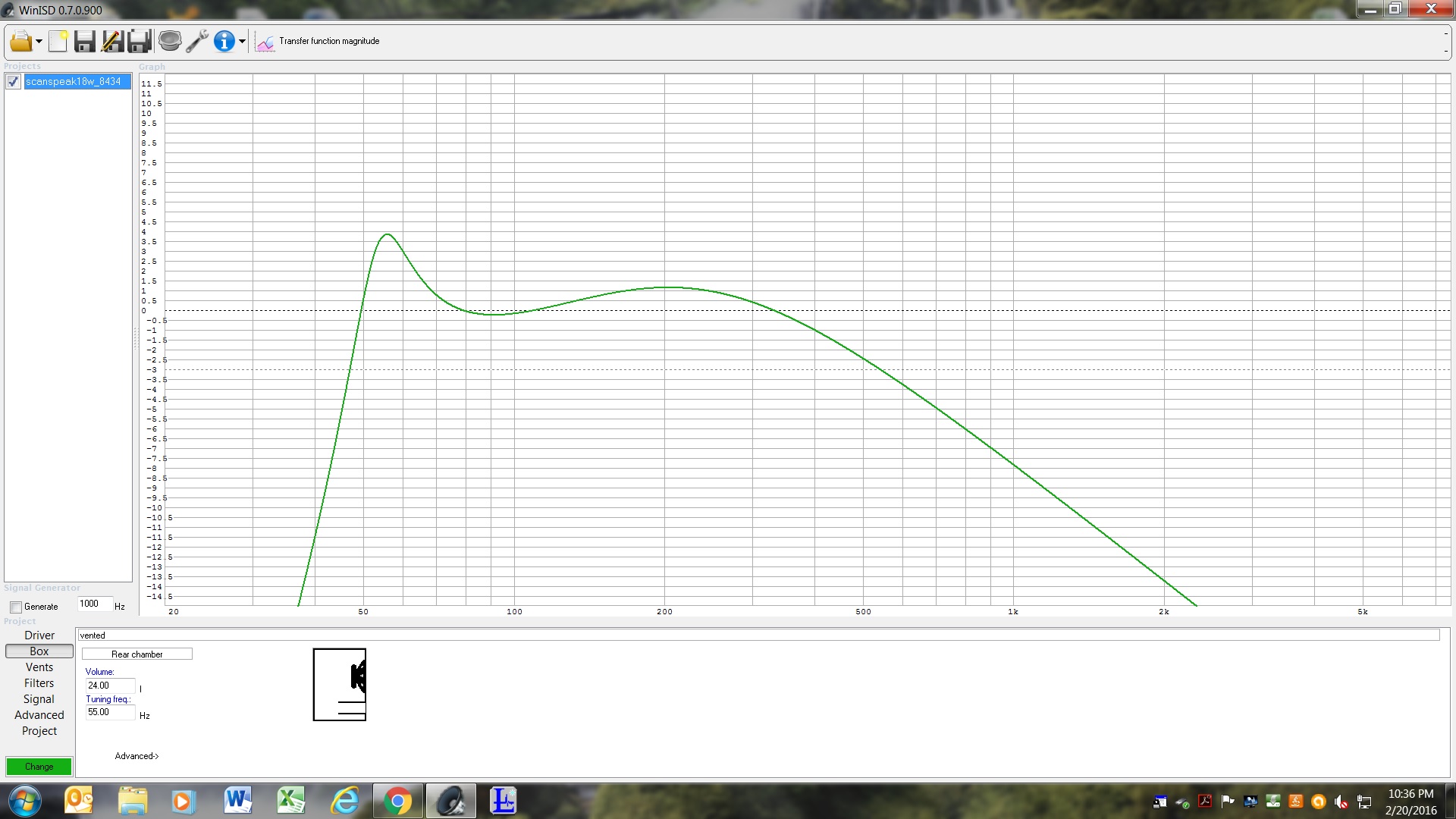

I may need re-evaluate my woofer choice. If you don't mind take a look at this screen shot from WinISD. This is with the Scanspeak Ts parameters from Zaph's blog. His numbers were much different then manufacturers data. I will also attached the one using Scanspeak published data. Thanks once again!

The distortion isn't bad, by the way, it's just not great. It is better crossed over at 2kHz than below that.

If in doubt, Madisound's recommendations seem based on real world drivers, but no guarantees.
Is it a big deal for you? I mean, have you already committed to a certain cabinet, or is it that you are afraid of building the wrong one? If the latter, I'd either go with Zaph's or measure with DATS for $99.

Don't rely on SPL tracing alone, and especially don't rely on manufacturer's T/s specs. I think ScanSpeak puts the interns on them, they're never even close.
So far, my own measurements on Scan Speak drivers always gave results that were consistent with those in the manufacturer data sheets. As far as I can tell, data measured and published by test magazines (e.g., Hobby HiFi et al.) also tend to find Thielle Small parameters that are consistent with manufacturer specs.

My understanding of the D2604/8320 is that it is indeed a good tweeter but like Dissi said, it's best used above 2000Hz.
IMO the D2604/8330 would be a better choice as well as any one of these:

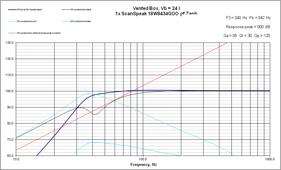

If your cabinets have an internal net volume of 24L, I don't think you have to worry about changing your woofer selection. Either set of TS parameters can be made to work in that volume but what you'll need to do is play around with the port length to get a tuning that you are satisfied with. Attached is what Unibox shows with Zaph's parameters in 24L and Fb of 42Hz with a port 2" x 4.75". F3 is 40Hz. And that also shows you the max SPL for 1 driver at 1m before xmax is exceeded with content above 40Hz.

Nice!
Thanks Erik. That looks like a solid performer.

I think so, but given the distortion below 2k is mostly 2nd HD I think you could cross it below that with good results. I noticed Gravesen does just this in a couple of his designs.
