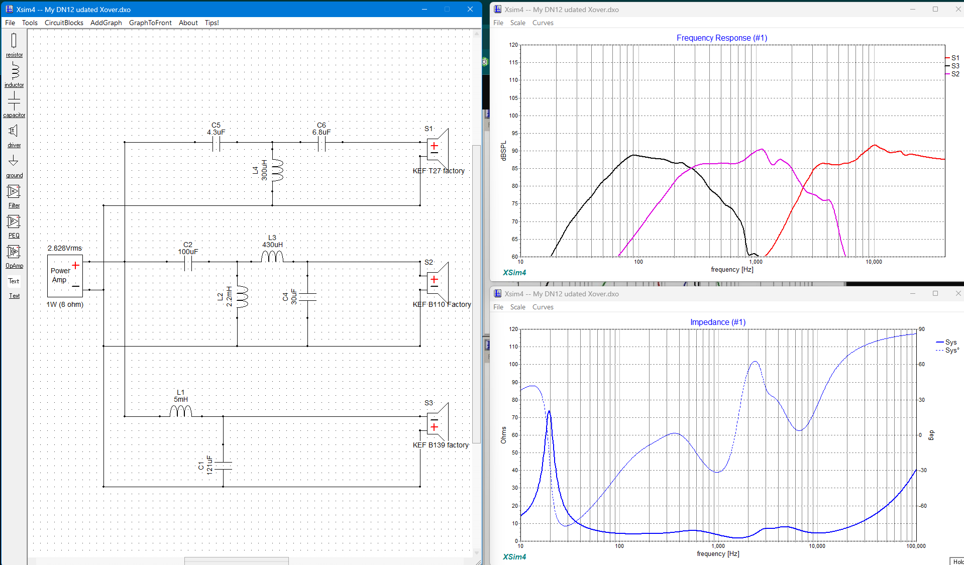

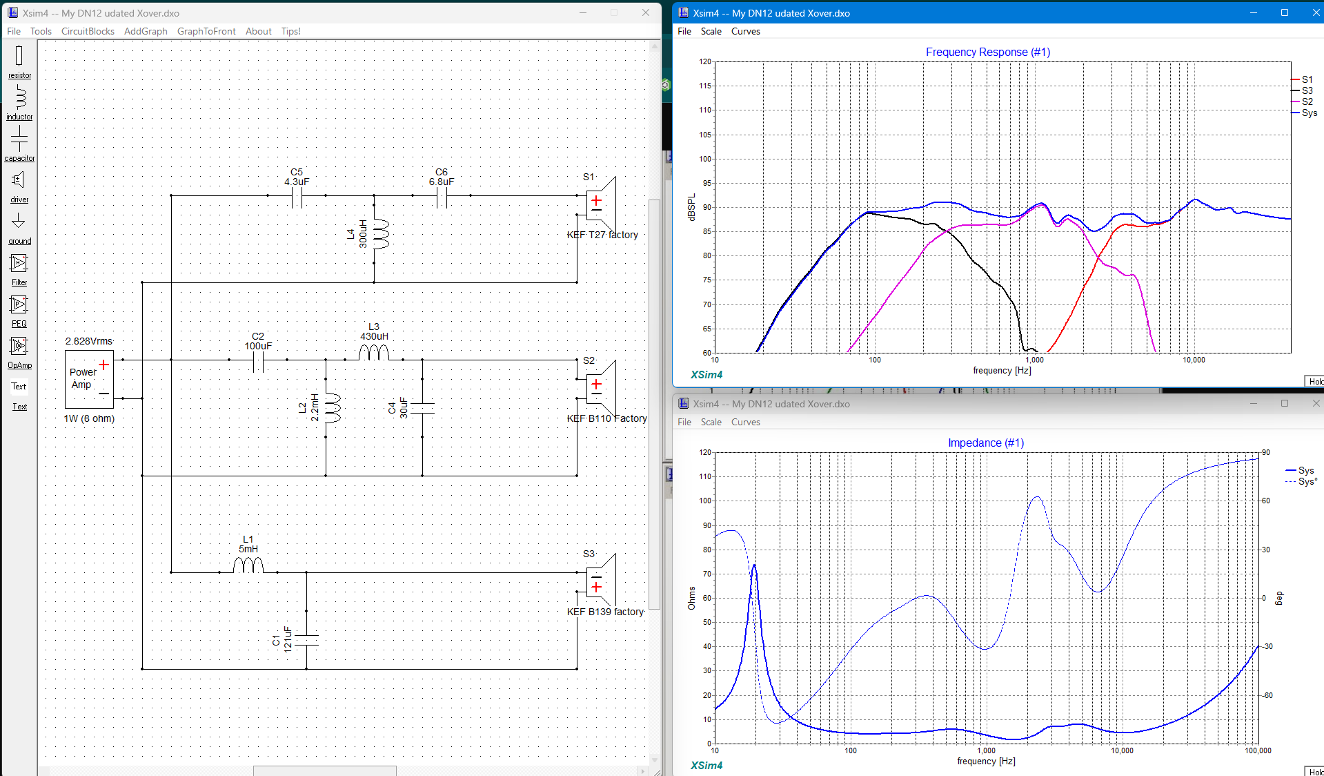

I am in a similar situation and i am brand new to this, i have only just started playing with Crossover sim software any pointers would be appreciated. I have some Kef Concertos Sp1004's as well and i've replaced the crossover caps and they sound ok maybe a little bit brighter than the original but i have also got hold of another set of DN12's i would like to experiment with. i've been playing with the simulations on here and looking at the spec sheets of the three drivers T27,B110 and B139. can someone have a look at this sim and tell me if it looks ok or am i miles away with the frequency response and the schematic? I basically have tried to get the crossover points of the speakers at the frequencies recommended in the data sheets. I was ok following until there was talk about phase of the speakers changing the FR. I was also confused why the T27 had the phase inverted compared to the original Xover diagram schematic and not sure why they did that. In my sim i inverted the phase in the woofer instead and changed a few values around. Thank you for your consideration.

What are you doing, modelling the old crossover or making a new one, and what is your purpose?
You say the change in capacitor makes it bright, try increasing the series resistance to compensate your change from the original.
You mention phase but you need to enable it - https://www.diyaudio.com/community/threads/xsim-configuring-the-plot-window.406106/

i have two spare DN12 crossovers and looking to experiment with but before buying any components i was having a play with the sim software. I've used the concerto complete crossover file from on here to start with. The crossovers in my speakers have just had the caps replaced with new ones according to the original schematic. The spare crossovers i have i just want to play with and see if i can improve the sound if possible. They speakers don't sound bad but ppl have upgraded the crossovers and thought i would give it a go as well.
If you're new to this you might find there is a fine line between crossing and voicing. It's difficult to equalise by changing crossover components without changing the blend between the two as well, unless you know what you're doing.
This leaves the question of which it is you want to change. Perhaps you could mess around with an equaliser first. This will serve to teach you what remains as an acoustic issue since you'll have difficulty equalising those.
