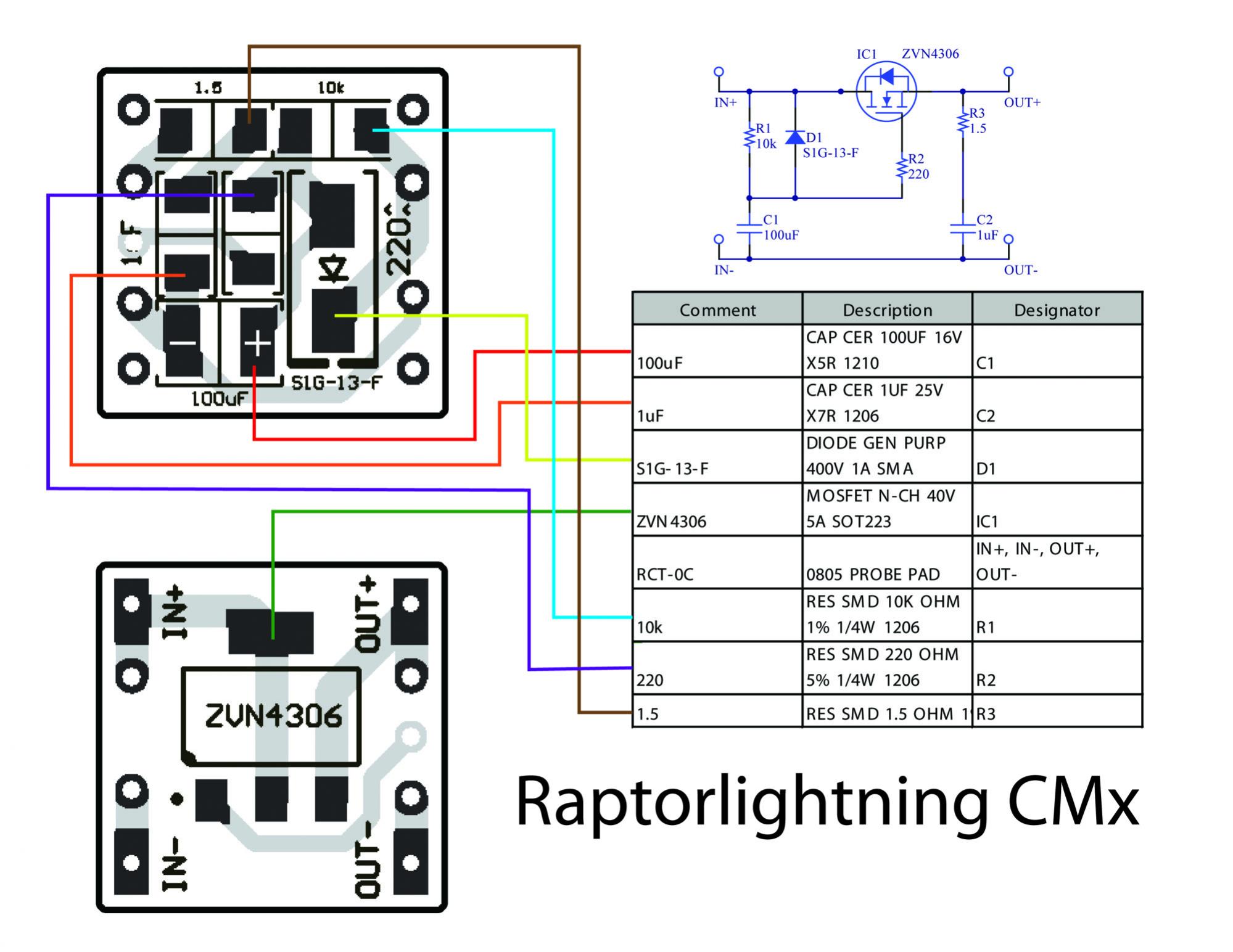

Trying to get started on the Raptorlightning Cap Mx for my amp. The words printed onto my OSH Park PCBs are absoluetly tiny and hard for me to read. That, plus the fact that one pair of pads isn't labeled, led me to make this little assembly roadmap. I believe the unlabeled pads are for R2.
I tried to deduce the positive and negative pads for the 100uF cap as well, by looking at the board design and the schematic, and I labeled those in the image. This is important for me, as I am using a polarized electrolytic cap here and I don't want to blow it up. Noob alert.
Buzz, Raptor, or X, can you confirm that I got the polarity right?

yep, stellar, that is the correct polarity (same orientation as I used anyway - we could both be wrong, but it works)

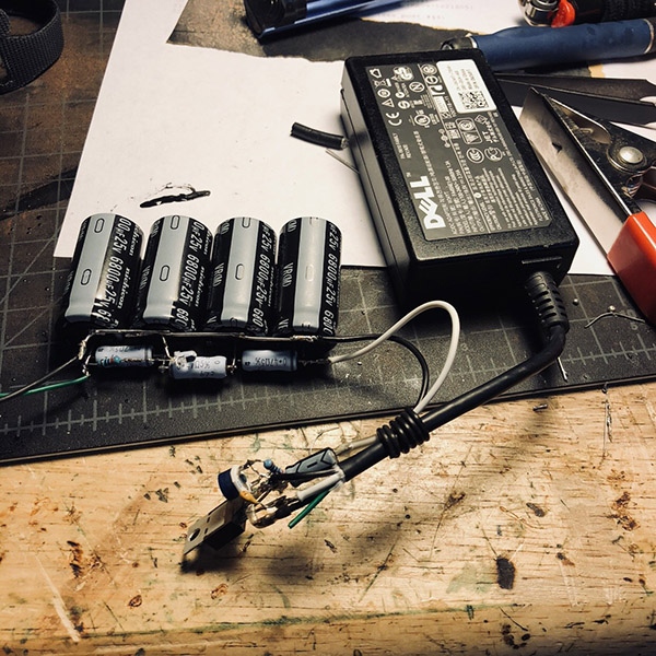

Hoping to make a CRCRCRC soon. Aatto, I was looking at the photo you posted of yours. I can tell you have three identical resistors soldered between the positive cap terminals. But then there is something else down there crossing over to the negative side...hard to tell from the photo...is that just a tiny resistor in series with a LED to serve as your power indicator? Just making sure I'm not missing something important.
Looks like a 1k in series with LED for power indicator. 1k is a bit too small for my taste as that is 19mA at 19v. About 12k to 15k is a few mA, still plenty to give light and not burn out the LED prematurely.
you got it, was just a test run LED, already removed it .
Lol you have eagle eyes!
Brown Black Black Red Brown on Blue casing = 1k 1% metal thin film
