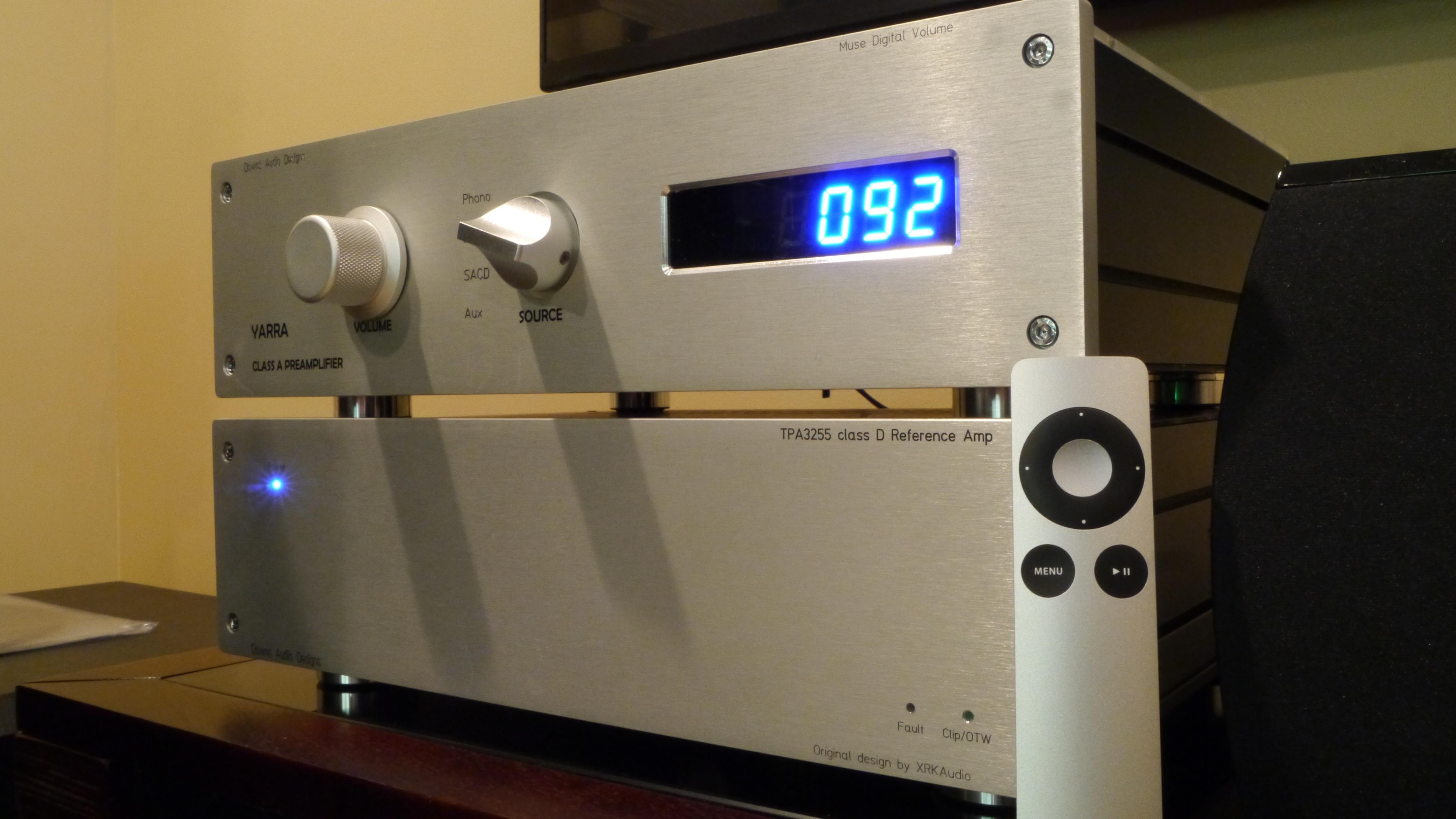

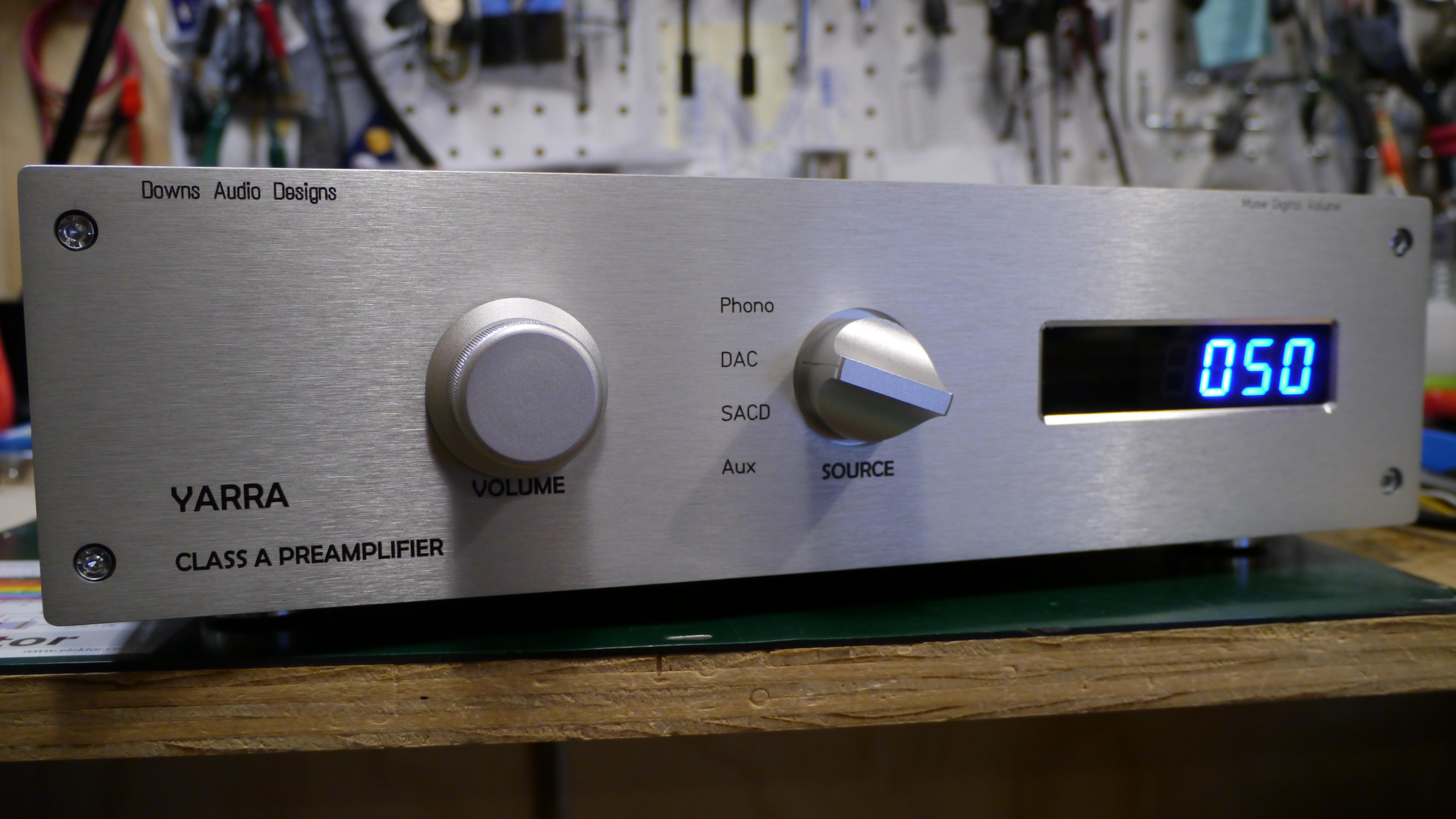

Here is perhaps the best example of my TPA3255 paired with an XRK audio Yarra preamplifier that member Redjr made with a remote controlled volume. Beautiful work!
The YARRA Preamplifier/HPA for Melbourne DB Group Buy
