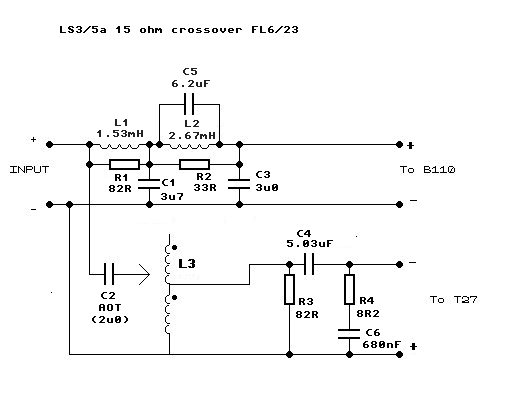

I have made a couple clones of these lovely 44 year old speakers, because i love them so much. but my originals have lost the tweeter output. I tested the tweeter and all is good. This particularul 15ohm Xover has a history of one of the resistors getting too hot and indeed, a visual shows some good darkening of the PCB as it rests just on top.
I swapped out the Xovers and all is good so how does one test a Xover without ruining the original from a value perspective? AND, without disconnecting a single leg of any passive component? any secrets?

Since you have them out, you could try measuring across the burned resistors. However I couldn't be sure unless you either post the schematic or pull the components.
Each may have different effects. If L3 or R3 is shorted you may have a problem. At most you'd measure the resistance of the coil so it will be close. Compare to the internal meter resistance to be sure.
For that we need to know what the meter reads for resistance when..
1. Shorted,
2. Across R3.

Normally.. Well, you could measure C4 as open without removing it, you could measure R3 as shorted but you couldn't measure it as open. So each one depends. On the other hand there's more than one way to measure, say, if you could run a signal throught it.
If unsure, lifting only one leg is enough.
