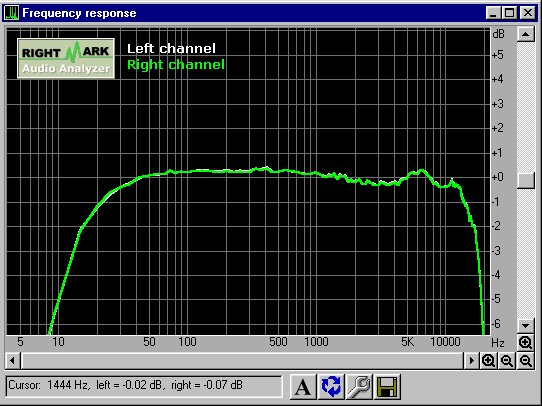

Anyway, i ran that RMAA program and the graph response should be below,
the response dosent really look too good, it seem as though it dosent make it to 15kHZ. I is however just the onboard sound card and not a PCI slot type.

Your sound card is better than my sound card, which isn't saying much, LOL.
Overall, I would say your sound card is pretty good. You are -1.5 dB-not -3 dB-from 19 Hz to 15,000 Hz. Pretty good, I would say.
I wonder why we were getting such outrageous readings when we tested your AR tweeters? Gad, could your microphone have been that bad? Or your AR tweeters?
One thing, you might want to check your "multimedia" in your Control Panel to make sure there is no boost or anything in the mic input. Mine has a selection in the mic section for bass boost-not in the Line In section.
Anyway, if you have a mic handy-any mike-check some selected tones from 13,000 Hz down to 1000 Hz through your tweeter. You can see that the tweeter should be flat down to 1300 Hz or so, then goes down. Let's see what the mic reading is.
You can either use the oscilloscope, or measure directly from the mic leads with your digital multimeter. When you measure, see if you can get a 2 digit reading on the multimeter. Your tweeter should be able to take up to a 4 volt tone from 13000 Hz to 1000 Hz. Let's see how flat the mic is.

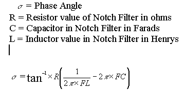

Pinkmouse:
Thank you so much for the formula for the notch filter. Man, you are one precise guy-you take the value for 2 pi out to four decimal places! 🙂 🙂
One thing, though. Looking over the equation, I see that the formula includes F or Frequency and C for Capacitor value. But the notch filter also includes an inductor, which is normally labelled L. Yet the formula for the notch filter contains no mention of L for inductance.
Since the inductor has just as much to do with the phase angle as the capacitor, are you sure there is no value for "L" in that equation? Or has the value of L already been converted into terms of F and C in the equation as written?
Just asking before I start figuring, (my math skills are limited enough as it is, LOL). 🙂 🙂

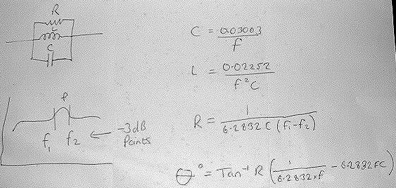

oops...
The bracketed bit should be:
(1/6.2832FL -......FC)

Now, one more thing. I take the value of this equation for any frequency that is whithin the notch filter's range, correct?
I can get the phase angle of any woofer at any frequency just by plugging the Thiele small parameters into Subwoofer Simulator, a freeware program written by F4ier, a member of this forum.
Once I establish the phase angle for the frequency selected before the notch filter is added, do I just add that value to that value from this formula? So if the reactance is -20 degrees at the selected frequency before I add the notch filter, and the equation yields a value of +15 degrees with the notch filter, do I have a total phase angle with the notch filter of -5 degrees?
Anyhow, is the equation written correctly below?

Yup, Wiz, that's the one!
After thinking on this for a while, I'm not sure if we need to worry about phase angle too much, or even sorting out that peak. It might be worth while for a first cut just going for a 3k crossover with a standard second order Xover, or at least waiting on the in box measurements of the mid/bass driver, just to seee how bad it is in reality.
The reason I thought this was that I was going through a load of old back issues of Hi-Fi mags, and many commercial speakers have much worse dips and lumps than this, so although it may look nasty, it may not work out in reality to be so bad.
Hmmm, I don't know...
Regarding Pi, no i was just a sad kid!😀
AFAIK- the phase change is maximal at the centre frequency of the filter, and alters in proportion to the slope of the filter. As for the rest, yes!🙂Now, one more thing. I take the value of this equation for any frequency that is whithin the notch filter's range, correct?
