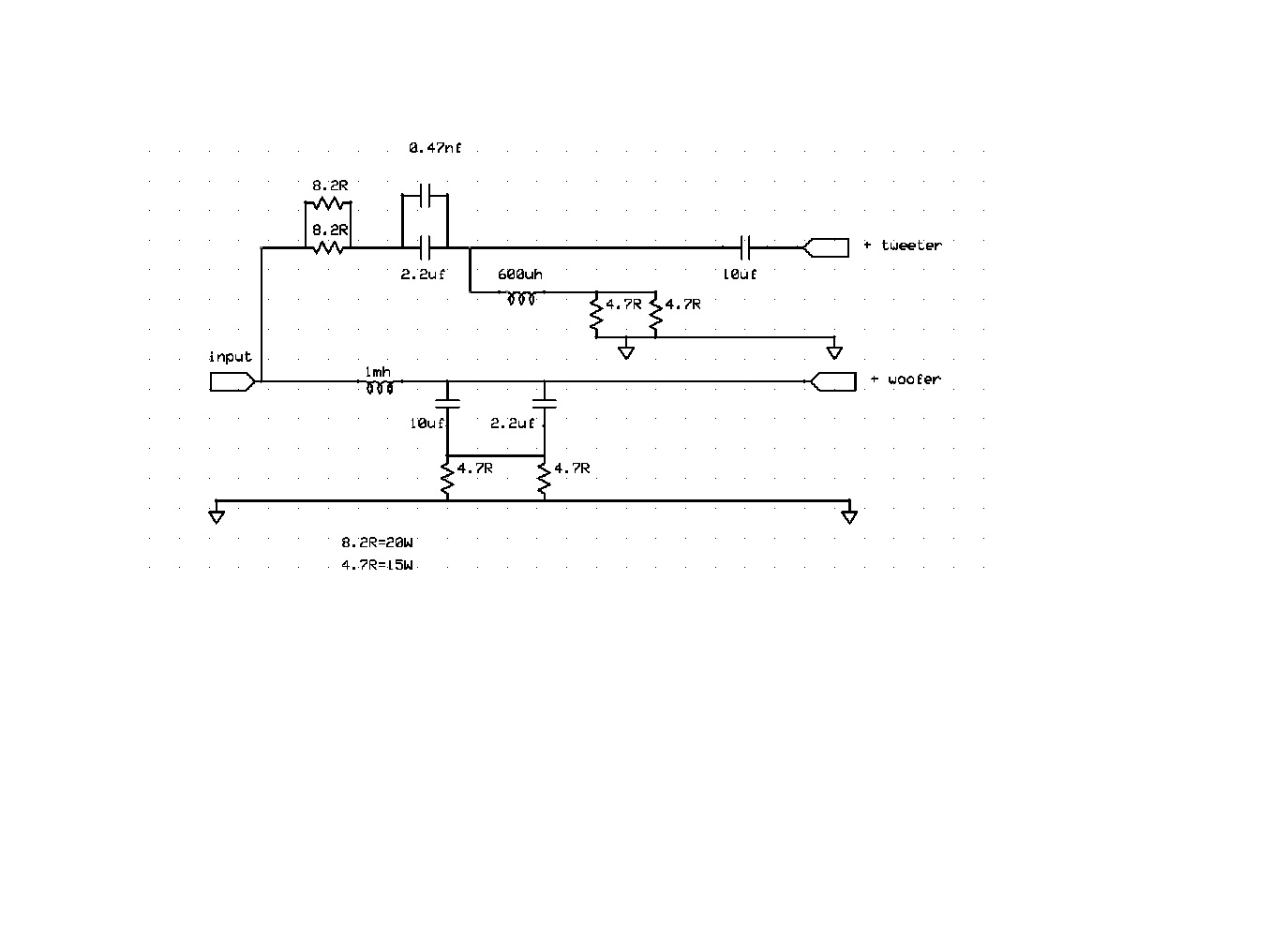

I can roughly understand how this crossover works while design looks a bit unusual found inside a Chinese pro speaker that actually sounds extremely sweet
Can somebody take a look at it make some calculation and share his opinion ?

It's not unusual, it just looks that way because of making values with multiple parts.
Quasi-third order on the tweeter, quasi-second on the woofer, very common and reasonable.

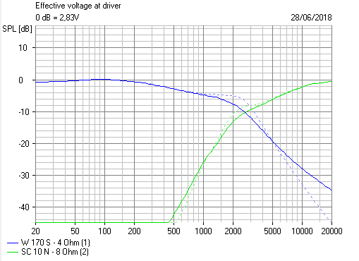

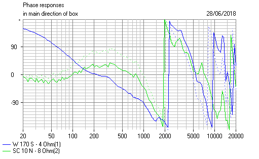

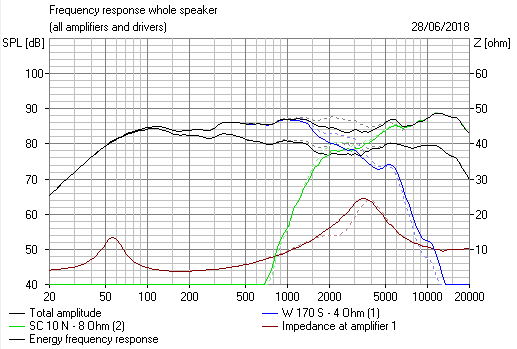

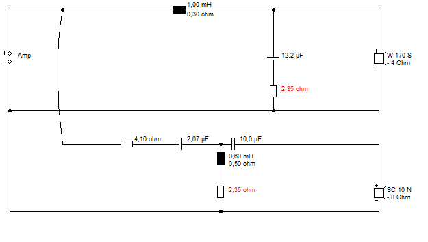

The circuit is as Boswald says. A 4 ohm near 12dB/octave bass circuit and a 8 ohm 18dB/octave tweeter by the look of it. It works reasonably well with a regular 4 ohm 170mm bass in 20L box and 25mm 6 ohm 91dB tweeter.
The red resistors are a bit weird really. It works better without them in my sim with those two drivers. The dotted line when you skip them.

The resistors troubled me dont understand realy the reason but as said it plays very very smooth next to the cost of the unit
Hi Sakis.These resistors are changing the slope of the FR ,creating a mild depression between 1kHz-5kHz.To many people a ruler flat responce in this era makes the speaker's sound somewhat oppressive.It looks like you are one of them!

I have heard of what Paul Carmody calls the "flying squirrel", which jumps a gap in the midrange and is forgiving of terrible music recordings. Other people called it the BBC dip. But since we have NO IDEA what the speaker drivers are, everything is speculative. It is conceivable they have some awkward peaky driver response. Why the secrecy, Sakis? 🙂

Well in the first place i though that the resistors are there if the speaker is over powered to prevent coils from burning or share some current there
Still in the specific xover material used looks very good and beefy also so i cant be sure about that
Indeed the speaker sounds a bit edgy .... that will mean that there should be a bit of mid and upper mid less ....But that is just a bit so resitors might have something to do with this

The resistors are decreasing the slope of the rolloff, that's all.
Basically, the series components set the start, and the parallel components the rate of the rolloff.
They will slightly raise levels in the crossover region, apparently not needed with the drivers Steve simmed. But you can get the idea.
