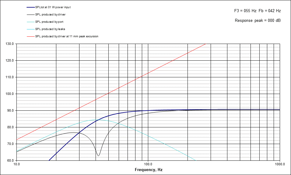

Wrong, I am forgetting nothing. As far as this is concerned we are simply dealing with a change in the effective Q of the relevant leg and an increase in the load impedance.
Effective Qes', i.e. Qes with series resistance R in the circuit:
Qes' = (2pi * Fs * Mms * (Re + R)) / B*L^2.
Thus effective Qts', i.e. Qts with series R in circuit becomes
(Qms * Qes') / (Qms + Qes')
Thus, a driver with, for example, a baseline Qes of 0.333 and a Qms of 1.981 has a Qts of 0.285
The same driver with 2ohms of series resistance in circuit has an effective Qes' of 0.428, an unchanged Qms of 1.981 and an effective Qts of 0.352 [nearly].
Whatever arm-chair conceptual influence Qes may have on the speaker box, the undamped driver resonance is a terrible thing.
Perhaps you could explain how an effective Qts' of 0.352 is underdamped, and, for example, the attached box alignment is likewise. None of this is new, surprising, news or anything else. It's been known and accounted for (and in some cases, exploited) since the 1940s in various ways. As noted, almost every loudspeaker will have some series R to contend with from wire loop & connection resistance / losses, + any passive components e.g. series inductors for passive designs, and these should be accounted for in a well-designed box / baffle alignment as a matter of course.
