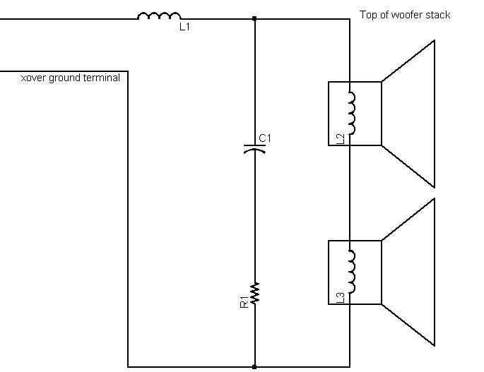

I've got a problem with the XO in one of the speakers I'm building (Magna Cum Laude's, design at Parts Express).
The Problem: When I turn the volume up on the amplifier (or on my computer), the amp's overcurrent protection kicks in and shuts it down.
This is the second speaker in the stereo pair. The first one seems to work just fine, so I'm pretty sure that there was an error in building the XO, or I have a bad component.

Ran test tones at max volume to determine which portion of the XO it was. A 50Hz tone reliably tripped the overcurrent protection. Suspect problem in bass unit.
Compared sound side by side with first speaker. Bass is significantly attenuated in second speaker. This may be a result of a different box stuffing material though.

XO wiring had one error (I think). The capacitor in the woofer section was wired incorrectly. Fixed this, but still no change in the OC shut down problem.
New Test: Took wires directly out of amp, and wired them after XO (i.e. XO still attached, but amp signal bypassed directly to woofers). OC shut down still occurs.
Woofers are dual 8 ohm voice coils. The voice coils on each woofer are wired in series, and the woofers are wired in parallel.

Minimize the number of possible problems.
1. Swap speakers, does the problem follow the xover/speaker or follow the channel? Next swap speaker cables, this confirms amplifier and or speaker cable is not the problem.
Now power down and disconnect speakers from amp.
2. Use Ohm-meter measure across woofers, from xover ground terminal to top of woofer stack, compare to other speaker. Also measure DC Ohms across xover input (disconnect mid/tweet for this measurement), again compare to good speaker.
3. If design has one, measure zobel network. Measure to verify that you don't have a bad capacitor. Again compare to good channel.
If this doesn't help, please post design or a link to where design can be found.

I re-read your post #4. If dual voice coils are wired "anti- parallel" DC will measure fine but it will seems as if it's an AC short. (The two voice coils act like a transformer)
I swapped speakers (switched L/R), but kept the same cables on each channel. The problem still occured. I unplugged the non-working speaker (meaning that the working speaker is now plugged into the non-working speaker's channel, and is using the non-working speaker's cable) and this resolved the problem.
Sorry, but I don't quite understand what "xover ground terminal to top of woofer stack" means...could you elaborate for me? What part of the woofer XO/driver system is the top?
There isn't a zobel network, but I'll try and check the capacitor in the XO.

I made a small sketch to illustrate the nodes I used in my post.
The basic idea is to isolate the various parts and thereby find the problem. The first pass is crude with few parts isolated, if this doesn't work, more and more parts must be disconnected until the culprit is found.
Please verify very carefully the connections to the dual winding on each woofer, I am guessing that this or maybe a shorted capacitor is your best bet.
It may also be possible that voice coils of one woofer is wrongly marked
Disconnect the woofers and use a battery to determine the right phase on each of the windings individually...when cone moves outwards you have + where its connected to battery +
