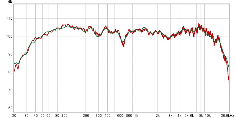

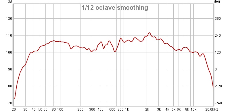

Heres a slightly better measurement I just did.. though phase seems to be odd to me the freq response is what I expected.If you've got some measurements for those I hope you'll consider posting them.
Used ARTA for the actual measurement with pink noise and a BehringerECM800 mic with a generic compensation applied.
Mic 1M from the Pyle612 horn with PDS221 comp driver
Although it says on the graph 33uF protection I just realised I actually used 15uF.. but the diff should be negligable.

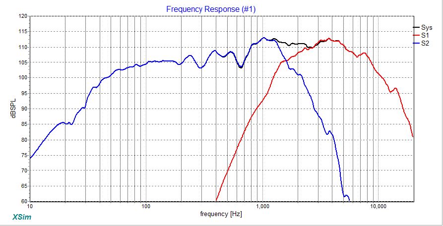

In case anyone is following along at home, the 2.25 uf cap that I used to bypass the BSC left me feeling like there was a bit of a notch missing. I increased the cap to about 3.3 uf, and things sound better.

One key part of the econowave crossover is a capacitor/resistor network that compensates for the roll-off at the high end so it makes the response essentially flat. IN THEORY the Pyle would work with this.. but the compensation needs a lot of head room (i.e. higher efficiency), which the Pyle at 102 dB just doesn't have compared to the Selenium @ 107 dB. With the fairly high efficiency PA woofers I couldn't get the econowave crossover implemented cleanly so the high end never sounded that great, and it seemed stupid to add LPADs to the woofers - so I ordered the Seleniums (which sound great!).

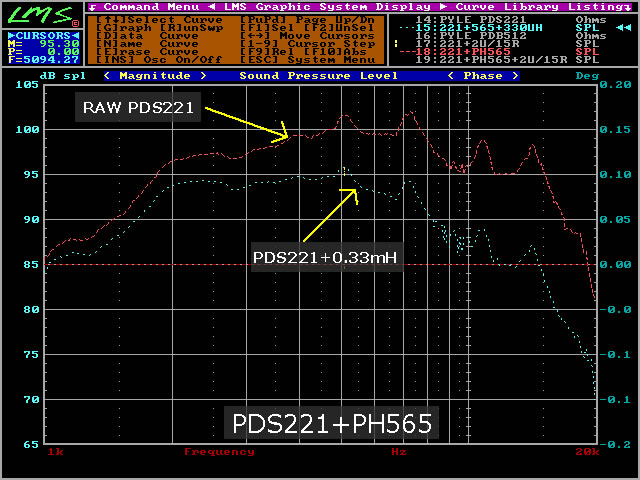

I have the PDS221 attached to a Pyle PH565 horn. With this combo, inserting a 0.33mH air core inductor in series with the PDS221 will flatten the response at the expense of some very high frequency roll-off.
More information at:

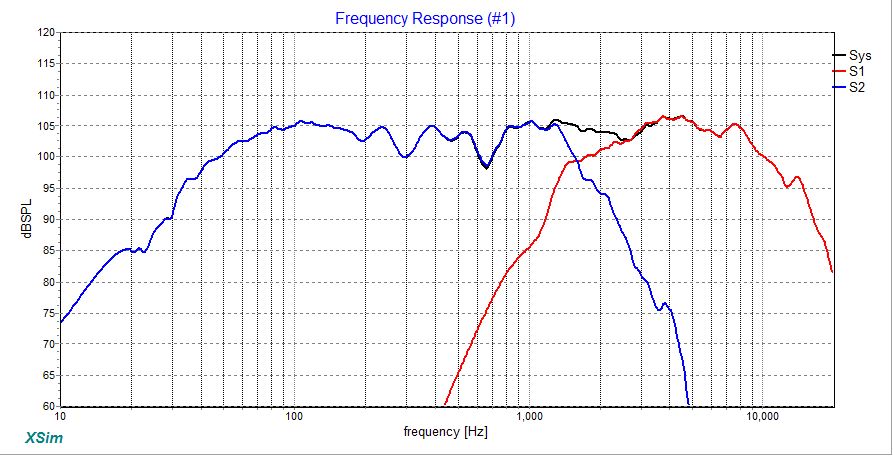

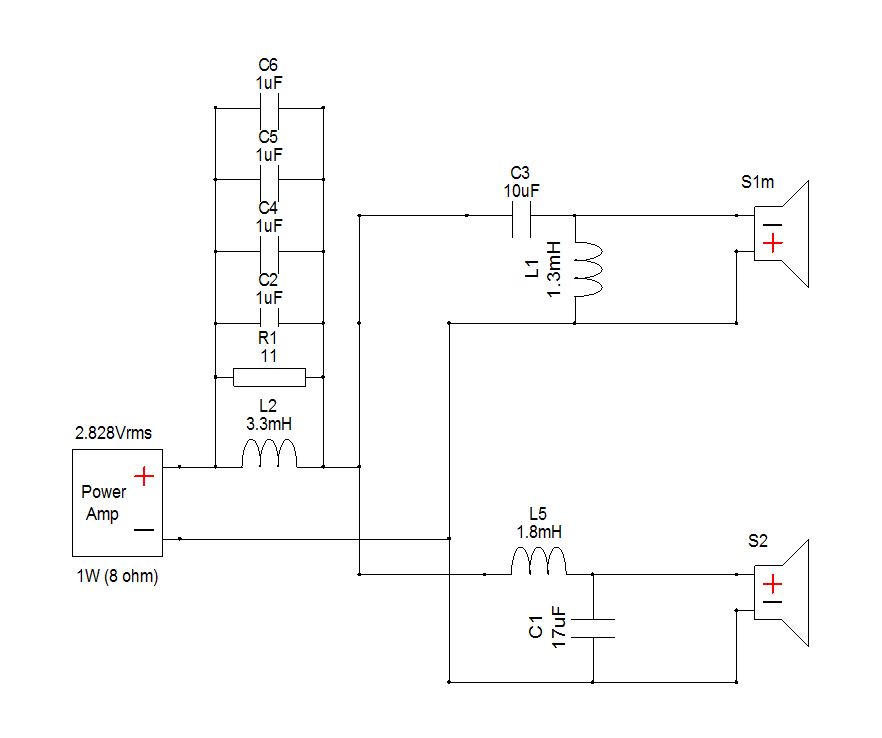

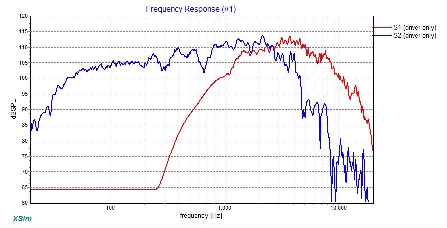

I've had these speakers out in my garage for a long time now. I've learned a bunch since 2010. So during the pandemic I decided to measure these speakers and do up a new and improved crossover. Probably nobody cares, but I wanted to document the changes anyway.
I have a dayton USB mic, REW to take measurements, and XSim to model the crossover.
I measured each driver with no circuitry independently, and then the two driven at the same time (by separate channels) from my test amp (tweeter measurements above 700 Hz or something I forget exactly). Measurements are ground-plane, taken on the sidewalk out front of my house. Mic distance is 2 meters, centered between the two drivers. I managed to get measurements that are free from reflection to relatively low frequency. The axis of the speakers points along the sidewalk, but the bass port hangs off into the grass, so measurements don't show quite as much bass as I think the speaker has. I think it's flat to about 50 Hz and at -3 somewhere in the lower half of the 40's.
Importing the woofer and tweeter separately and wiring them both up in XSim, and then importing the measurement of both drivers playing together allowed me to tweak the delay of the tweeter until the sim of both drivers together matched the recorded reality. The tweeter is delayed 4.71 inches by the depth of the wave guide relative to the woofer.

Here is how the speakers measured as I had built them prior to this redesign.
Both drivers have elevated upper mids, the BSC circuit wasn't quite correct to fix it because BSC wasn't the issue. Bypassing the BSC helped, but wasn't perfect... An exciting result, as it means there were improvements available. =)
