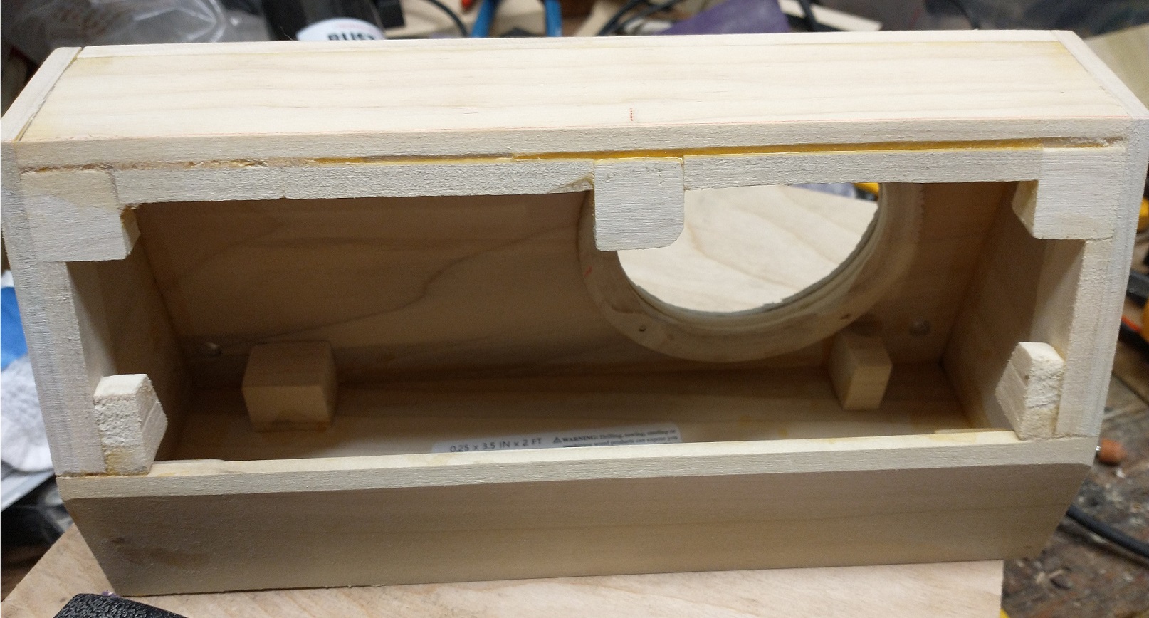

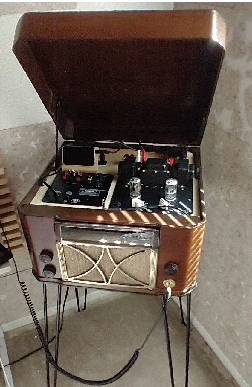

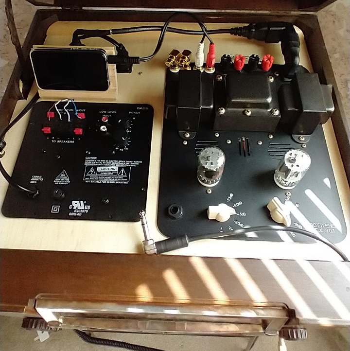

Using the info provided above I'm letting the box control the XO for the Scanspeak 10F.
Built into an Admiral tabletop record player cabinet bought on the Bay, the 10F is fed by a Bottlehead S.E.X. amp (2W/ch) and the TangBand flat 6.5 inch sub runs off of a 25w plate amp from PE. The ported sub box is lined with half-inch F13 wool felt and the sealed full-ranger is lightly stuffed with poly and lined with 1/4 inch F13 behind the driver.
My moderate CD collection and numerous digitized LPs are on the tiny FiiO M6. Karl
