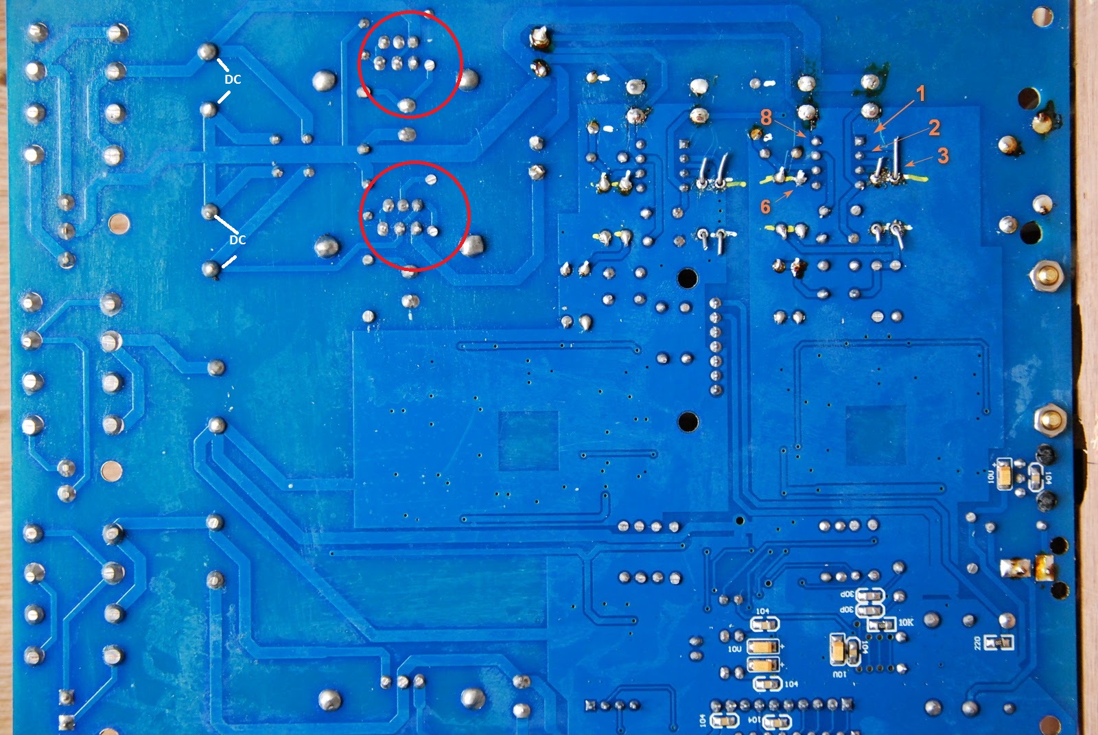

First put all 2 opamps out. Measure dc from rca gnd to all 8 dip socket voltages... So pin 1 xx volt. Then we are going on. And please measure dc on output of dac voltages before first and after first resistors... This blue 4 pcs that shows 10..11v dc.
Ok, here: 8-dip sockets:
1- 00.1V
2 - 06.3V
3 - 03.0V
4 - 06.9V
5 - 00.0V
6. - 06.3V
7 - 31.0V
8 - 00.0V
The resistor:
(10kohm) 06.5V (11kohm) 06.5V before the resistors
(10kohm) 03.1V (11kohm) 06.4V after the resistors

Pin 4 and 7 are totally wrong...can you please tell me why are 6 holes in regulator place...
make picture near regulator pins top side ...are they lm317..337?
underneath What is DC on both big capacitors?

No no not lying ones... That hiden under the heatsink. I see Mje transistor Cant be zero Dc because on opamp pin you have 31 and 6.9V. Press tips harder into solder and measure dc.
Near the heartsick 31.7V

If you have 54v and 30v your input transformer is not connected in 230 but in 115v. First solve this then we will check if anything is burned. So central tapes of input are tight together and not connected to no. Point other 2 one on phase one on neutral of power plug
And buy at least one ne5534 or tlo71 for 0.5€ to disclose opamp failure, because earlier-original JRC is dead if he became 31v on both rails. Can be that damaged opamp has also damaged regulator.
