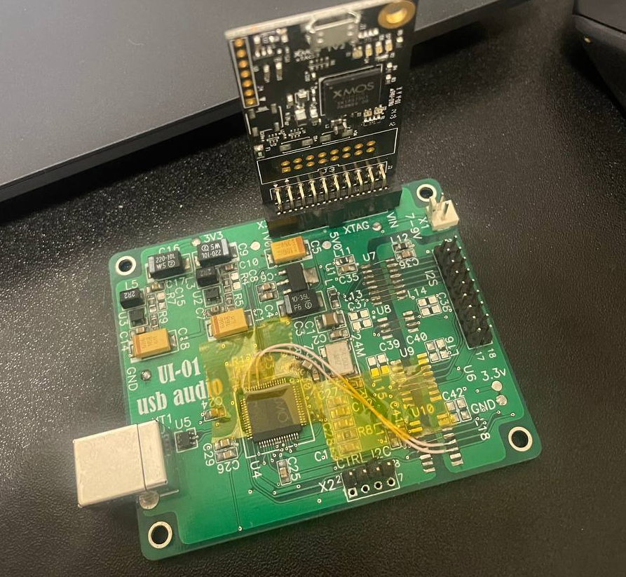

XMOS bridge between formats with ARC. Getting firmware into Amanero like HW.
