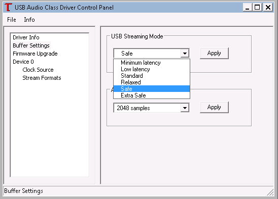

Hi Lorien:
I am sorry if the question has been already asked and answered but please help me understand a setting in driver's control panel
USB Streaming Mode
Minimum latency
Low latency
Standard
Relaxed
Extra Safe
Do these settings only relate to buffer size? Any effect on USB streaming/clocking? Do these settings affect jitter at all? Please write in detail.
nothing to detail, they are just different sizes of the setting for the same buffer. it will depend on your computer and what you are doing with it what setting you will need to set. they are primarily for recording, minimum latency might be used for live performance, where you need the 'instrument' to provide feedback or react quickly to changes you make, like a mixing console etc, relaxed may be used if you are recording with a DAW and need quite a bit of buffer to allow for processor intensive plugins
@ new2hifi: unfortunately I was hit by a dead silence as my email caught Ute in a short holiday. I'll resend my message hoping that it will do something but I do not have strong hopes on that as I'm too small for Thesycon to "see" me 🙂
I would prefer to send a 'viable' answer directly from one of Thesycon's employee rather than give mine based on presumptions because I do not have access to any code related to that control panel. But, as gusp said above (thank you), it does help you in finding the optimal settings for minimum latency while avoid drops in playback (highly dependent on your PC). For example I try to use the "minimum latency" option almost all the time but switch to "low latency" when my PC is not capable to handle all the related USB streaming due to other extensive tasks.
I hope it helps,
L
There's no problem at all still I do not like the idea that I cannot help you here as I wished to! Anyway, yesterday I sent another email to Thesycon asking the same thing but I was hit by a second silence (again) and I have weak hope that it will change somehow!
As for the BCLK question: 32bit per channel (from which 24 are used for now) * 2 channels (stereo configuration) * 192000 Hz (sample rate desired) = 12.288 MHz freq. I suppose it's in the limits 🙂
I hope it helps,
Lucian
