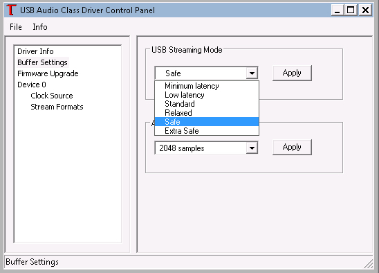

USB Streaming Mode
Hi Lorien:
I am sorry if the question has been already asked and answered but please help me understand a setting in driver's control panel
USB Streaming Mode
Minimum latency
Low latency
Standard
Relaxed
Extra Safe
Do these settings only relate to buffer size? Any effect on USB streaming/clocking? Do these settings affect jitter at all? Please write in detail.

@ new2hifi: I've forwarded your question to Thesycon as I don't know how that Control Panel was designed nor knowledge about how it works. I'll post their answer right after I'll get it.

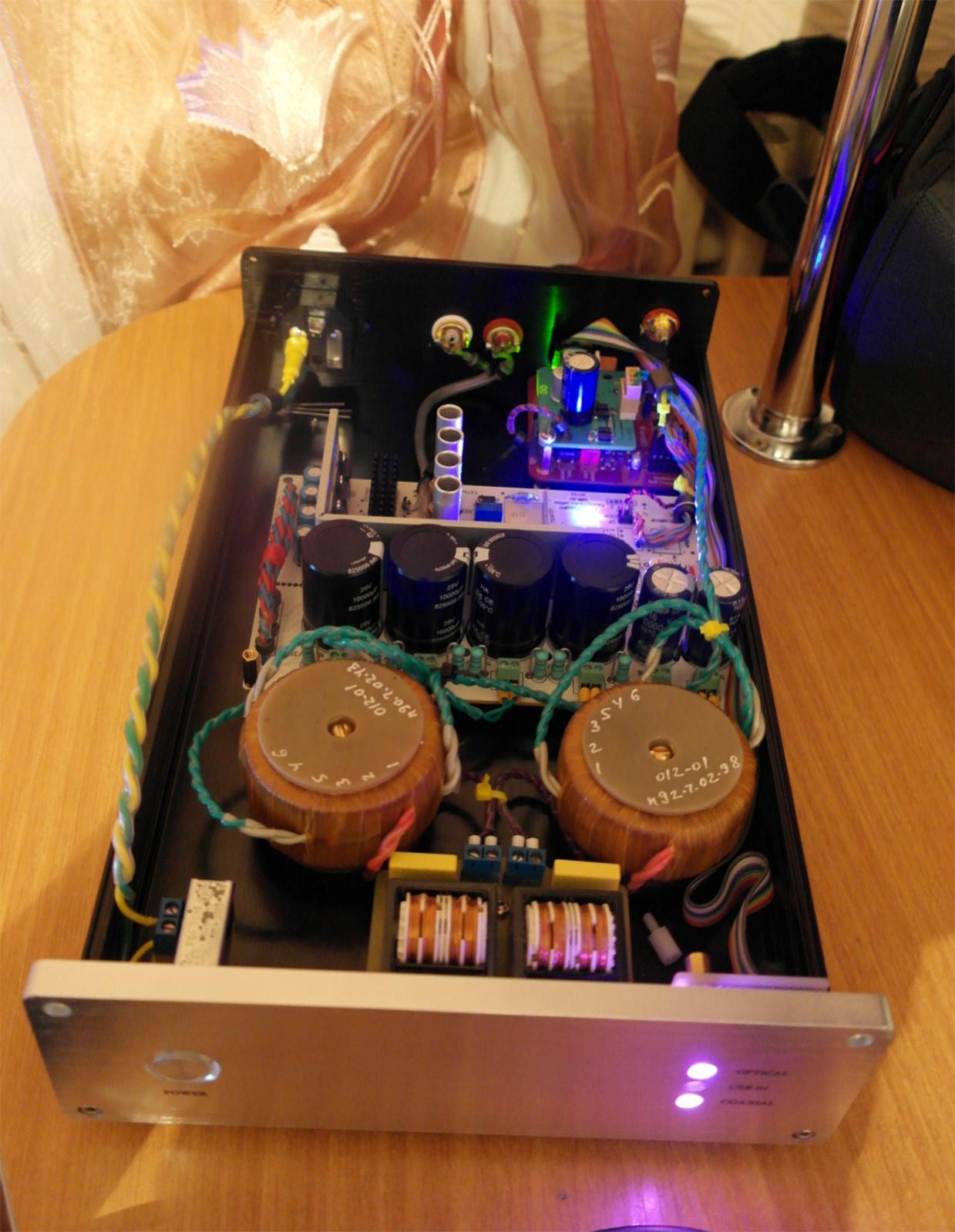

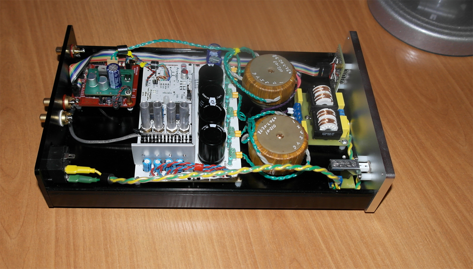

@ Klim: very nice project you have there! Can I post them on luckit.biz @ Gallery section?
L
L
@Lorien:Thanks! WaveIO- very good sound, stable device.
No problem about gallery.
