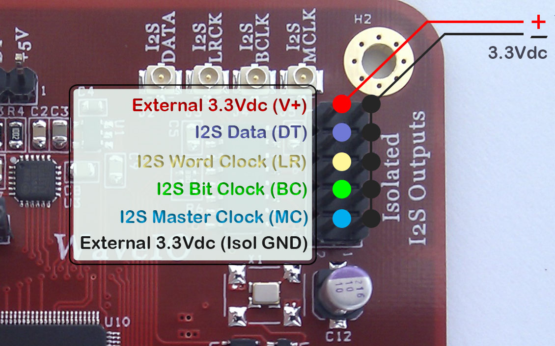

Though remember to power the BII side of the WaveIO with a 3.3V supply. Lucian should have provided pin out for the connector for you, follow his instructions for this connection. You cannot use the same supply for the isolated side of the isolator as the waveio, this will defeat the isolation!!
@sinski: check the attached picture. It might help you!
Hmm, the problem is, that i don't have 3.3V ps at the moment.
I will test what is happening, when i will connect WaveIO with isolated spdif output to BII. I have not so much time, on friday i am travelling to my parents for Christmass.

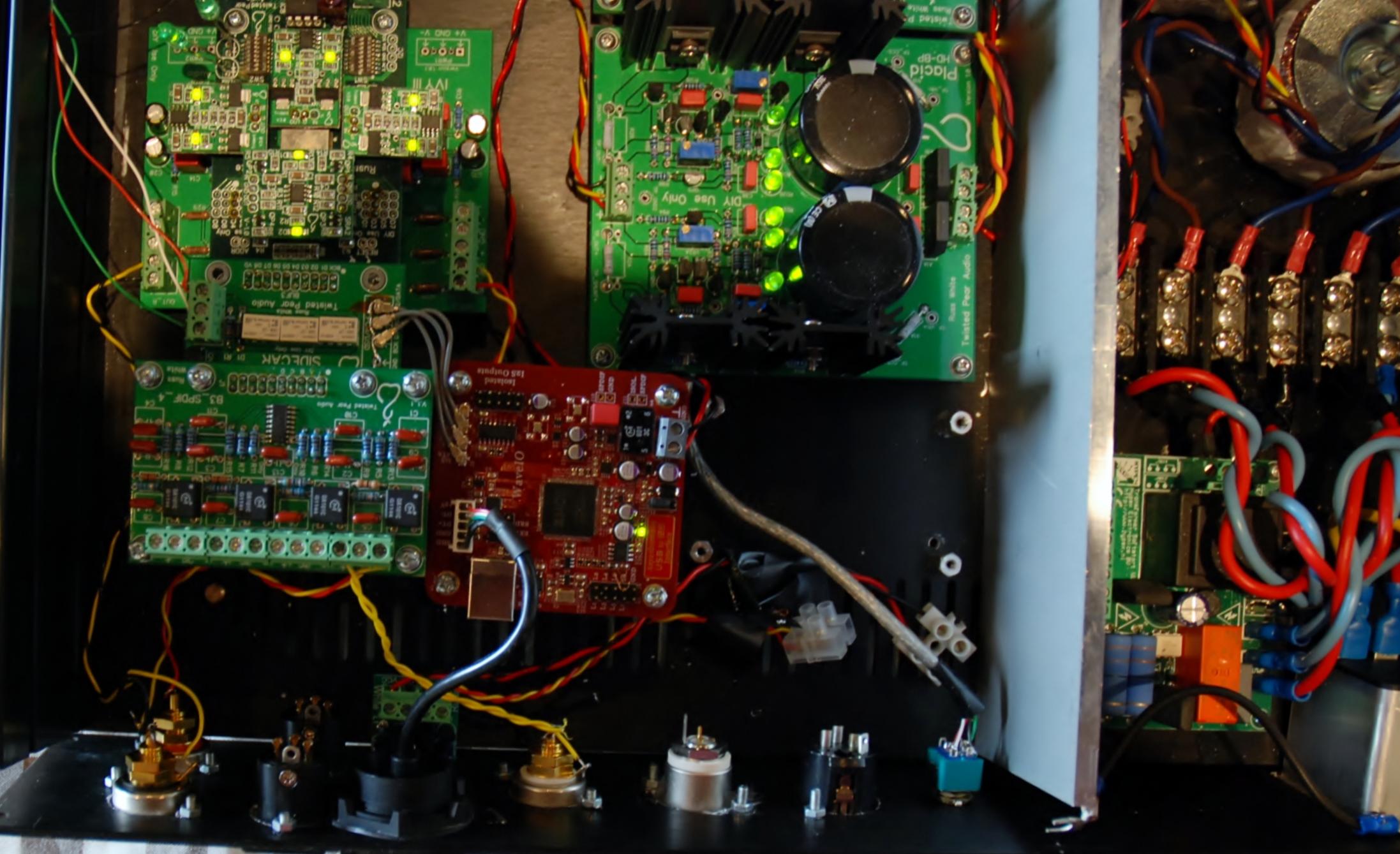

I don't think tere is any difference between internal and external USB connector. With J12 on waveio you can set power source - from usb or external.
The ufl cables are screened nearly to the end.
After i installed additional heatsink on Placid i tried up to 650mA, nothing helps.😡 😡 😡
I also checked what will happen if waveio is not getting enough power and tried lower values and going with Placid under 300mA just turned off waveio, there was no digital noise or something like that.
Is there any chance to get here some support from Lorien/Lucian ? 😕
I made my own USB cable without the 5V power wire, that's why i use external USB to avoid any kind of interference (i am aware of J12). I soldered ufl receptacles on sidecar in order to use the 5 cm factory made cables and better isolation. Just make sense to me.
Could you post a pic of soldered u.fl receptacles on Sidecar? where did you bought the u.fl receptacles?
Sure, available at Mouser
U.FL-R-SMT-1(10) Hirose Connector | Mouser
Sorry about bad quality picture
